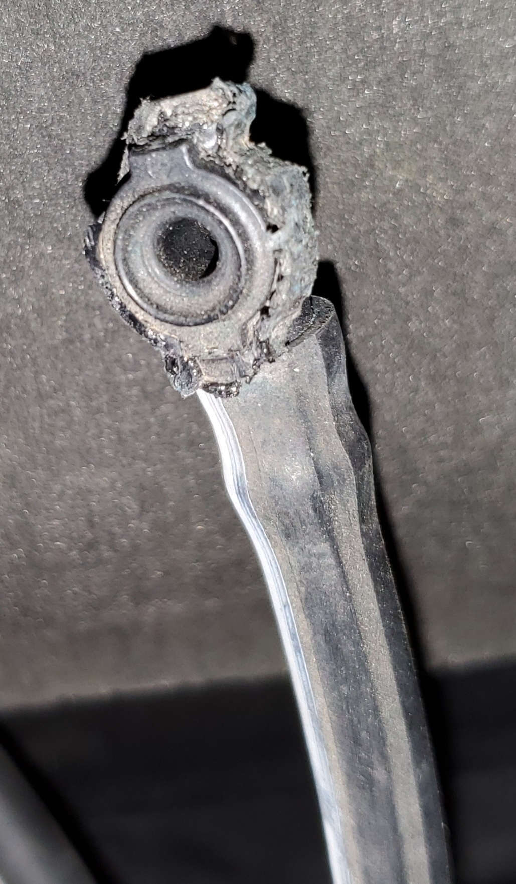

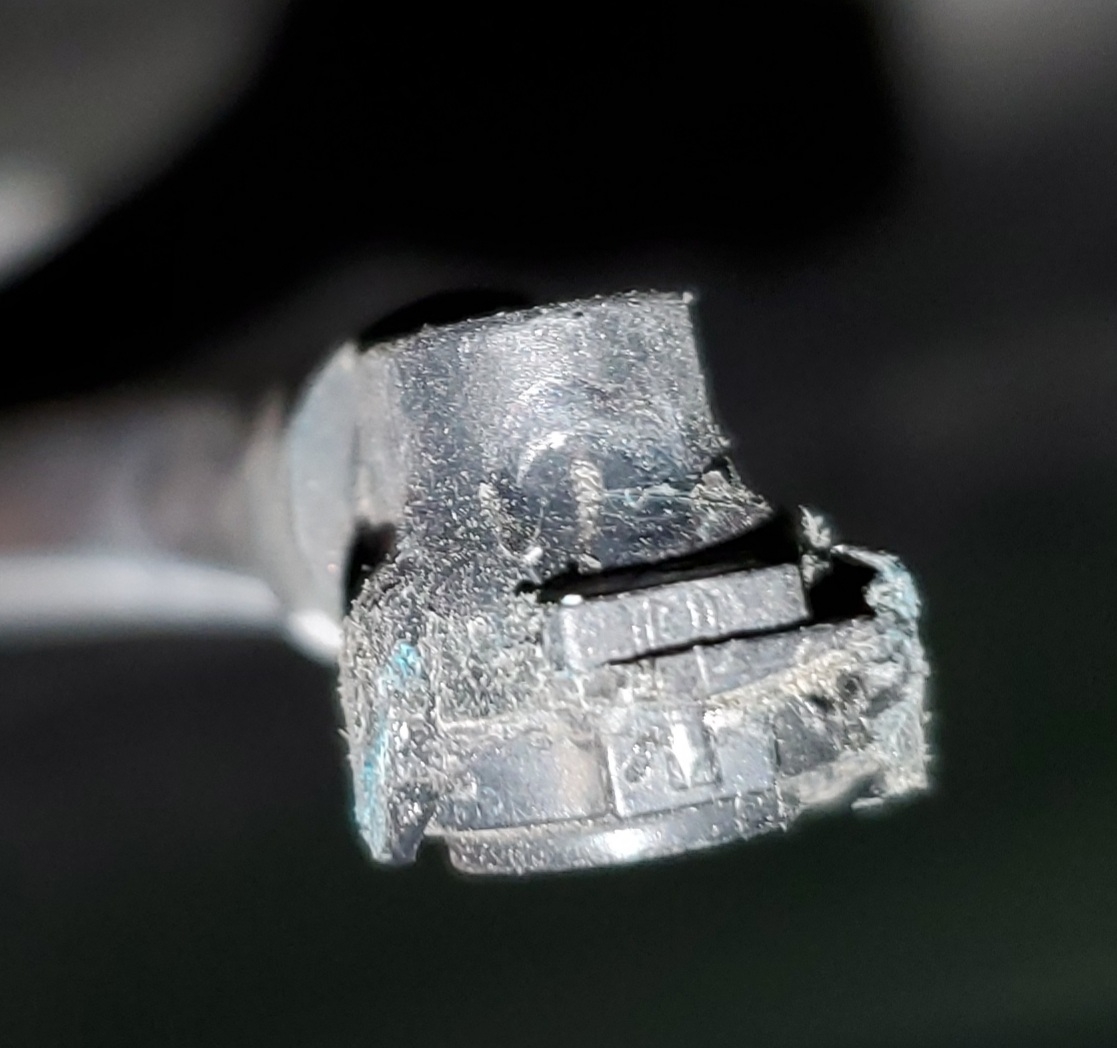

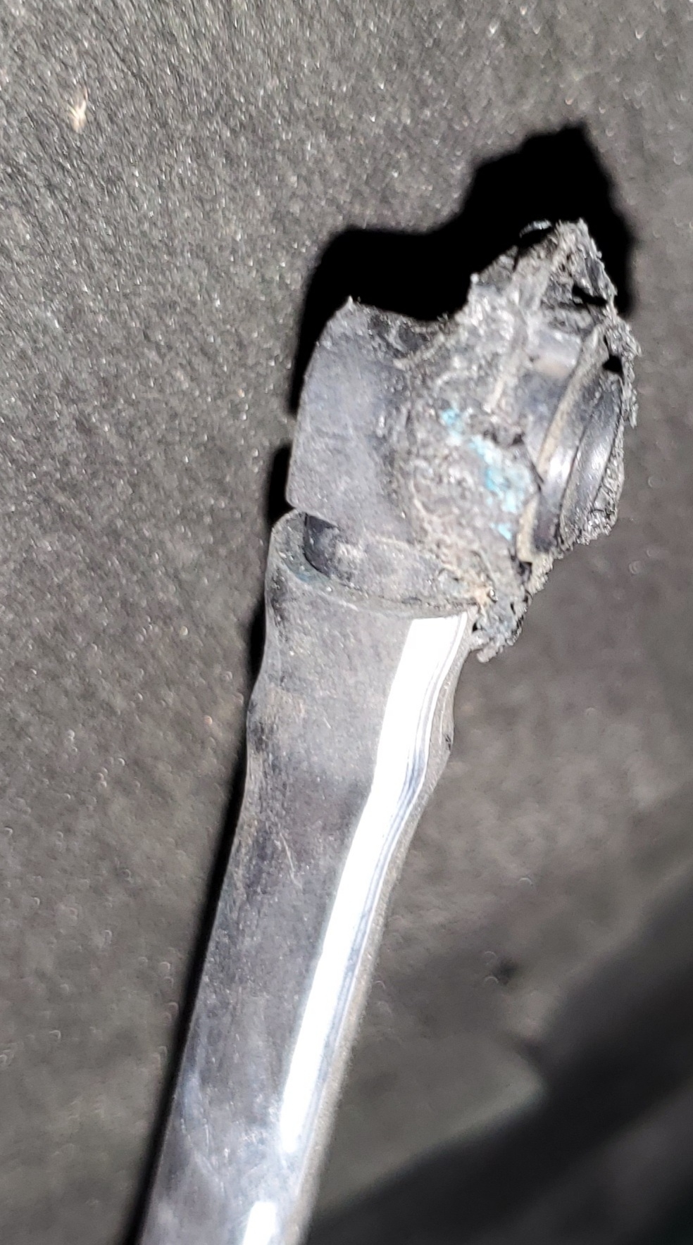

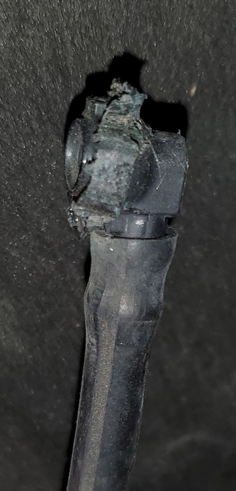

I just purchased the hood button for my vehicle after noticing the other day it was missing from the hood. As I opened the hood to connect the wire, this is what I saw as illustrated in the pictures below.
Did this DIY become a professional problem?

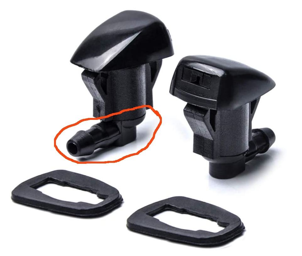

That looks like the hose connection for the nozzle. The plastic piece should pull out of the hose with a bit of effort and then the hose connects to the new nozzle after you have snapped it into the hoods mounting hole. The piece you have in the hose it what is circled on the picture. Be sure to put the gasket on the nozzle before you install it, without it the nozzle will be very loose and flop around.
Feb 13, 2021 at 11:59 PM
PCULQUI
  • 354 POSTS
It worked perfectly. Thank You for all your help. I really thought it was going a bigger problem than it was.Thank you so much again.
