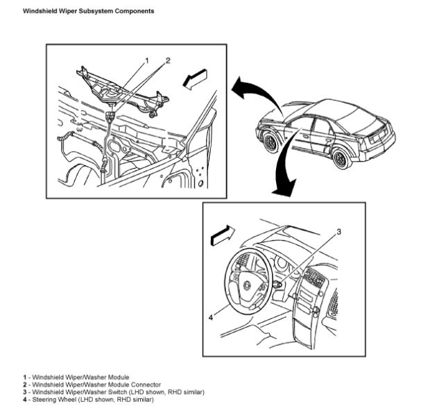

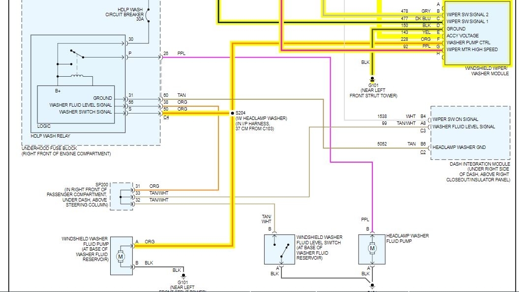

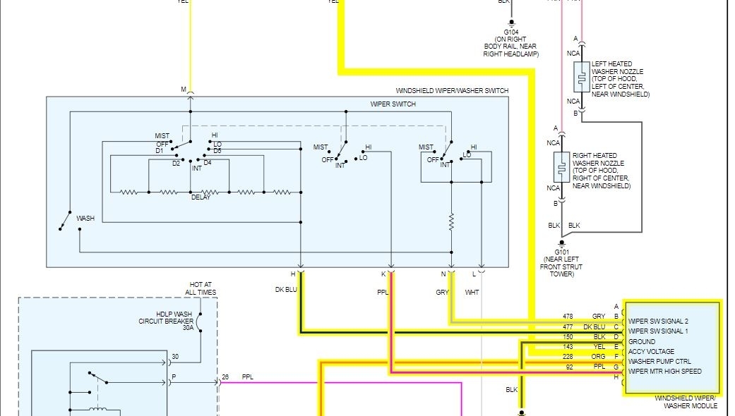

Wipers work but sprayer want turn off.

Good afternoon,
The washer control module is the most common failure for this.
https://www.2carpros.com/articles/how-to-replace-a-windshield-washer-pump
I attached the wiring diagram for you as well as the location of the module.
Let me know when you have a test light or voltmeter so we can do some testing.
