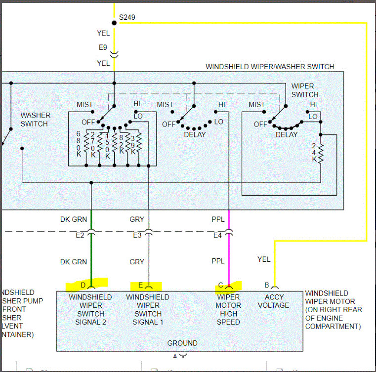

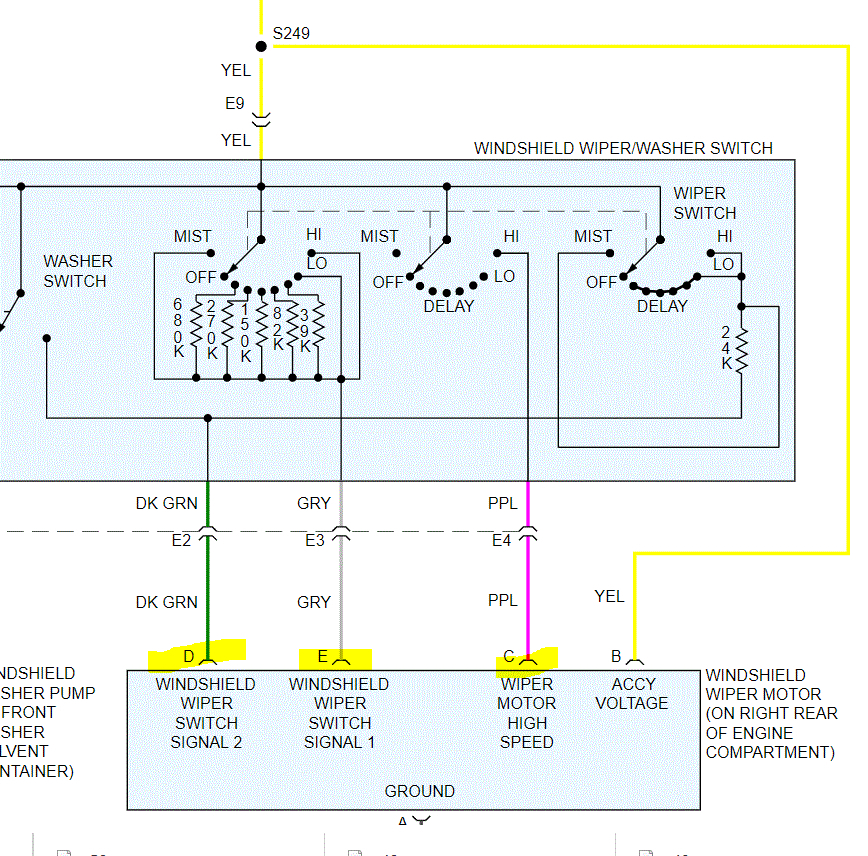

I attached a pic below for testing. I highlighted three wires. The dark green wire should have power when you select the delayed setting. The gray will have power at low speed and the purple will have power at high speed.
Use a test light to see if there is power to the motor.
Let me know what you find.

I tested voltage at three state of multiple sensor switch (wheel switch), at 1. Misk 2. Low 3. High
I detected two terminal go to fluid motor, dark green and grey; and three terminal go to windshield motor.
1. Misk position:
Dark green 0
Gray. 0
Purple. 0
Yellow 10.45v
Black. 12.14
Low position:
2. Dark green 10.39v
3. Gray. 1.30 v
4. Purple. 0
5. Yellow 10.45v
6. Black. 12.14
High position
Dark green 10.37v
Gray. 1.30v
Purple. 10.38v
Yellow. 12.14v
Black. 12.03v
So. Fluid motor works in both low and high position.
Voltage on windshield motor at low and high position have similar voltage distribution, looks not normal? Should be different?
Low position switch problem or high position and low position change switch or motor bad?
Thanks for your review and help!

The voltage should change based on switch position. When you have it in the delayed position, you will only see power intermittently. On high, it should have battery voltage. On low, it should be lower than high. Regardless, if the light is remaining the same brightness regardless if it is high or low, it sounds like the switch is bad. That would explain why it is running on high regardless of the position.

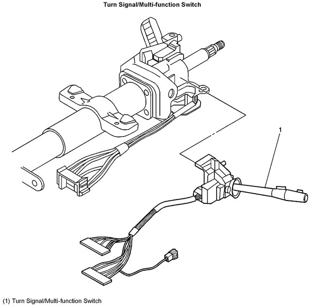

The only other thing I can think of would be to remove the switch and inspect it for wiring damage. Something is causing the equal voltage to reach the motor regardless of the selected speed. Somewhere there must be a short.

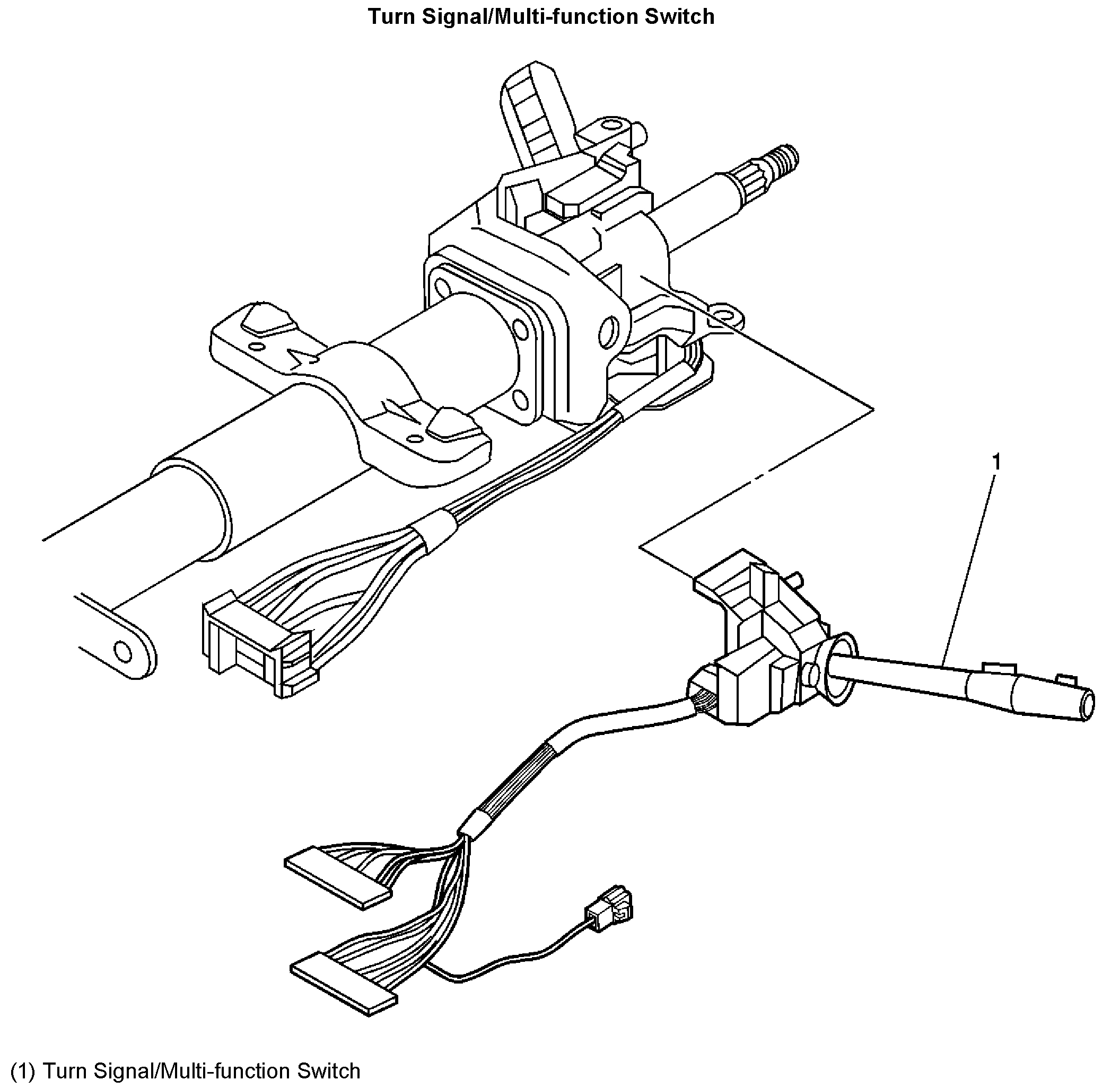

I attached a pic of the multi-function switch below. The best thing we can do at this point is to first, reconfirm there is no damage to the wiring at the motor (including connector) and check for the same at the switch.

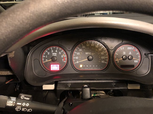

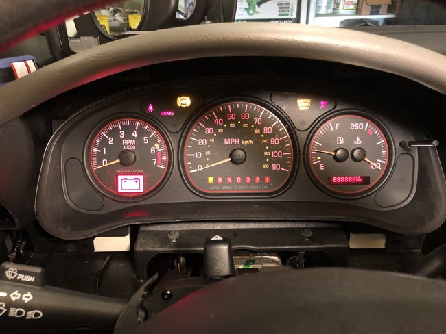

After disconnect negative battery terminal, I replaced old multiple functional switch with new 1A Auto part, but it does not fix problem, the windshield motor only worked on High switch position, but did not work on the low positions as seen on the old switch. What is the possible reason for the fact?
And after replacement, when I connecting negative battery terminal, the head lights turned on and chiming sounded without insert engine key. And after insert engine key, at ACC position, only Battery and P light turned on at dashboard (first image). It is looks abnormal before more lights turned on. When put engine on position there were many lights turned on (second image). What was the possible error occurred for the abnormality?
Thanks for your instruction and help!
Dec 20, 2020 at 8:55 PM
  • 110,194 POSTS
The second pic indicates the engine isn't running yet. Those lights should turn on for a few seconds when the key is turned to the run position (engine off). The first pic is another story. Were any of the wires damaged or pinched in the steering column?

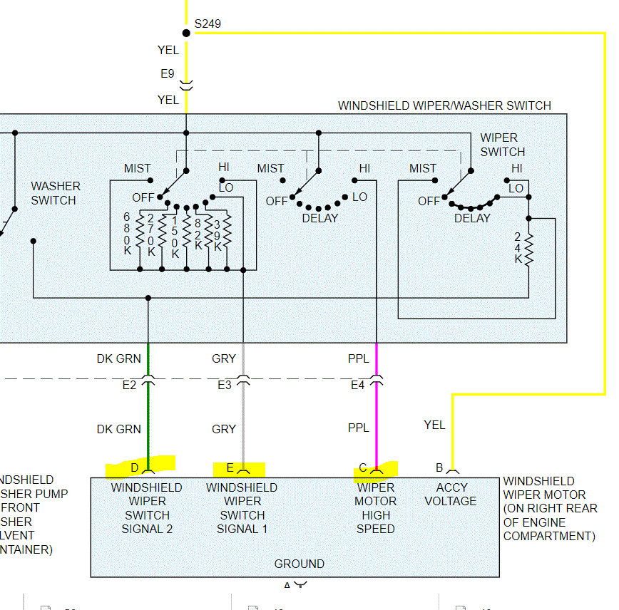

As far as the wiper, it sounds like the purple wire in the attached pic is getting power all the time when the wipers are turned on, regardless of selection. Confirm that for me.
It has to be getting power at all times if it works on any selection. If not, check for power to the dark green wire on delay and to the gray wire on low speed. These are the only ones that should have power in the selected positions.

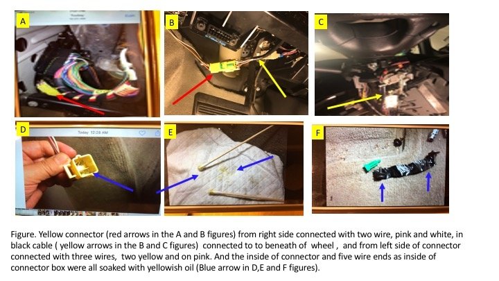

And I found a two wires, white and connected with three wires through one Yellow connector where five wire ends and inside of connector were all soaked with yellow-green oil in side of connector. That was absolutely can cause short circuit. I do not know the soaked yellow oil's function, and if it was originally installed or not if that already caused shortage of circuit some where or not. (Detail Figures attached). And I disconnected the connector and removed oil with cotton steak and rinsed with 70% isopropanol after disconnect negative battery terminal, and naturally dried overnight. But after cleaning there was no anything changed when I tested windshield motor with engine on but not start, that only run windshield motor on High speed switch position and not run on low speed position. If this circuit directly influence windshield wiper motor circuit?
Dec 21, 2020 at 12:24 PM
  • 110,194 POSTS
As far as the oily substance, it is likely dielectric grease. That is used to prevent corrosion and improve connectivity.
As far as a short, the problem may have existed prior to the switch being replaced. Did you check for power as I mentioned above? Each of the wires I indicated should only have power in the selected switch position selected. If the purple wire is getting power at all speeds, it will cause the motor to run on high at all times.

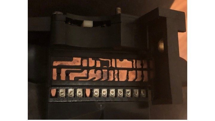

On old switch I found black grease like substances covered on the switch metal connector ( image attached) this image was taken after I wiped off oils.

As far as the lights, there has to be a short to ground for them to get power. Now, the interesting thing with the wiper is you only have power through the ground. That could be the cause of the lights you mentioned. Also, it is likely causing the problem with the wiper.
Are you able to trace the ground (black wire) to see if there is anywhere it is making contact with a power source?
