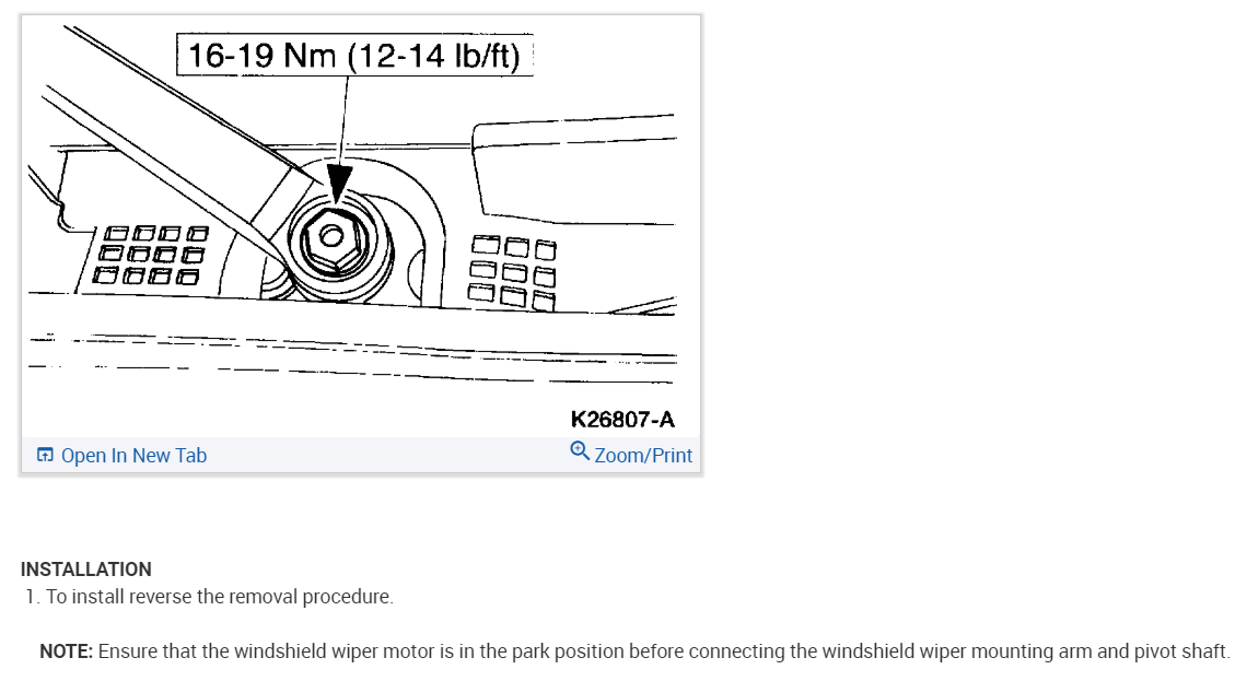

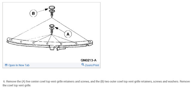

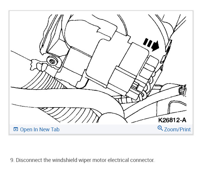

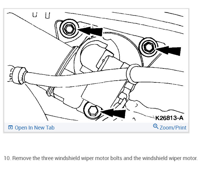

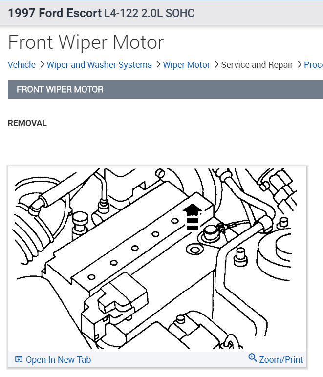

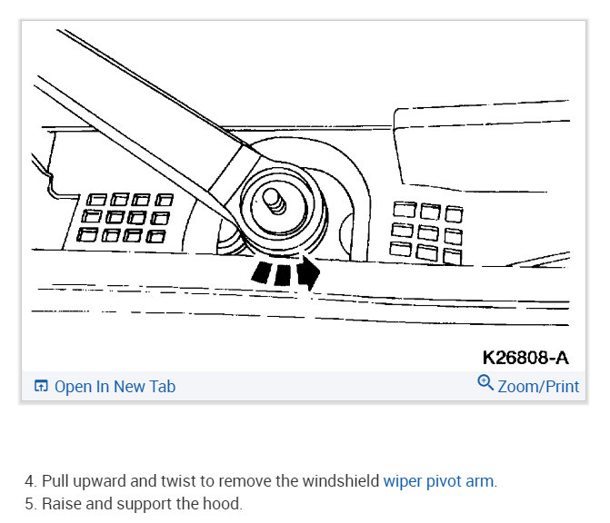

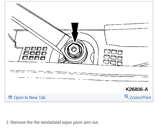

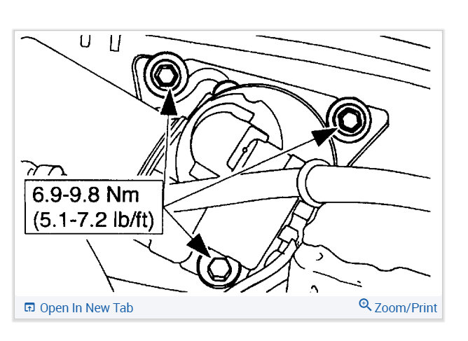

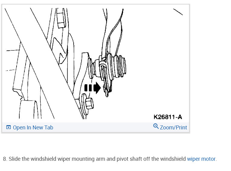

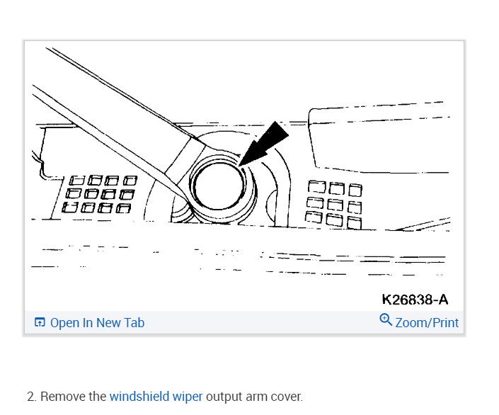

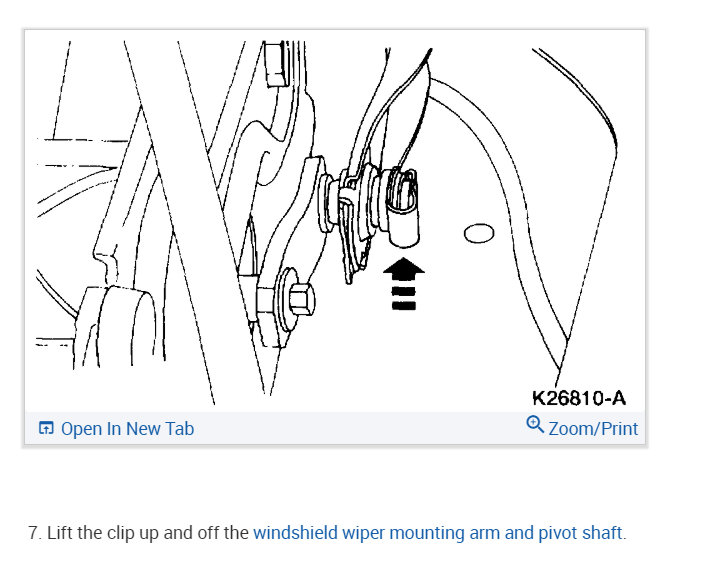

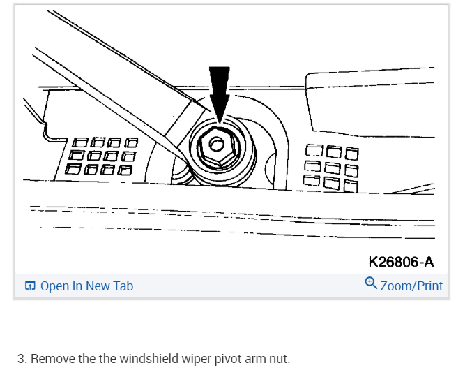

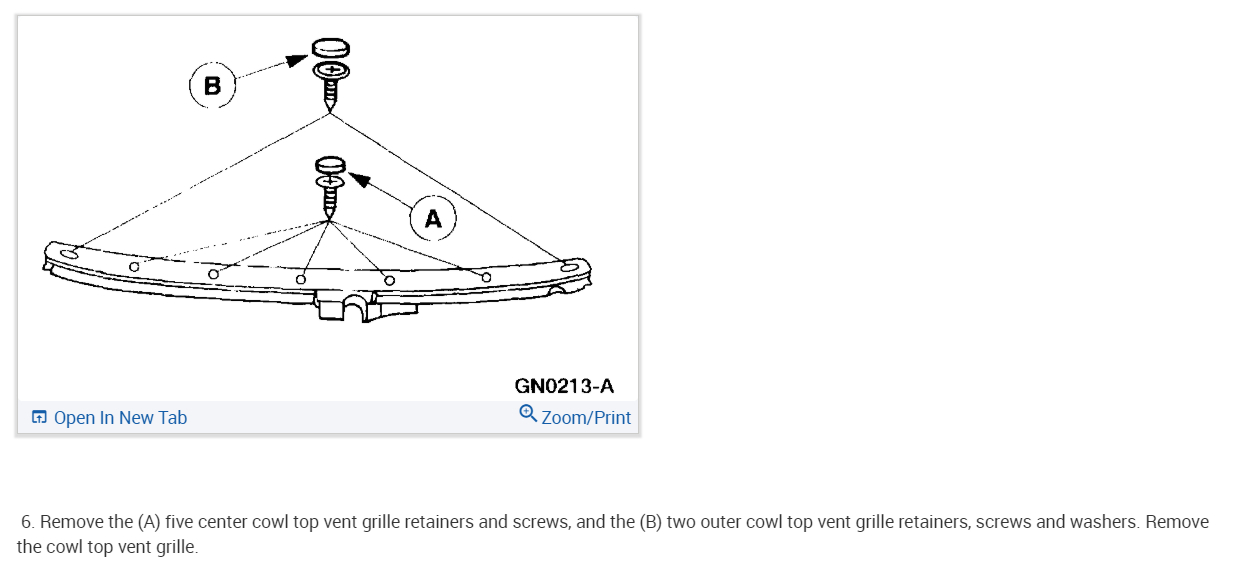

I have a problem with the control of the wiper motor. It stays on even if the lever is in off position
Jan 27, 2019 at 12:25 AM
  • 55,785 POSTS
There is a wiper motor relay that sound like it is stuck on here are diagrams to help you change the wiper motor out. Check out the diagrams (Below). Please let us know what happens.
Jan 28, 2019 at 10:45 AM
ROELF
I have changed the wiper motor but need to find the relay.

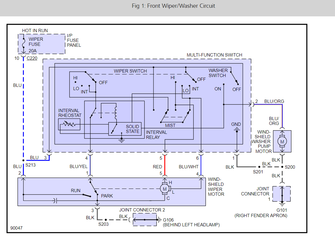

Jan 30, 2019 at 1:05 AM

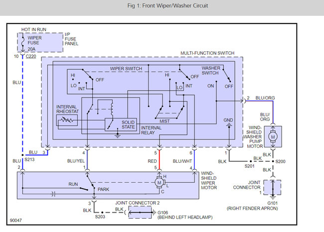

  • 55,785 POSTS
The relay is inside the wiper motor. here is a wiper wiring diagram so you can see how the system works. Do the wipers still not shut off?
