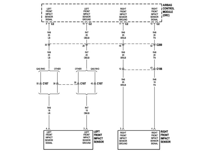

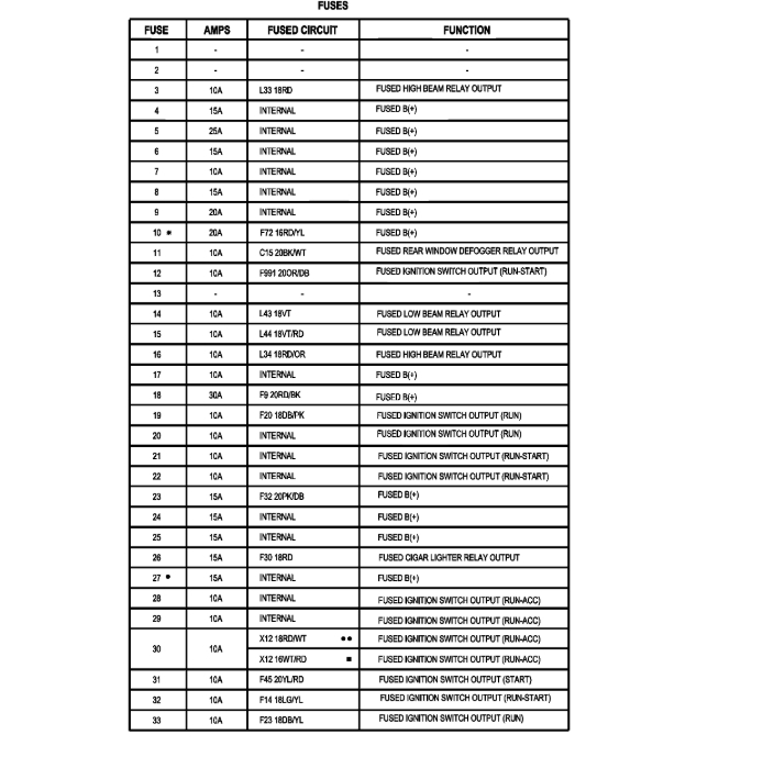

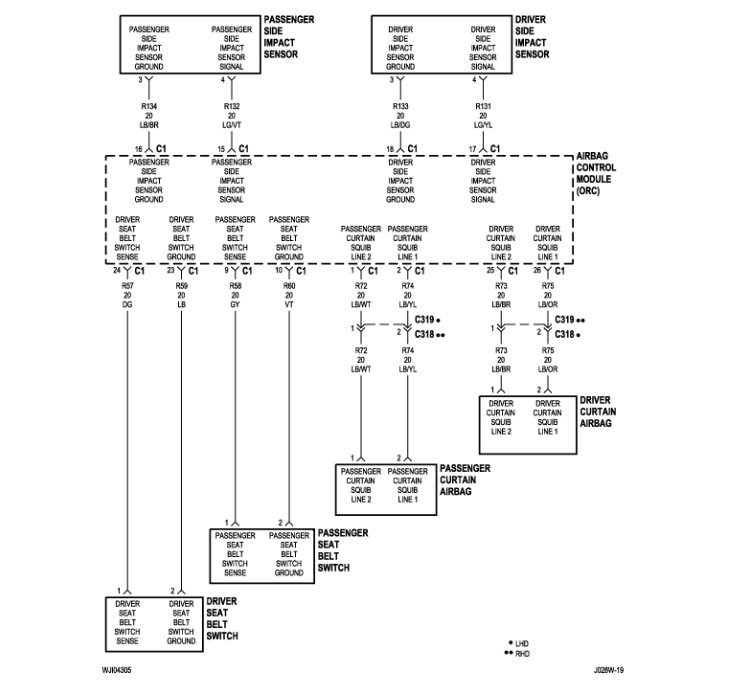

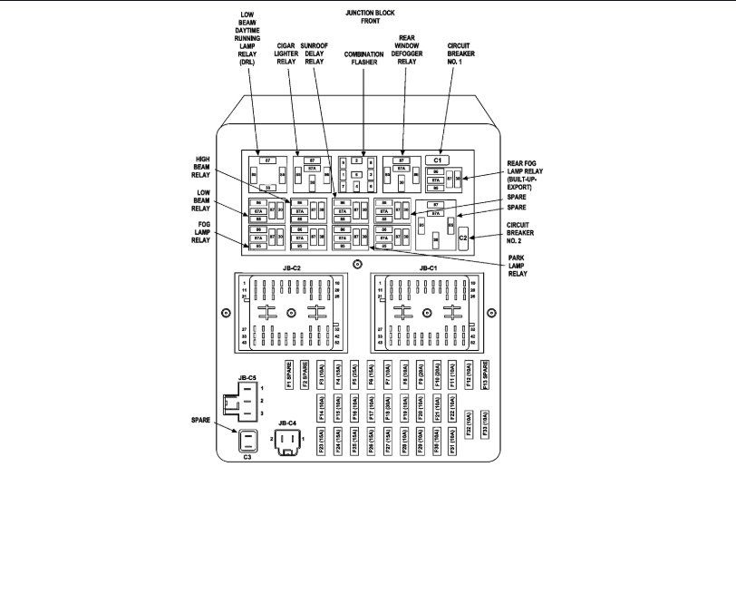

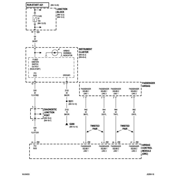

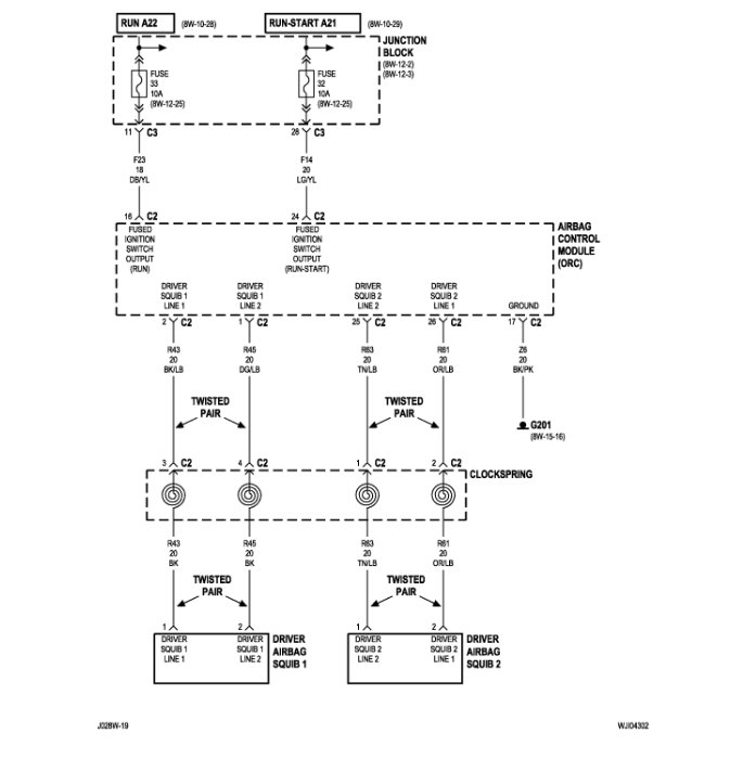

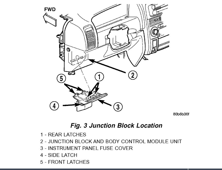

The air bag light and no seat belt light stay on and inside lights won't turn off. what is the issue?
Feb 11, 2020 at 9:53 PM
TOUGHDIVER
✓ASE Certified Mechanic
226 POSTS
It could be the clock spring or blown fuse. I'm attaching fuse block views, wiring diagrams, schematics and check out the repair guides below. let us know if this information is helpful or if you need more info.
