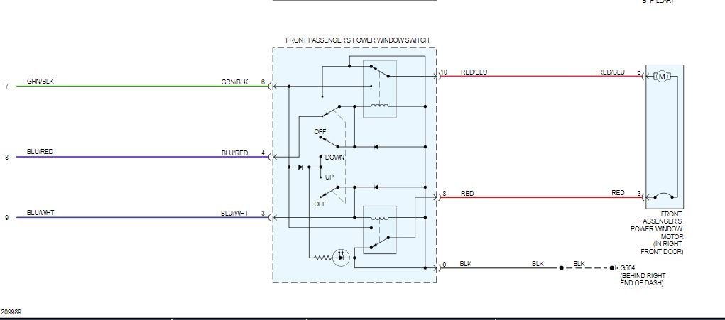

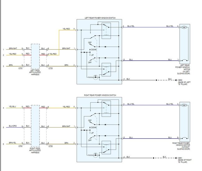

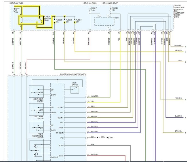

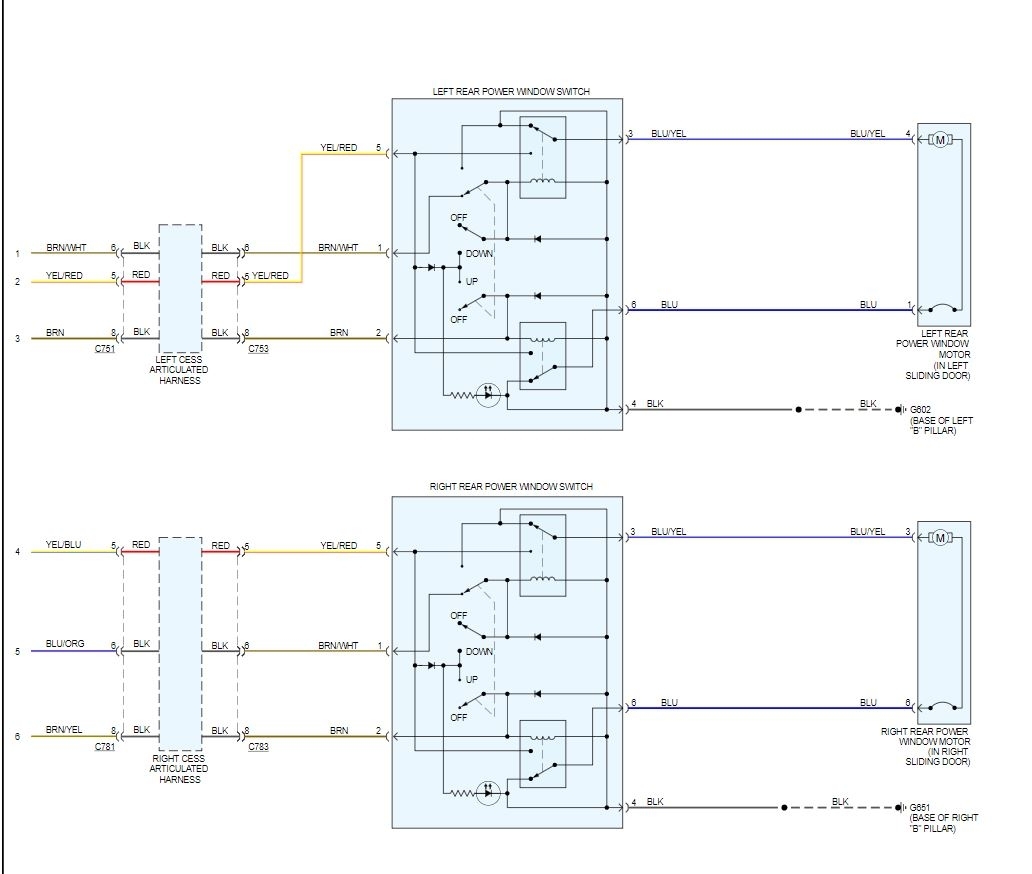

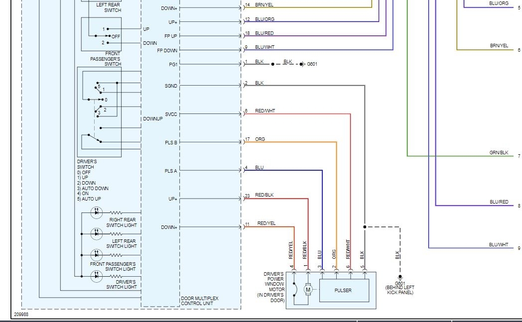

I attached a wiring diagram of the windows for you. There is a relay that controls power to the windows. I would check the voltage at the relay to see if it is powering the fuses.

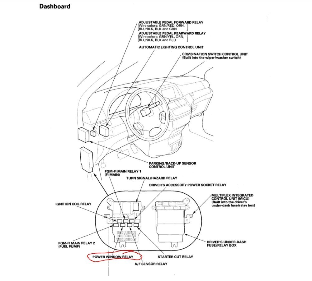

I also attached a picture of the location of the power window relay.

All fuses are good. changed the relay. Windows still won't work.
Apr 5, 2021 at 5:47 AM
Okay, can you check for power to the relay with the key on?
Apr 5, 2021 at 6:08 AM
MYCHEF54
How should I do that?
Apr 5, 2021 at 6:33 AM
You need to remove the relay and use a voltmeter to test for power.
I attached the guides in a previous post for using a voltmeter and checking a relay.
