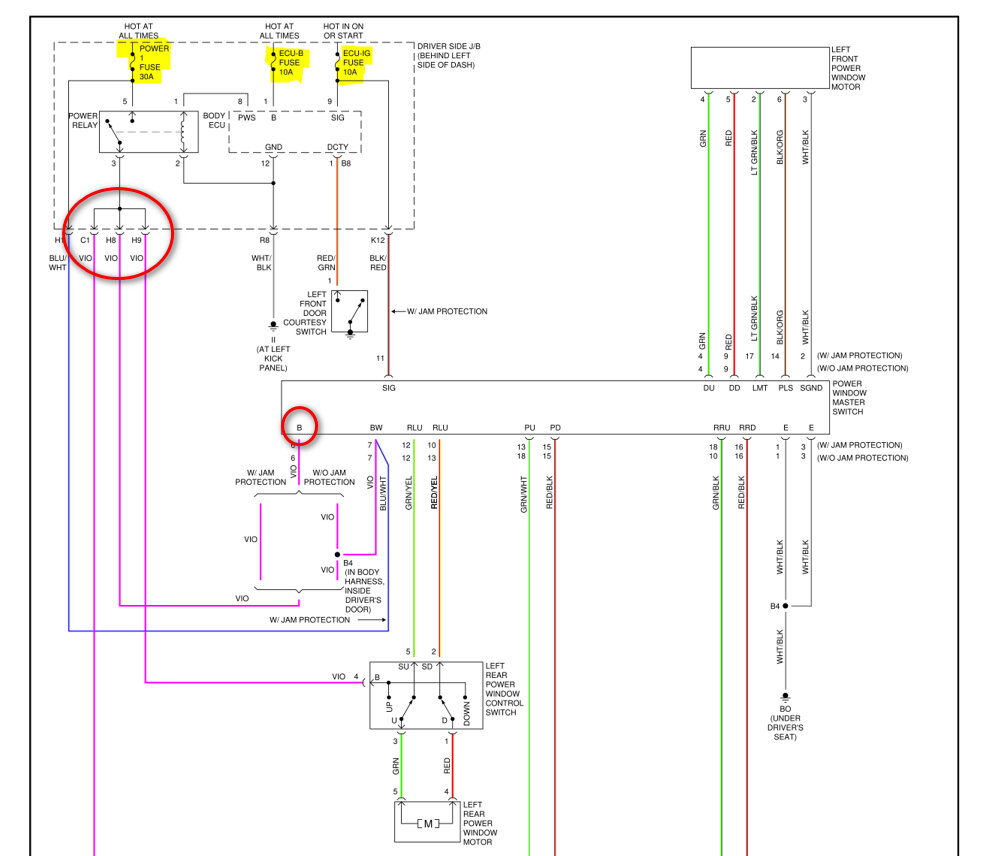

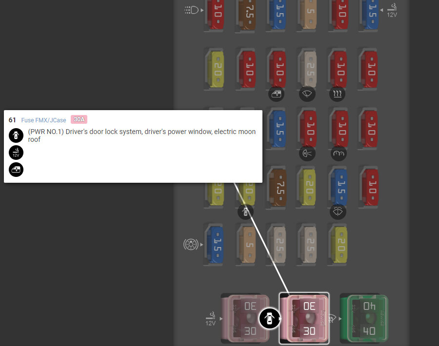

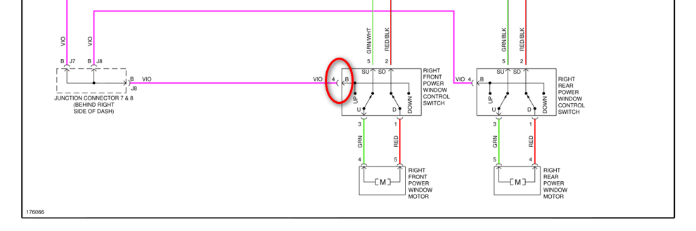

I would suggest to check for 12V power supply from driver side JB(junction box) on violet wire to pin B at either window switch.
Also check fuses Power 1 fuse(30A), ECU-B fuse(10A) and ECU-IG(10A).
The diagrams below show 4 electric windows.
The 3rd diagram shows location of the Power 1 fuse.

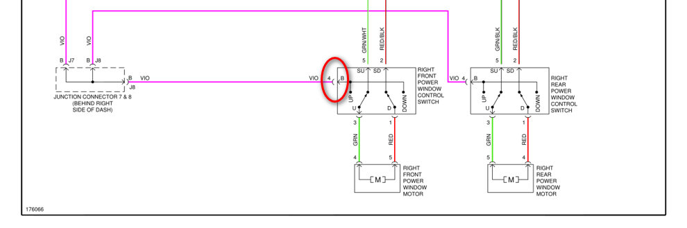

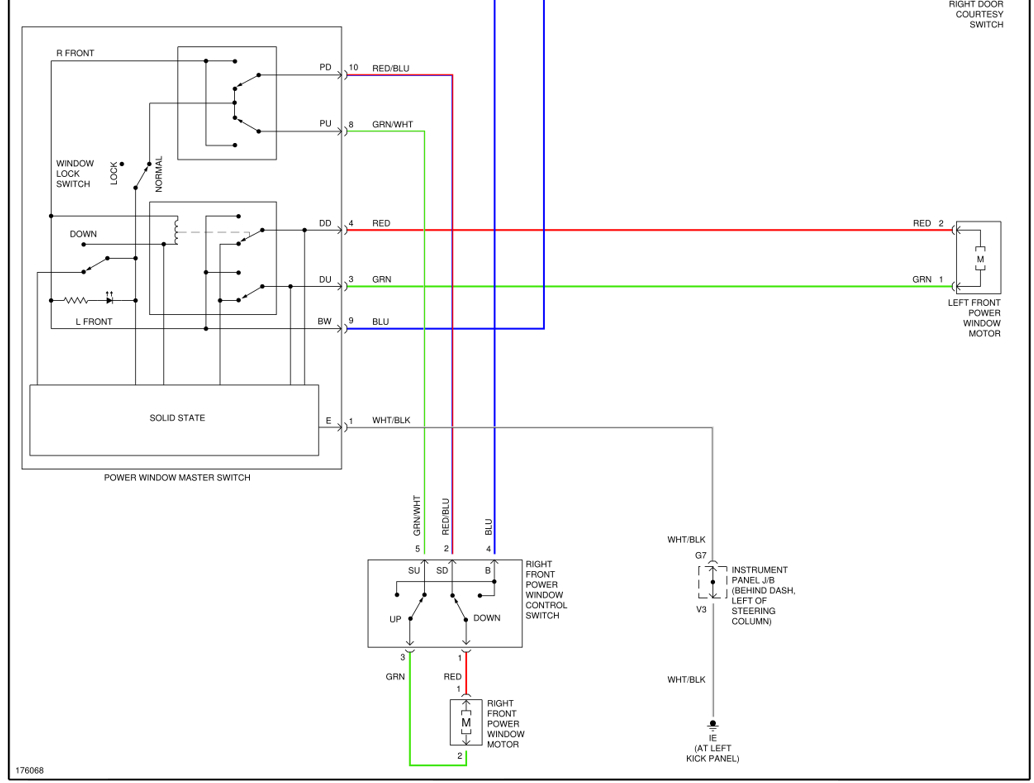

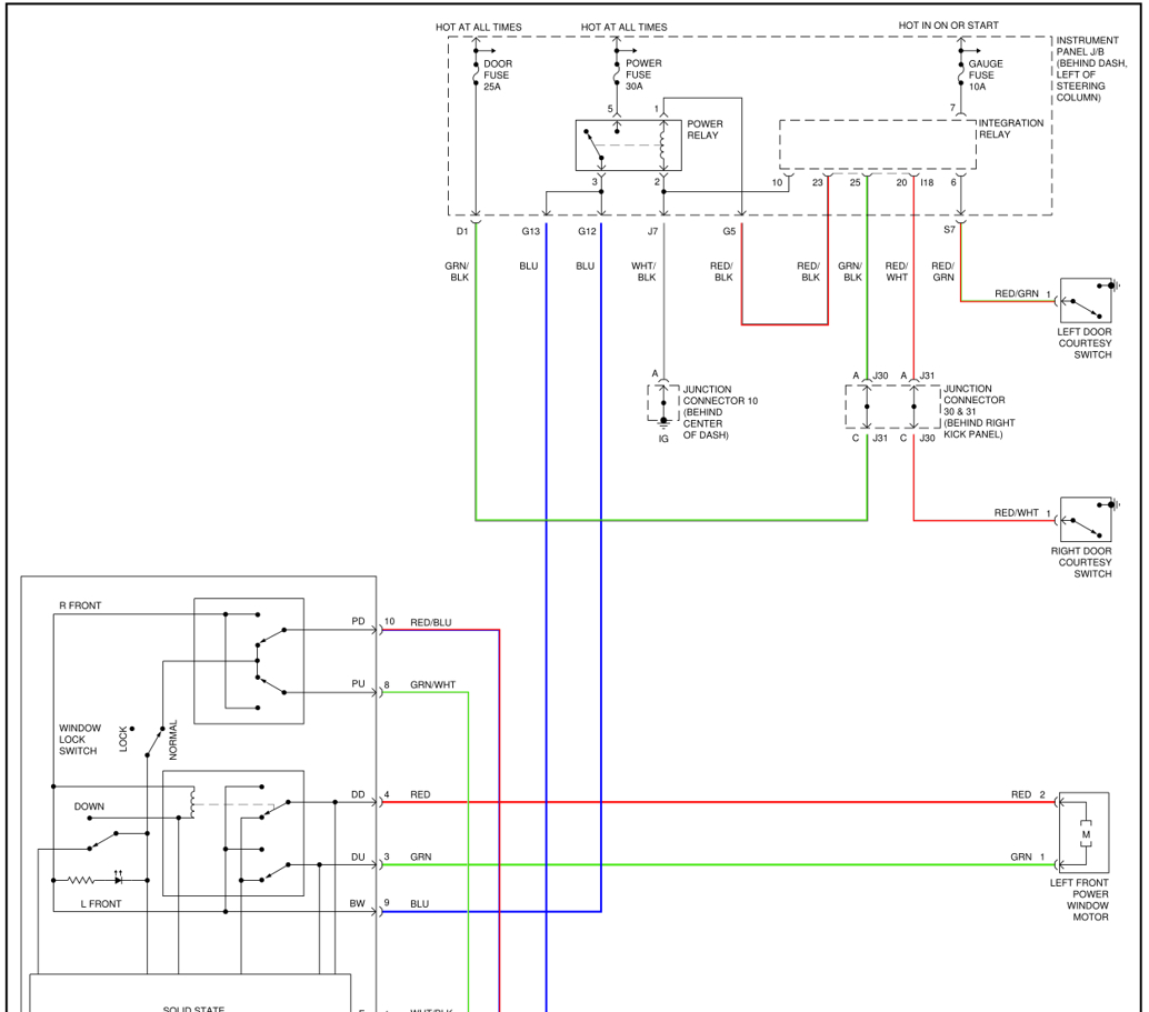

The correct diagram is below, check the 12V supply on blue wire to pin 9 at the driver side master switch and pin 4 at the passenger side switch.
Cheers, Boris
Jun 3, 2024 at 4:34 AM
BHAMDOC1973
  • 2,007 POSTS
Pin 9 has power.
Jun 3, 2024 at 7:27 AM
BHAMDOC1973
  • 2,007 POSTS
4 also has power on passenger.

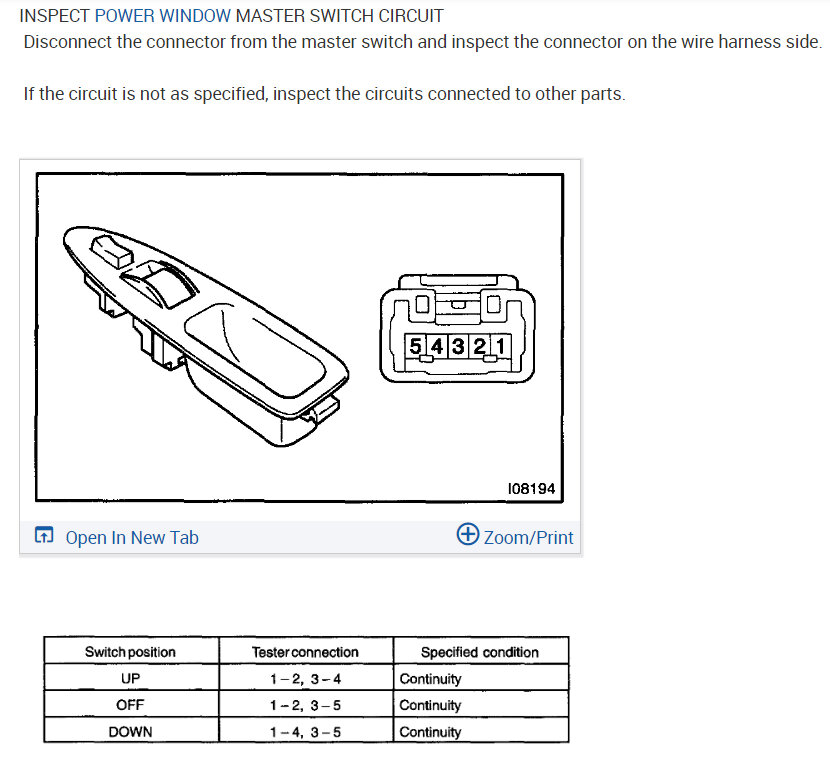

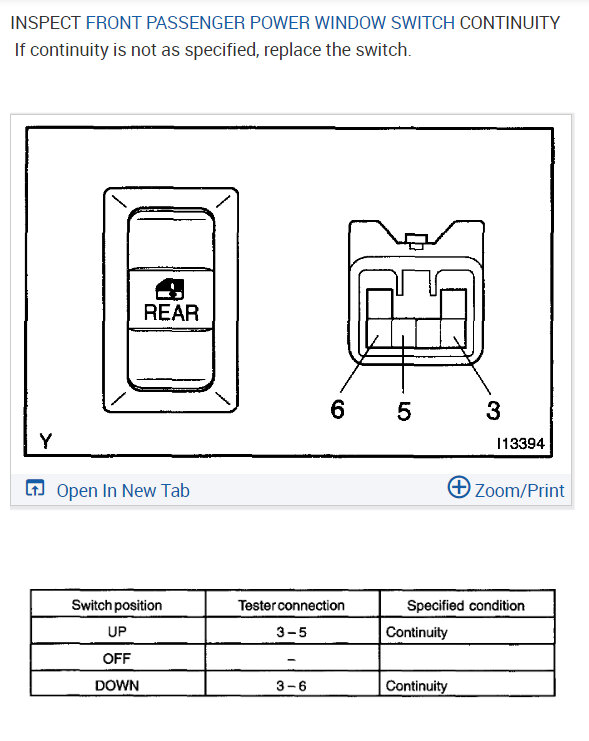

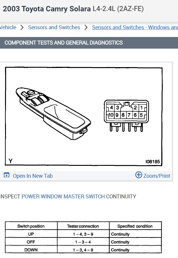

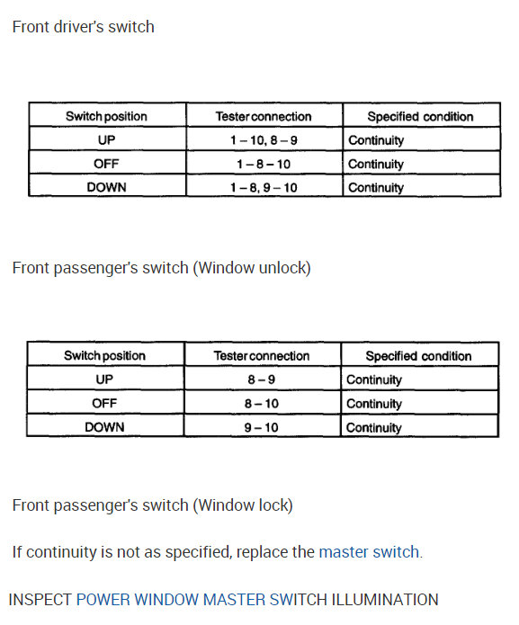

Okay, I have seen the master window switch go bad on this cars, here is how to change it out. Here is how to test it to confirm. Check out the images (below). Please let us know what happens.
Jun 5, 2024 at 4:40 PM
BHAMDOC1973
  • 2,007 POSTS
Oh, i replaced before i even found the solution. Mind as well. Thanks
