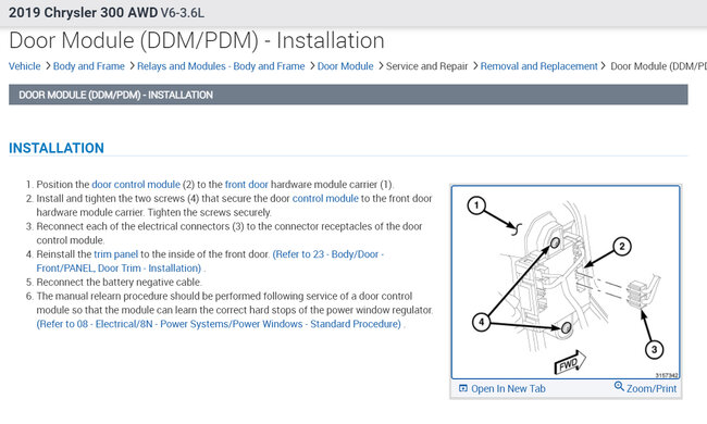

I purchased a new master switch in hopes that it would fix my problem but unfortunately it didn’t. My rear windows are the only thing that the master switch on the driver door will work. The locks, mirrors, and front windows will not work from the switch. I’ve checked fuses and wires. Just confused on what’s going on.

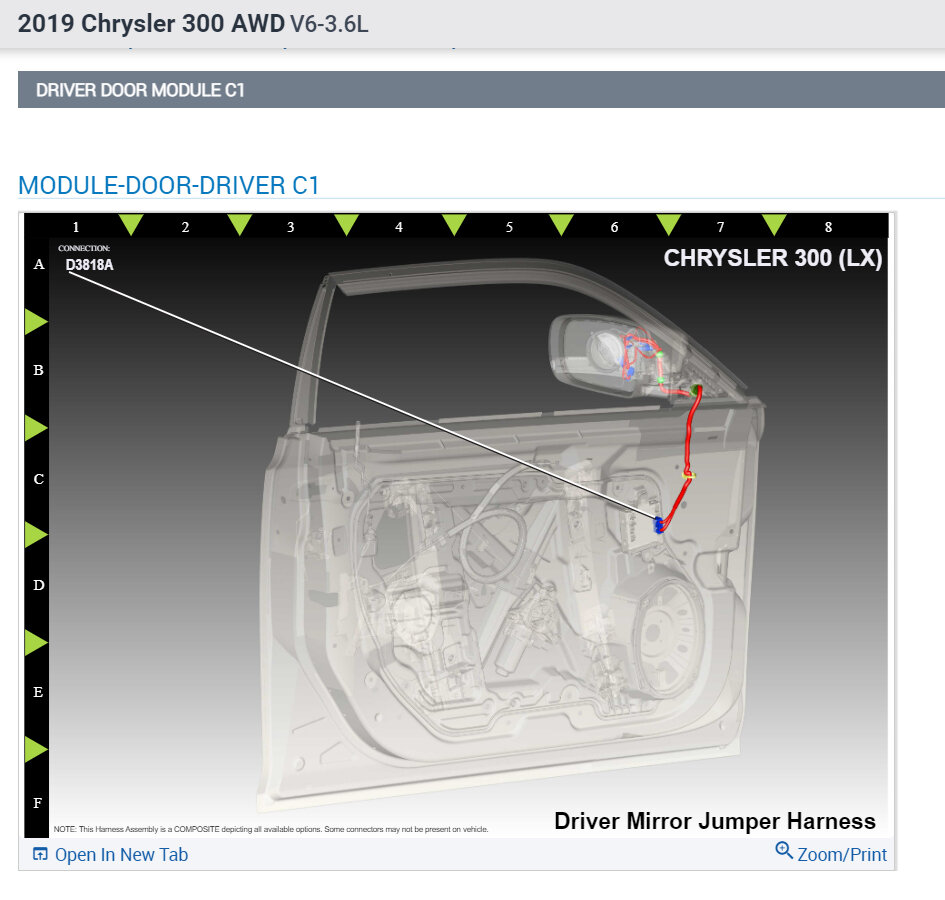

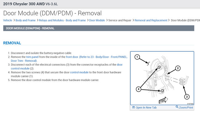

First, I would check fuses # 64 circuit breaker, #11 and # 10 in the rear fuse panel, if they are good the driver's door module has gone out and needs replacement. Here is the location and how to replace it in the images below. Please let us know if you need anything else to get the problem fixed.
