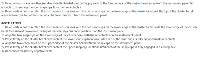

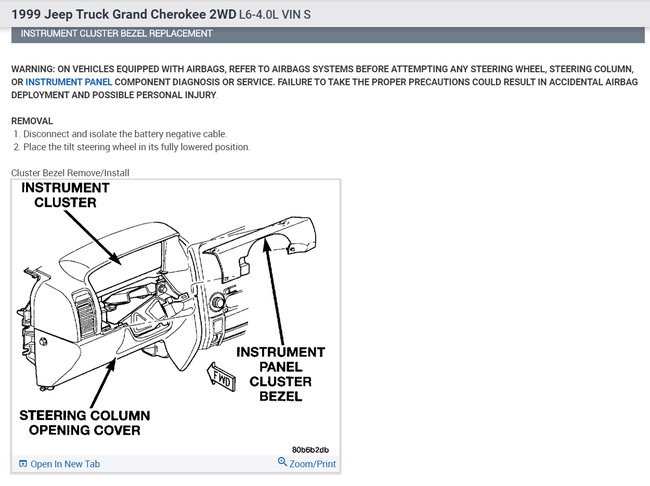

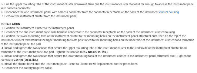

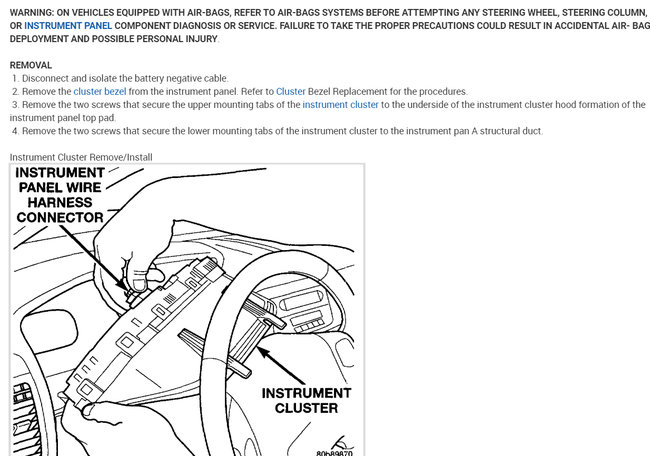

This is common when the cluster goes out. here is a video of the job being done in a similar car with diagrams below to show you how on your car. If you get a rebuilt unit give them your VIN and currant mileage.
https://youtu.be/_HEC44xENxw
Can you please shoot a quick video with your phone so we can see what's going on, that would be great. You can upload it here with your response. Check out the diagrams (below). Please let us know what happens.
