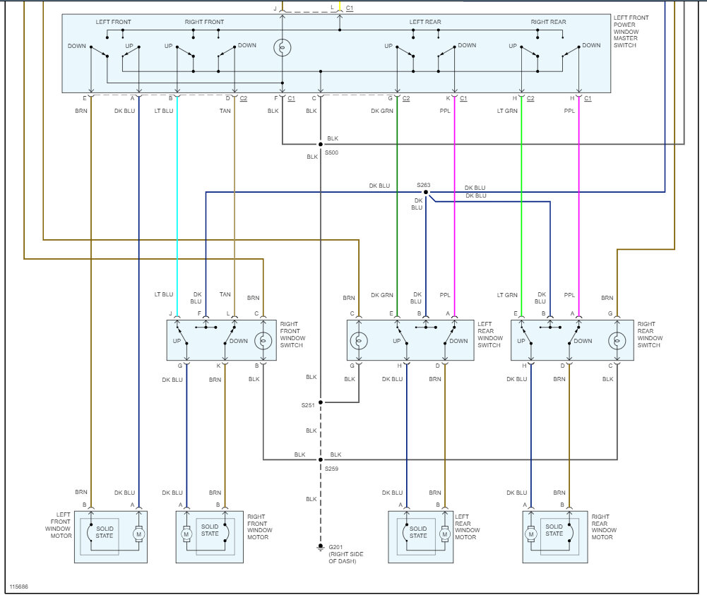

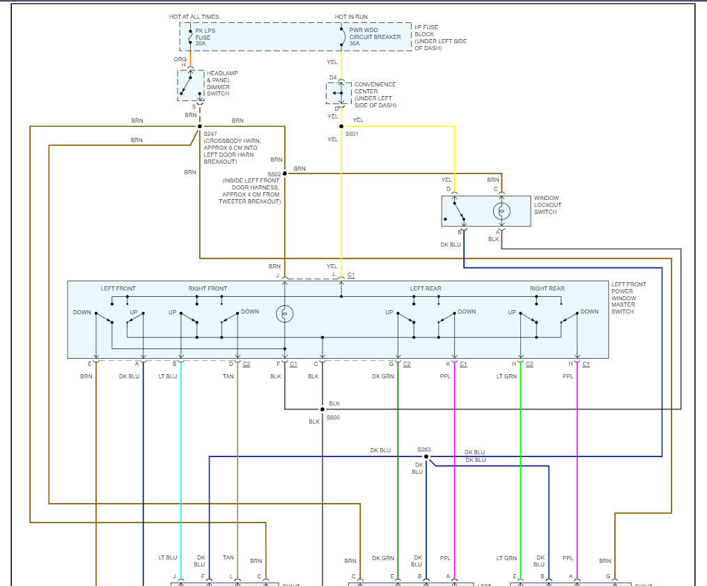

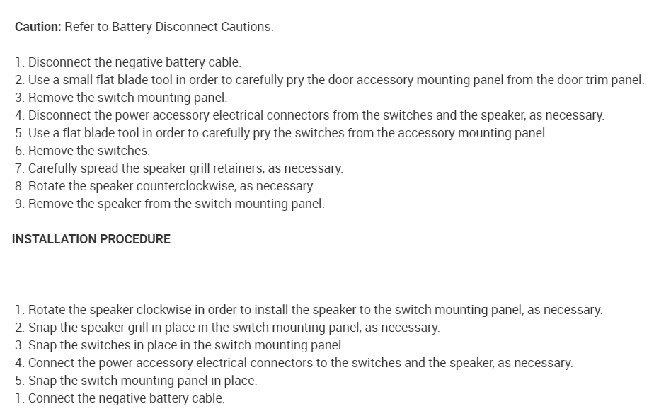

Windows don't work, I hear click under dash when pressing child lock button.
Sep 4, 2023 at 9:32 PM
  • 55,456 POSTS

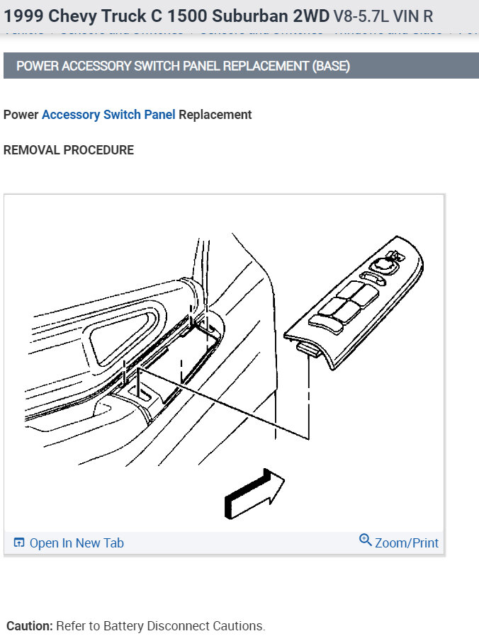

It sounds like the main switch went out. But we should check the PWR WDO circuit breaker, this guide can help:
If the circuit breaker is okay here is how to change the main switch out and I have included the window system wiring diagrams so you can see how the system works.
Check out the images (below). Please let us know how it goes.
