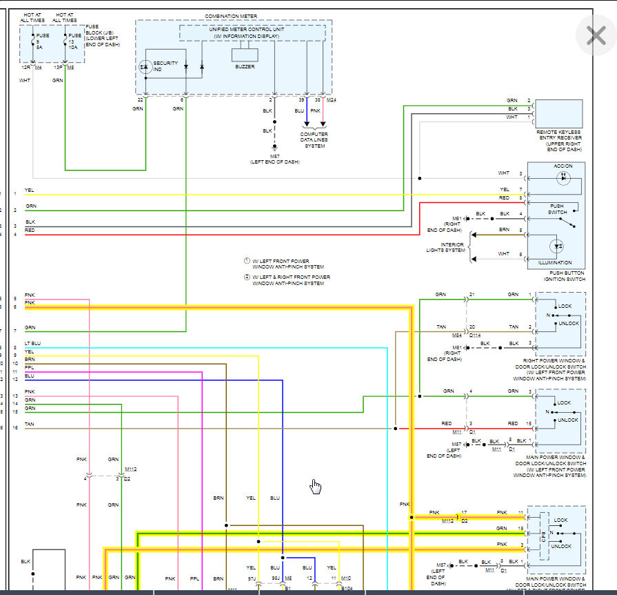

windows and power locks are not working, neither are the lights in the doors, only thing working in the doors are the power mirrors, sun roof and everything else works, door locks work with the key fob and the outside door handle button, I have checked every fuse, inside on drivers side and every fuse under the hood, at first this was intermittent, but now all the time, I'm thinking the BCM, can I run power to the master window power switch to get my windows working, with a wire to the battery?, or will this short out my BCM? Where is the BCM?
Mar 2, 2021 at 9:38 AM

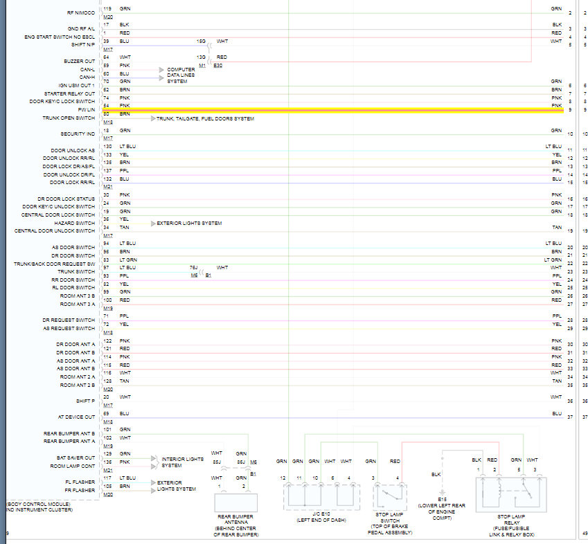

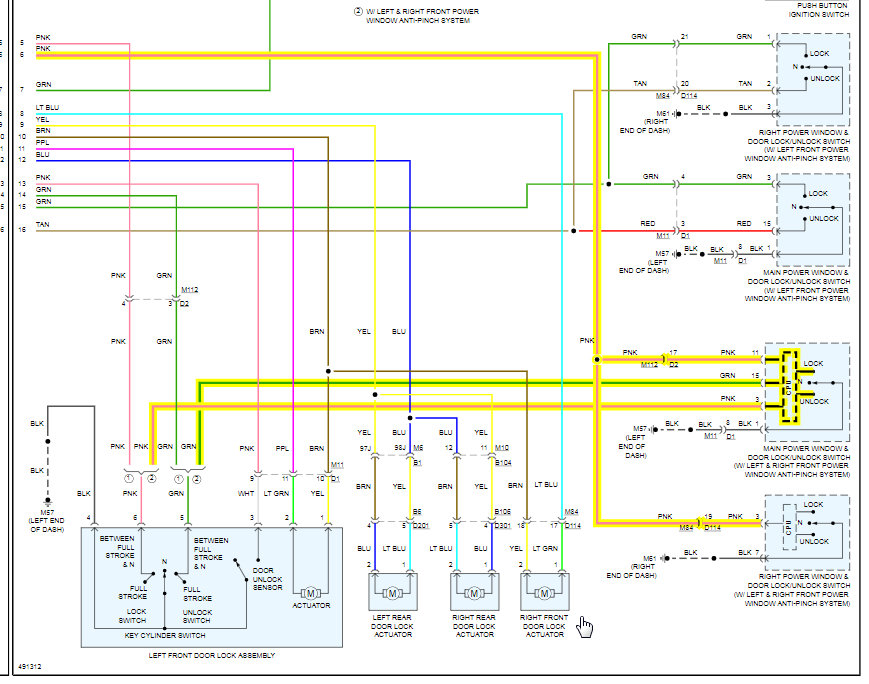

It is unlikely that the BCM is the issue on this one. The reason is, the BCM supplies power to the door switch where the door switch then directs this power to either the lock or unlock. However, if all the door locks and windows are not working then this brings the BCM back into play.
So the way to find this out is remove one of the switches from the door and test for power on the pink wire. if there is no power then the BCM is not sending the needed voltage.

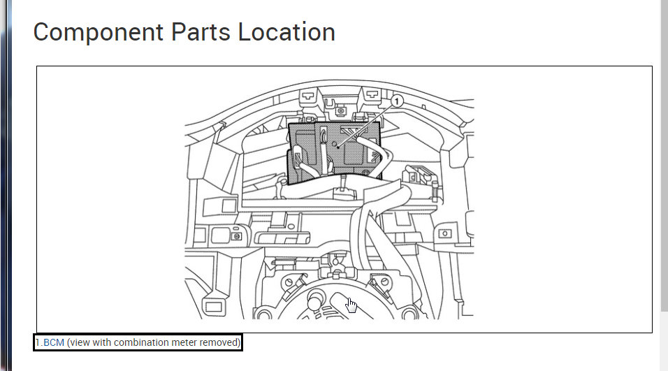

I attached the wiring diagrams below for your review. Let' me know if you have questions on this. Also, the BCM is behind the dash and that info is below as well.
Mar 4, 2021 at 6:58 AM
RED37129
Thanks, I found that the power window master switch was the problem.
