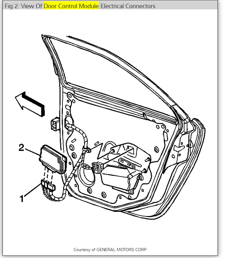

When car is running windows will not go down or up. the one in accessory mode but can get windows to go up only from master switch passenger side switch will let window down but will not go back up. rear window switches will not work at all. the mirrors will not adjust and door locks are not working when car running. not sure if it's a bad ground from one of the modules or where to even look for module grounds.

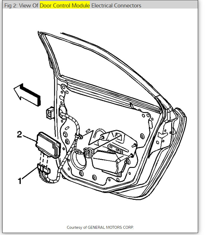

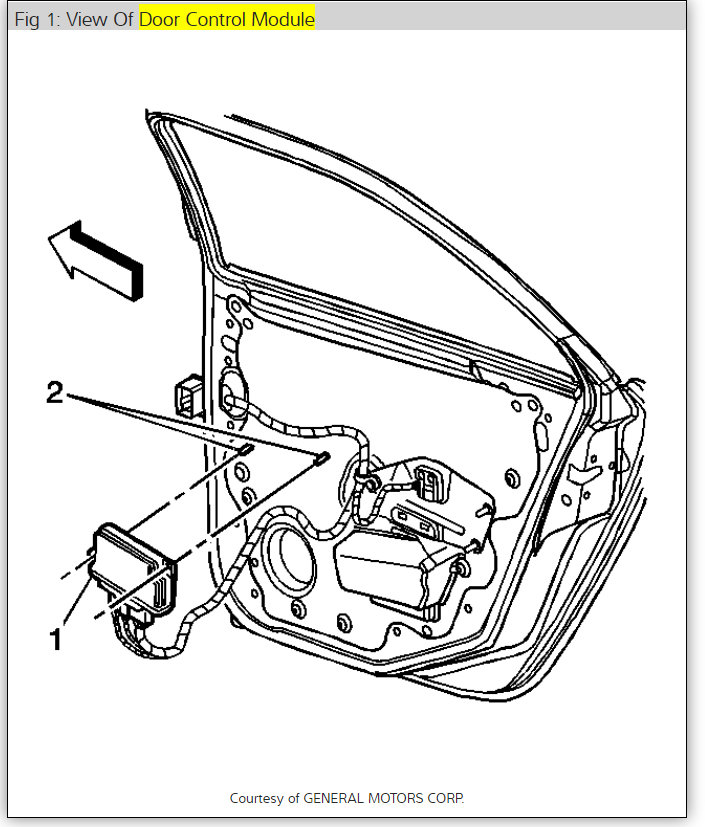

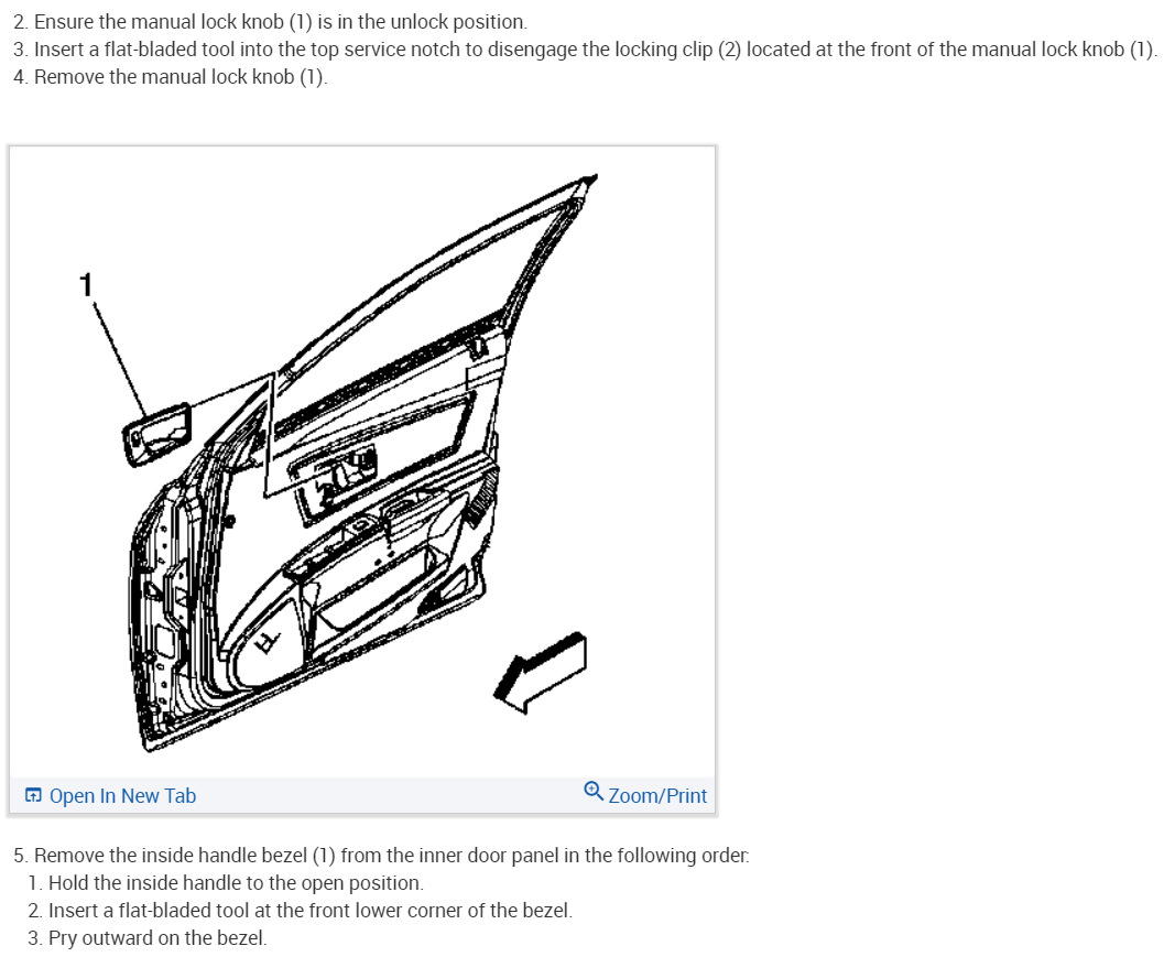

It sounds like the driver door module has gone out which is common. Here is the location of the module and the instructions on how to change it out. If you get used unit it might plug and play.
DOOR CONTROL MODULE PROGRAMMING/RPO CONFIGURATION
When replacing door control modules for export vehicles, all replacement door modules must be reprogrammed in order to relearn the vehicle identification number (VIN). This does not include domestic vehicles. When replacing a driver door module (DDM) or front passenger door module (PDM) the proper vehicle option configurations must be entered for both domestic and export vehicles.
The following steps explain how to program replacement door control modules:

After performing the above steps the power windows must be initialized. Refer to Window Motor Programming - Express Function .

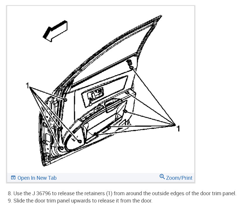

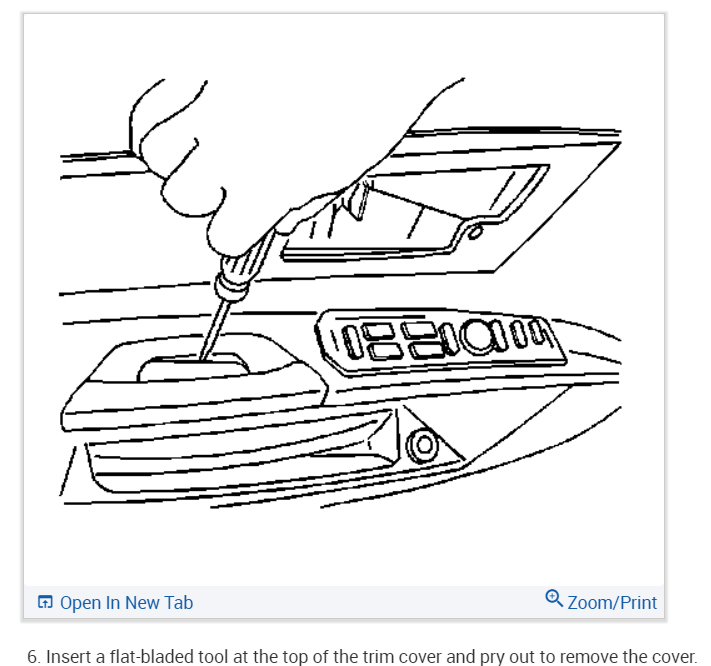

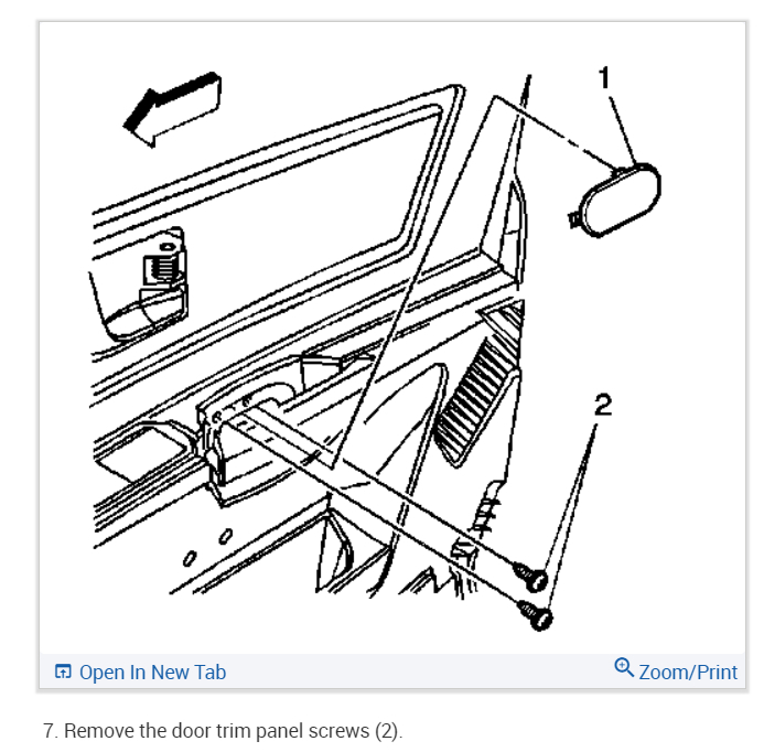

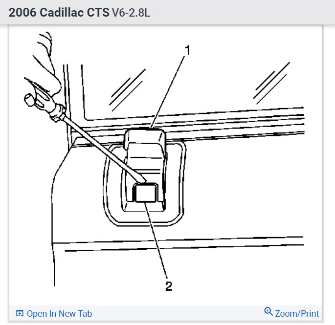

Below are the driver door module location and how to remove the door panel. Check out the diagrams (below). Please let us know what happens.
