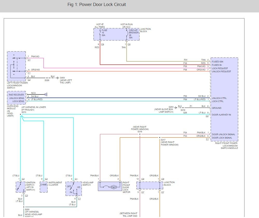

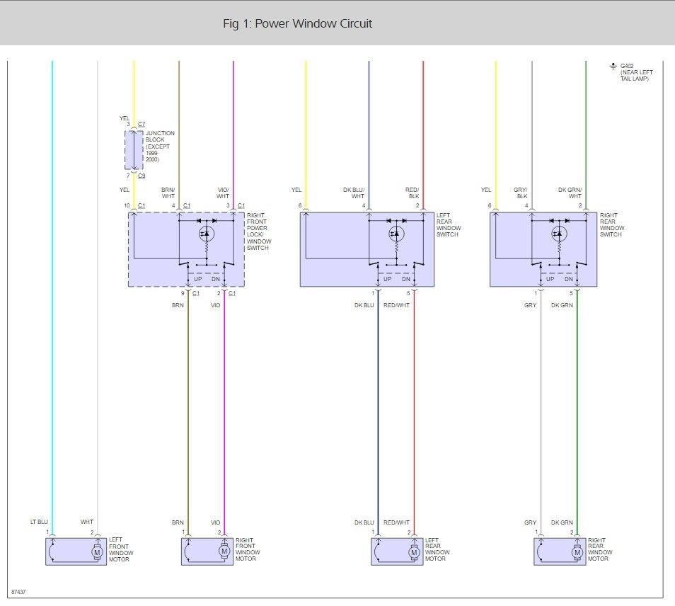

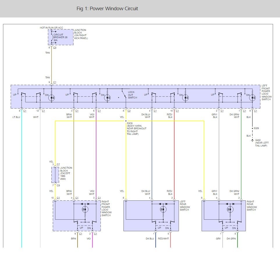

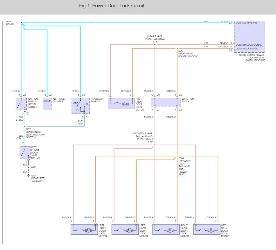

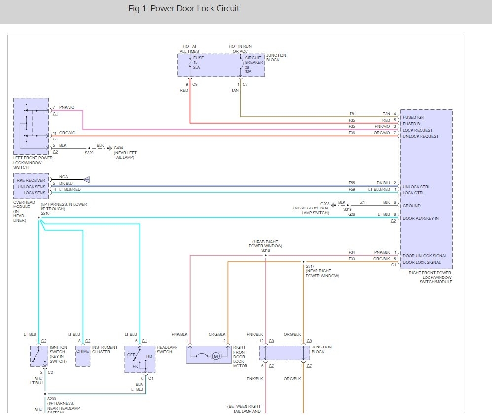

The power windows and locks quit working on my vehicle. They do not work from there separate consoles or the drivers side console. I have check all wires leading into the doors and none are broken or stretching.
May 8, 2017 at 4:24 AM
  • 55,224 POSTS
These cars had a problem with broken wiring in the door by the door frame at the front of the door.
There are some fuses that need to be checked, here is a guide and some wiring diagrams to help you get the problem fixed.
and
and
Please run some tests and get back to us so we can continue helping you.
