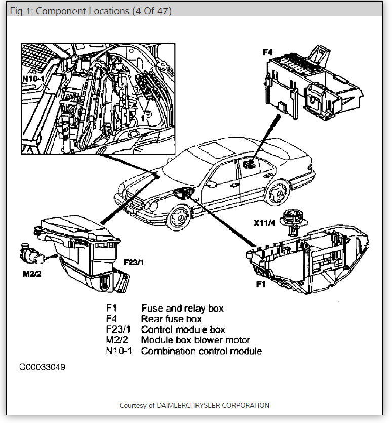

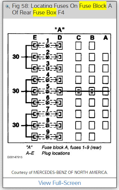

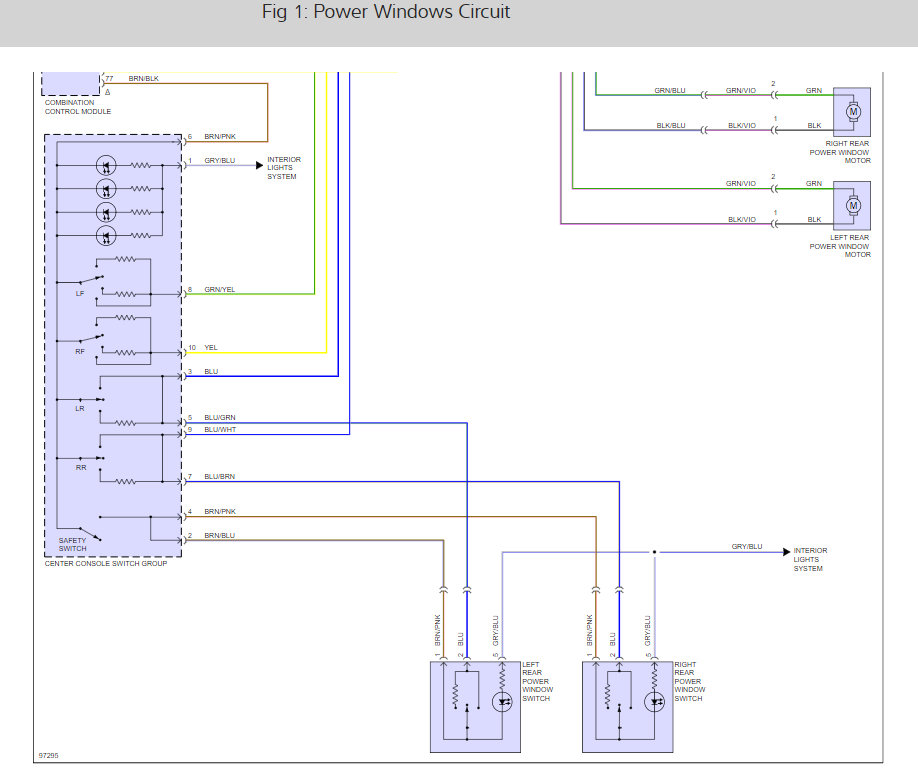

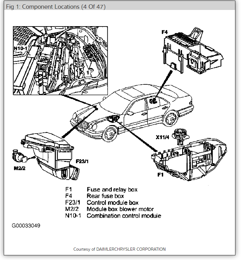

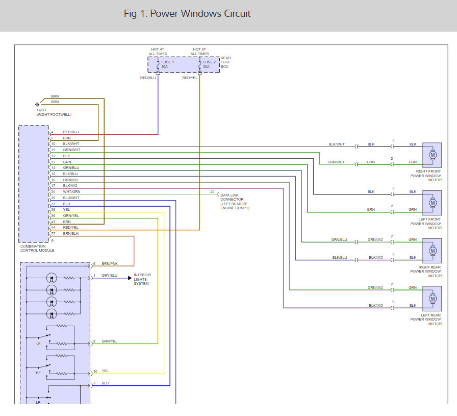

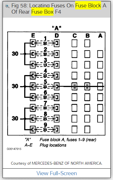

Windows do not work if I use the key in the passenger door. Back windows work up down.
Nov 27, 2018 at 9:01 AM
  • 55,402 POSTS
There are two fuses #1 and #2 in the rear fuse panel that need to be checked. Here are the window wiring diagrams so you can see how the system works and a guide to help you check for power at the fuse:
