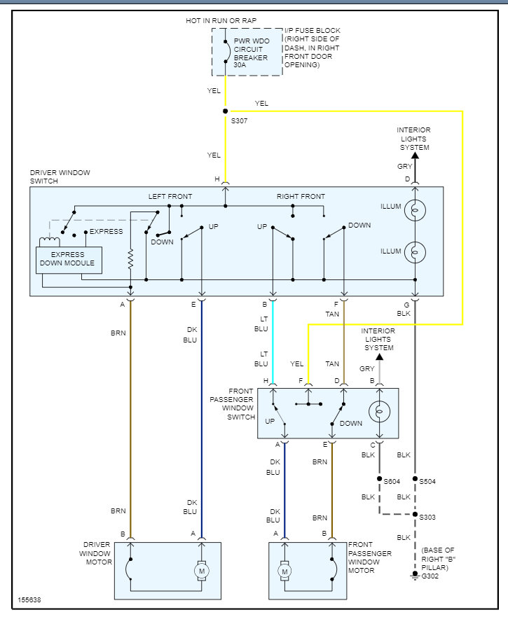

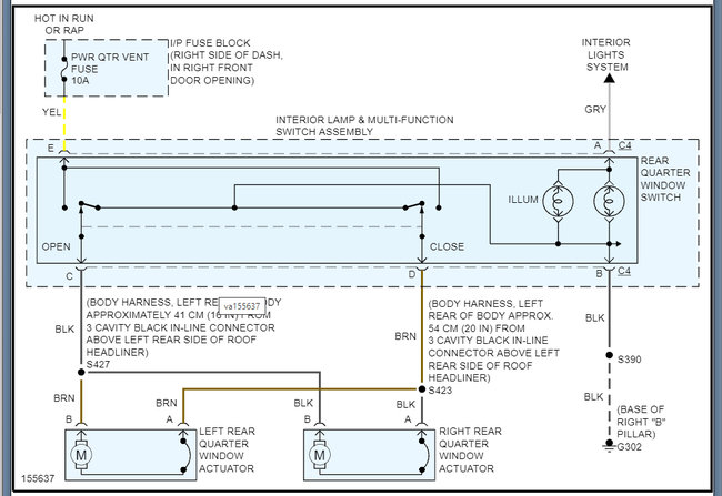

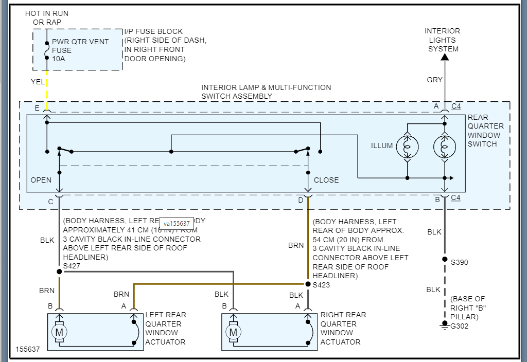

First, passenger front window refused to open a few times a week. Then driver's front window refused to close. We had to use driver's side power button most of the time to control passenger side window. Then passenger side window quit going down completely and at the same time, my back power wing windows stopped working too. So, driver's window is stuck open, Glass is intact in the door. And I can't open passenger side front window or the back side wing windows. Was told that the fuses in passenger side door are fine.
Oct 22, 2021 at 5:10 AM
More than this is a window switch issue, but we need to start with testing a single window circuit and find out what that issue is. Then if that fixes all the windows then that is great. If not, we need to move onto the next window and find what is causing that issue.
Here is a guide on how to test a window switch:
https://youtu.be/HBFBcJrdym4
https://www.2carpros.com/articles/door-panel-removal
I am attaching the wiring diagrams below that will help with this.
Please run through this info and let's go from there. Thanks
