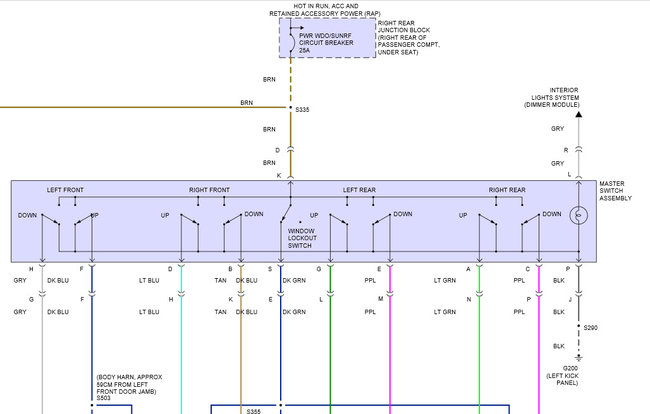

just acquired this sleeping giant from a friend who needed it out of his garage she needs lots of love. so my question is I have power windows, all 4 do not roll up or down but my sunroof does. my background in electronics would normally follow a schematic sheet to the source of the problem. but I can't find a service book to diagnose the symptoms for it. so does anyone think they can help since I don't think I have 4 bad motors that's a very rare situation.

this operates off a circuit breaker which sunroof is working so breaker is ok, check for poor connection at master switch on driver's side and make sure lock isn't engaged that may be the only problem.
