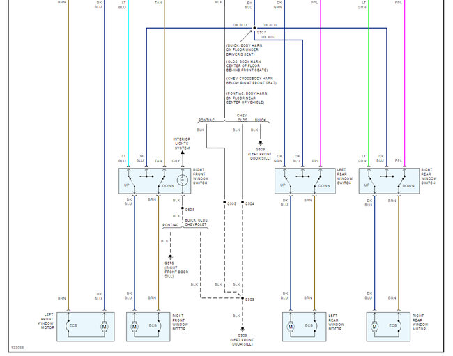

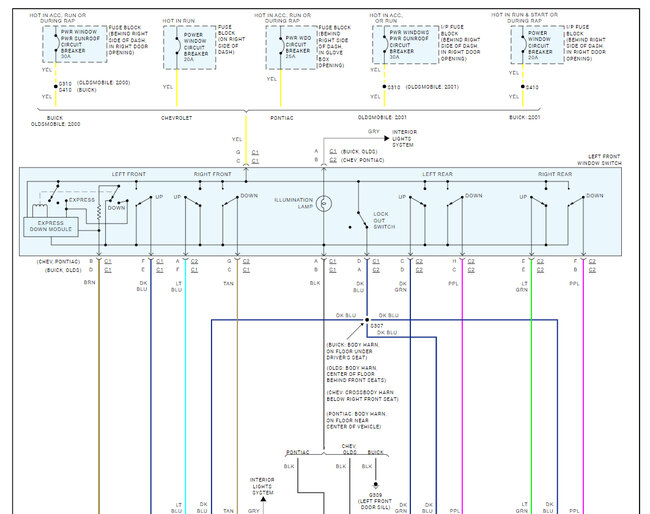

The windows won't roll up or down it's a new Switch and a new window roller in the driver door.
Sep 25, 2024 at 4:42 AM
  • 55,673 POSTS
When you say roller do you mean motor? If so let's see if the switch is getting power, here is a guide to help and the window wiring diagrams so you can see how the system works and a guide to help check it.
With the key on test the yellow wire at the switch for power. Check out the images (below). Please let us know what happens.
