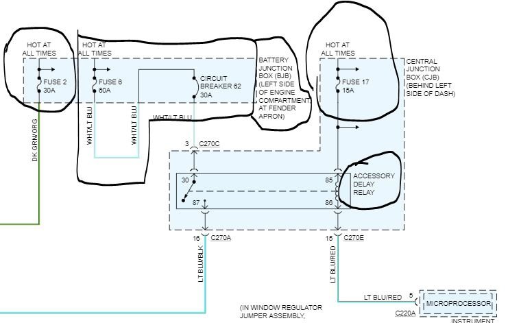

All four of my windows won't work. Replaced the switch in the driver side door and they still won't go down. Is there something else I can do?

The first thing we need to check is if there is a bad fuse. There are three I need you to check. See picture 1.
Here are a couple links you may find helpful:
If they are good, you need to next check the window relay. See picture 1.
In this case, see if there is another relay with the same part number and switch them. If there isn't, here is a link that explains how to test a relay:
Here are a few links you may find helpful when testing electrical components:
There is a circuit breaker in the system, but lets start with what I listed.
