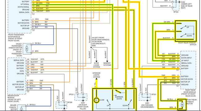

Can roll down the driver window but the other 3 do not work.
Apr 16, 2021 at 3:36 PM
Good morning,
I attached a diagram for you for the windows.

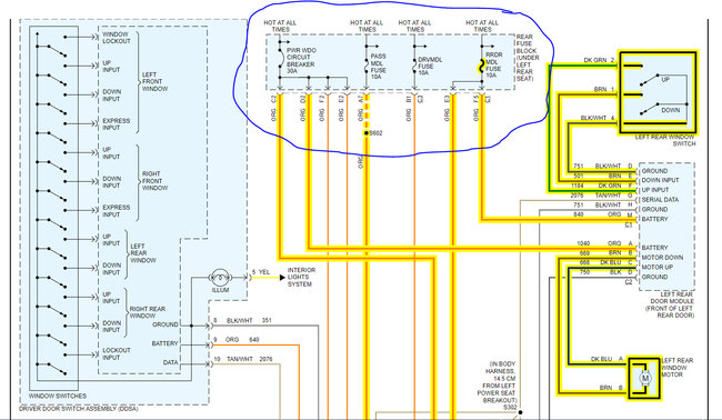

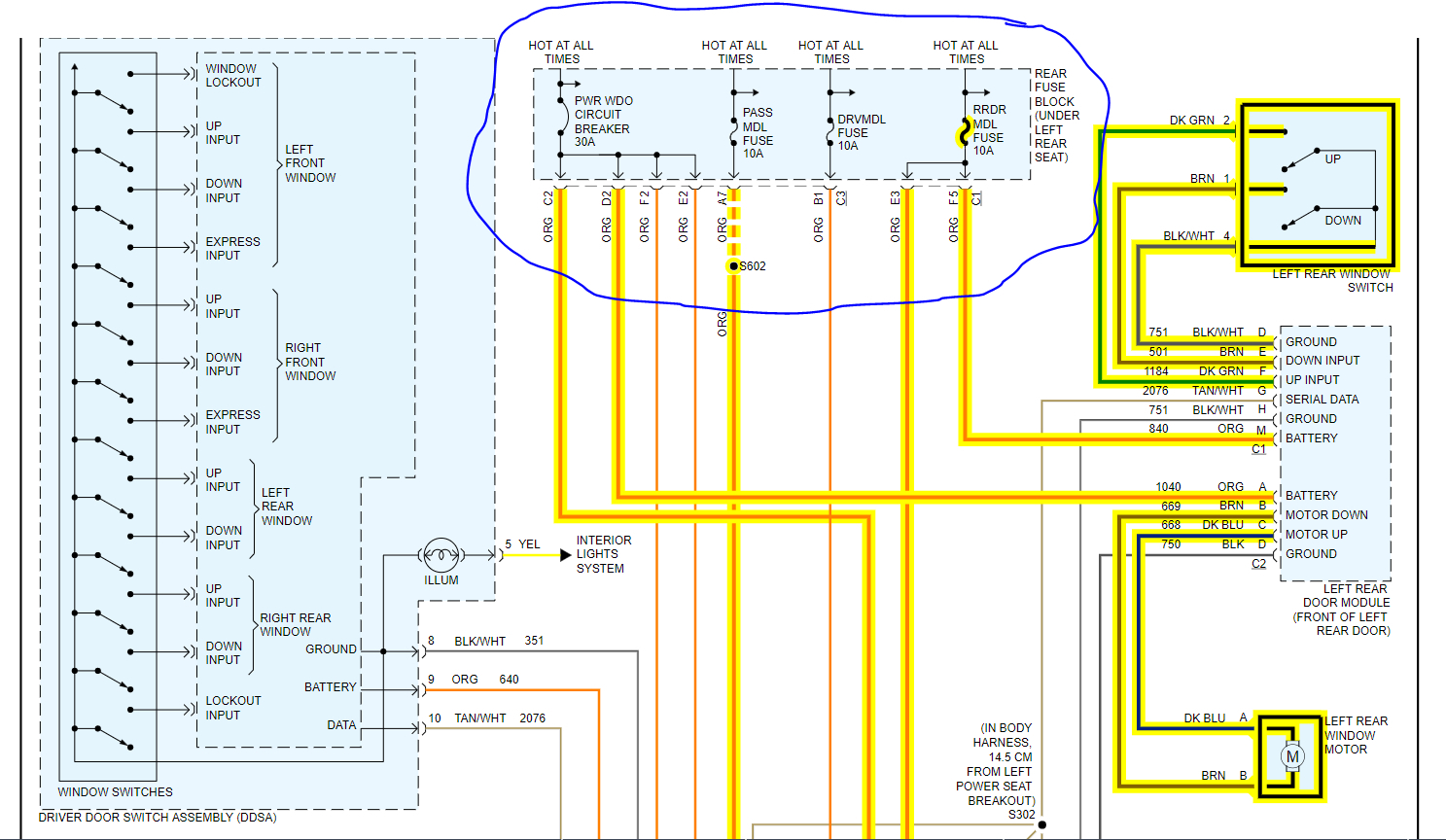

Check the fuses I circled under the back seat for power with the key on. The one thing that they have in common is the fuse block. That was a common failure.
