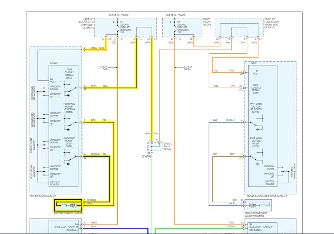

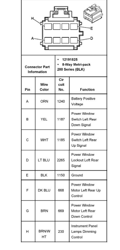

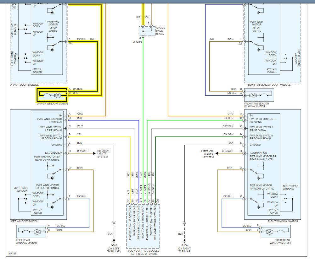

window on drivers' side will not work, i have replaced it two times still won't go up! i need wiring diagram and info on which color each wire represents.
Oct 29, 2021 at 5:29 PM
Good morning,
I attached the wiring diagram and the connector diagram for you below.
Check the wires inside the boot that goes from the body to the door. It is common for the wires to break from all the flexing.
Let me know if you have any other questions.
