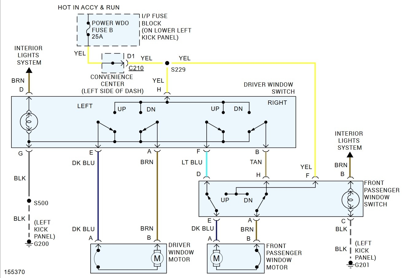

Can I get the wiring diagram and or the schematic for the driver and passenger side window switch please? thank you.

That truck uses a simple polarity reversal system to move the windows. This is the wiring for them. What issue are you having?

Thank you very much for the response, theres no problem just putting my own switch in is all.
