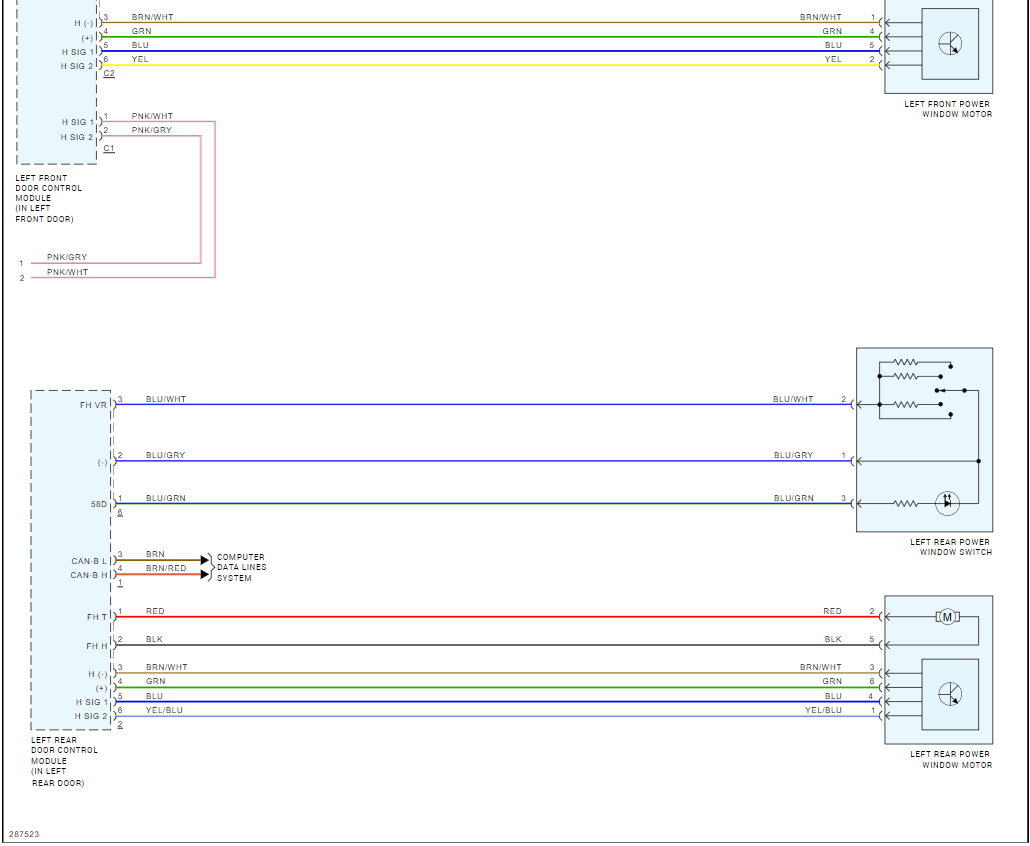

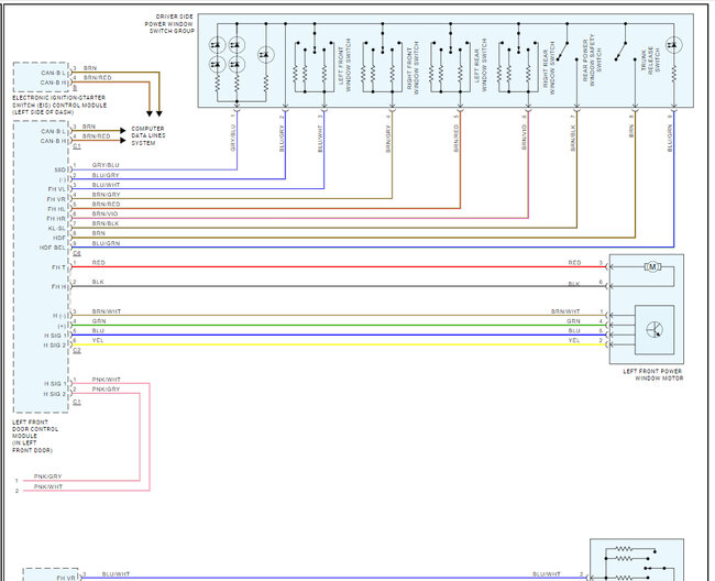

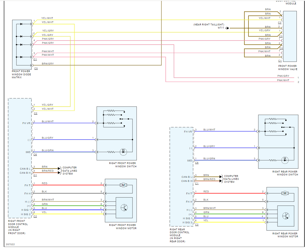

I would like to know the wiring diagram for the passenger side window switch. I'm trying to test it to see if it's just a switch that has failed because the motor works the regulator is fine, the fuses are good and so are the relays. Thank you
Oct 7, 2024 at 4:46 AM
  • 55,402 POSTS
The easiest way is to unplug the window motor and use a test light to see if it is getting power and ground while you work the switch. This guide can help:

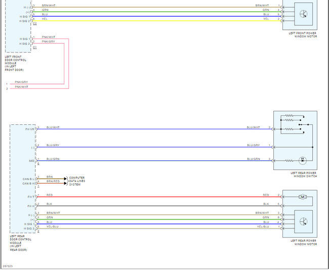

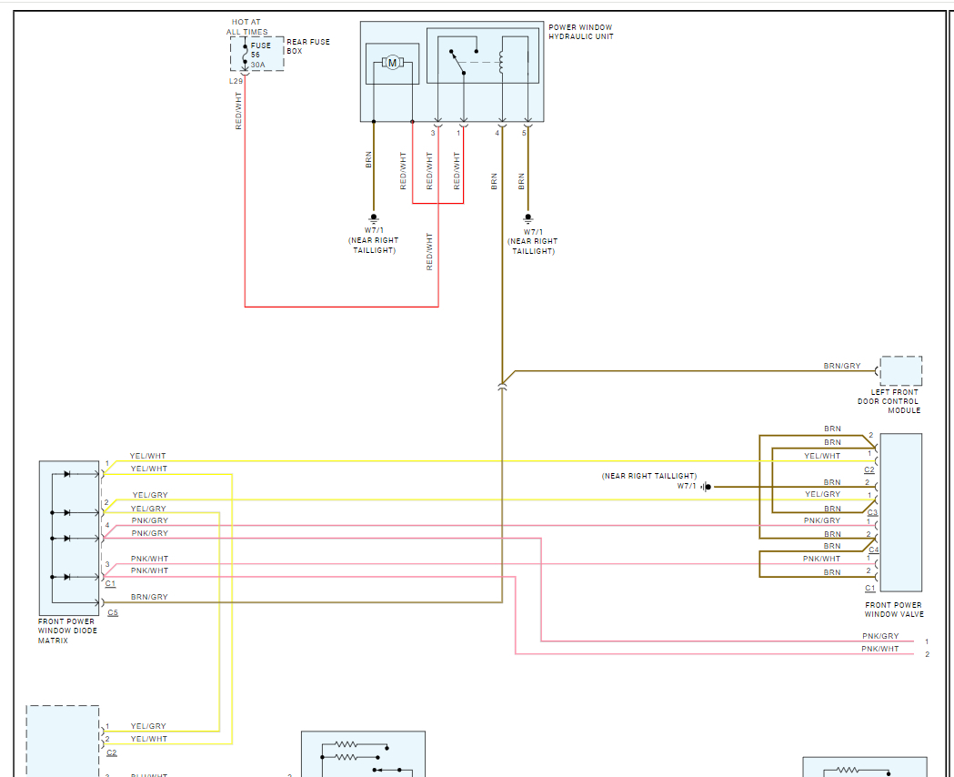

Here is the window wiring diagrams as requested, check out the images (below). Let us know how it goes.
