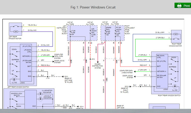

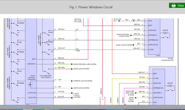

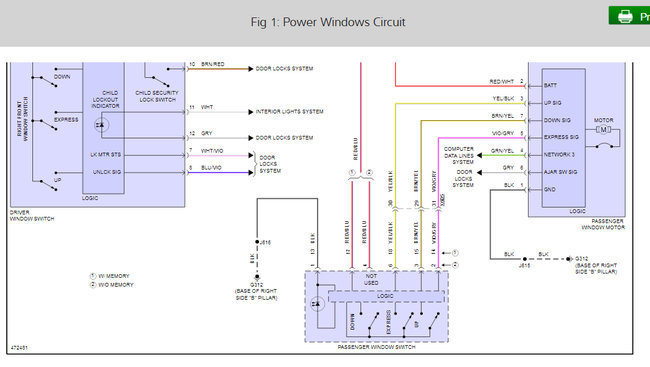

The drivers side window switch does not open the front passenger window.
Need wiring diagram for the switch to do a conversion.
May 18, 2019 at 8:07 PM
SCGRANTURISMO
  • 4,897 POSTS
I have included in the diagrams down below the information that you requested. I have also included a link for you to go to below as well:
https://www.2carpros.com/articles/electric-window-repair
Please go through this guide and get back to us with how everything turns out.

The Main Window LHS Switch is a 12 pin and when opened it is hard wired on a green board. Will pass this information to the auto electrician to see if he can do the conversion as required from LH drive to Right hand drive for Australia use.
The new switch we purchased from Cadillac LA. Left top switch opens drivers side window in Australia and the right top switch opens the left hand drivers side US window.
