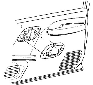

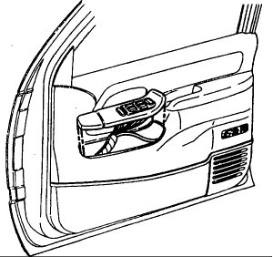

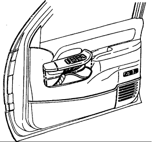

If you look at the first picture, it is how to remove the door panel. I always find it helpful to know where all the clips, screws are located. If you have power windows, here are the directions for removing the panel, switches.
Remove or Disconnect
Negative battery cable.
Accessory Switch Plate Mounting
Switch mounting panel.
Use a flat blade tool to carefully pry door accessory mounting panel from door trim panel.
Power accessory electrical connectors from switches and speaker (if applicable).
Switches from switch mounting panel (if applicable).
Use a flat blade tool to carefully pry switches from accessory mounting panel.
Speaker grill front switch mounting panel (if applicable).
Carefully spread speaker grill retainers.
Speaker from switch mounting panel (if applicable).
Rotate speaker counterclock-wise.
Install or Connect
Speaker to switch mounting panel (if applicable).
Rotate speaker clockwise.
Speaker grill from switch mounting panel (if applicable).
Snap in place.
Switches to switch mounting panel.
Snap in place.
Power accessory electrical connectors to switches and speaker (if applicable).
Snap in place.
To remove the handle bezel:
Handle bezel from door trim panel.
Insert a flat blade tool between the door inside bezel and the handle assembly.
Carefully bend retaining clips outward while pulling out the bezel.
Disconnect the wiring connector (if equipped with power locks).
Install or Connect
Handle bezel to door trim panel.
Connect the wiring connector (if equipped with power locks).
Snap bezel into place.

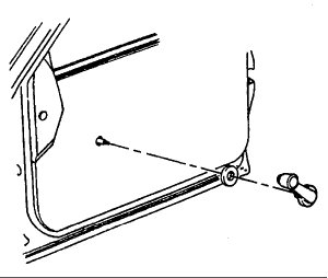

Here are the directions for windows regulator replacement specific to your vehicle. I've also attached pictures to help.
The power window motor can not be serviced. It is replaced as a unit with the regulator.
Tool Required:
J 34940 Rivet Gun
Trim panel.
Water deflector. Refer to Inner Panel Water.
Inner mounting panel assembly. Refer to Inner Mounting Panel.
Rivets securing the regulator to the door inner panel. Drill out (2) front and (2) rear rivets.
Regulator from inner panel.
Install or Connect
Regulator to inner panel.
Rivets securing the regulator to the door inner panel using J34940.
Water deflector.
Trim panel
