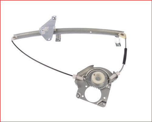

How to remove and replace left front power window regulator?
Sep 25, 2018 at 1:01 PM
DANNY L
  • 5,648 POSTS
Hello, I am Danny.
After removing the door panel you will have access to the Power Window Motor and Regulator. It is held to the door and tracks with a few bolts.The window glass is held to the regulator. I have attached a tutorial showing how to remove the door panel but, I could not find a regulator tutorial. I have attached a picture also of a new regulator and they sell for roughly $70.00. Hope this helps and feel free to ask any questions. Thanks for using 2CarPros.

Sep 25, 2018 at 2:40 PM
EARLCV1
I have the panel off. I see several bolts but I do not know which ones to remove. Also, the window glass is sitting on the bottom of door. I can lift it up and down using my hands and I do not know how to proceed!
Sep 25, 2018 at 2:52 PM
  • 55,433 POSTS
Here is a video that shows how to do the job:
https://youtu.be/Wp7Ak9IGs4o
