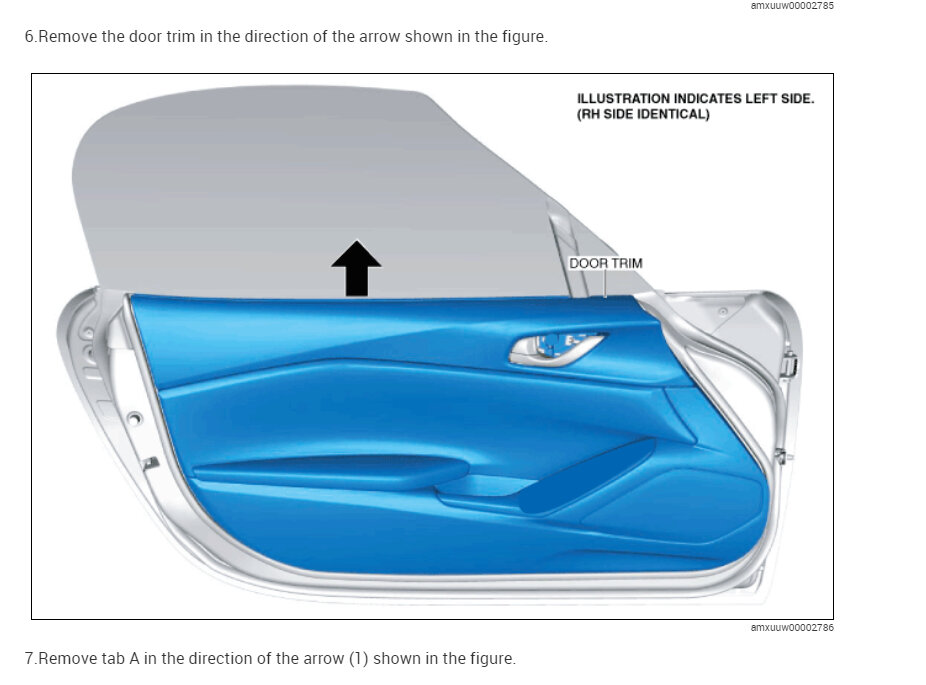

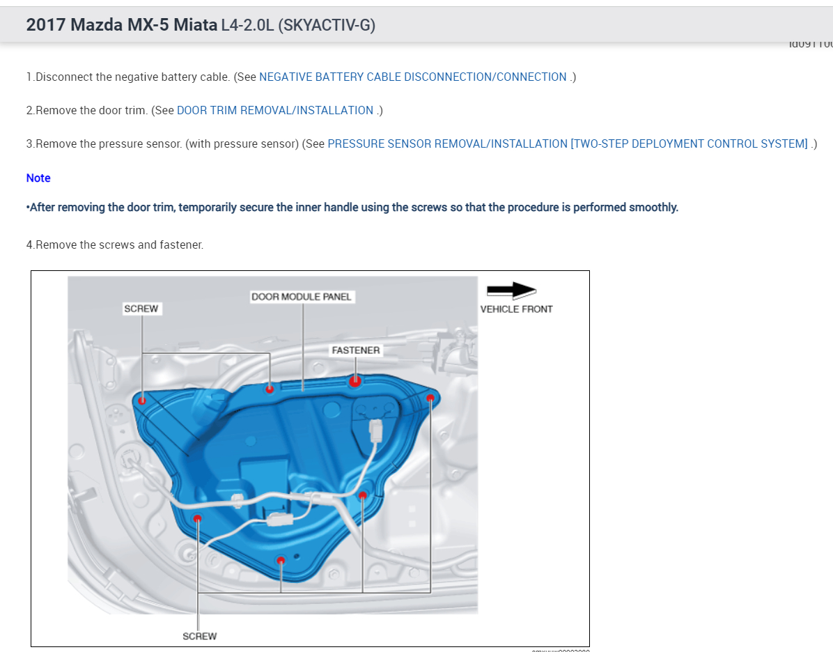

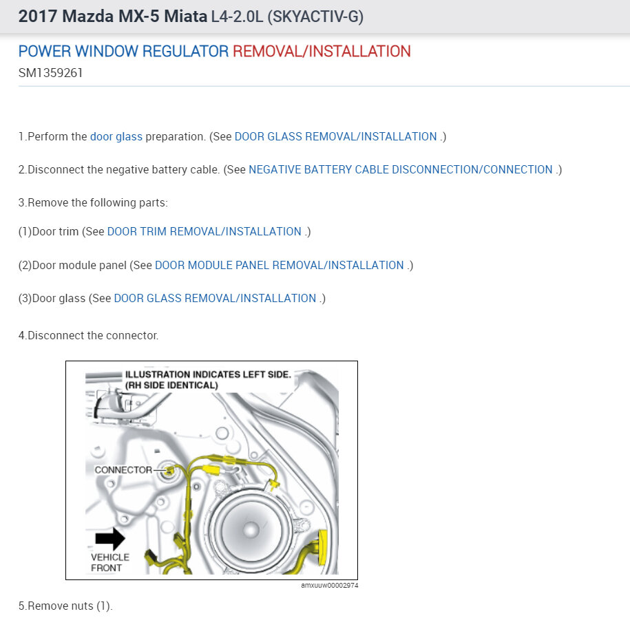

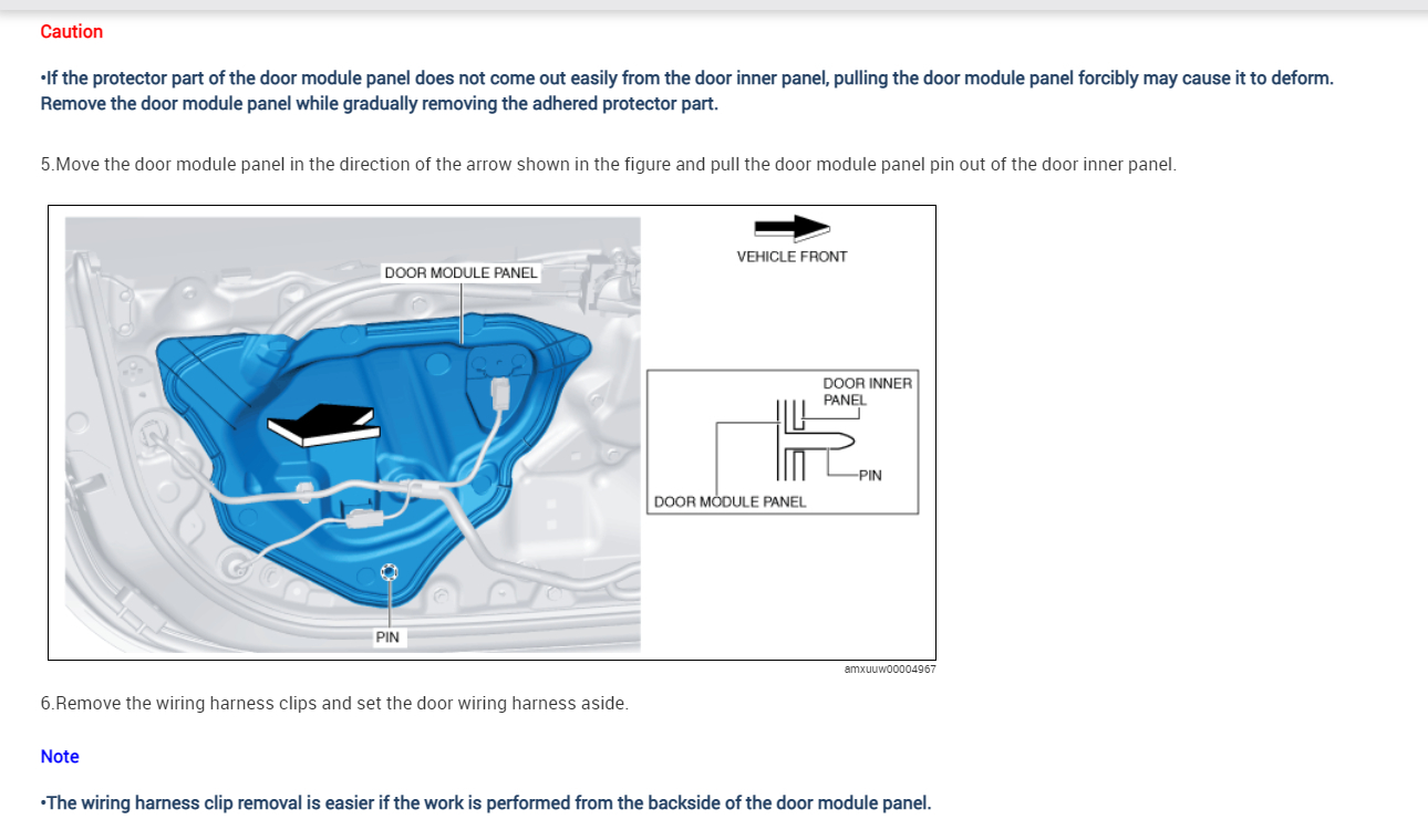

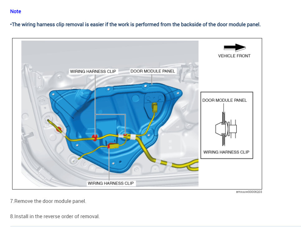

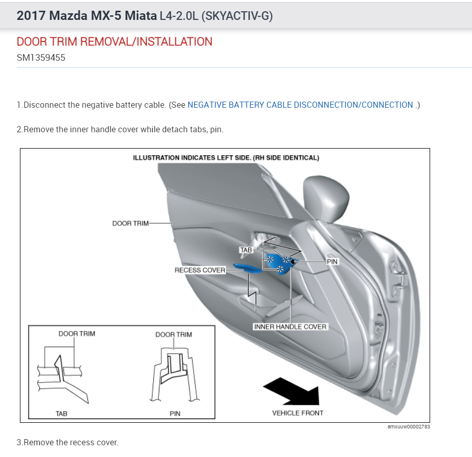

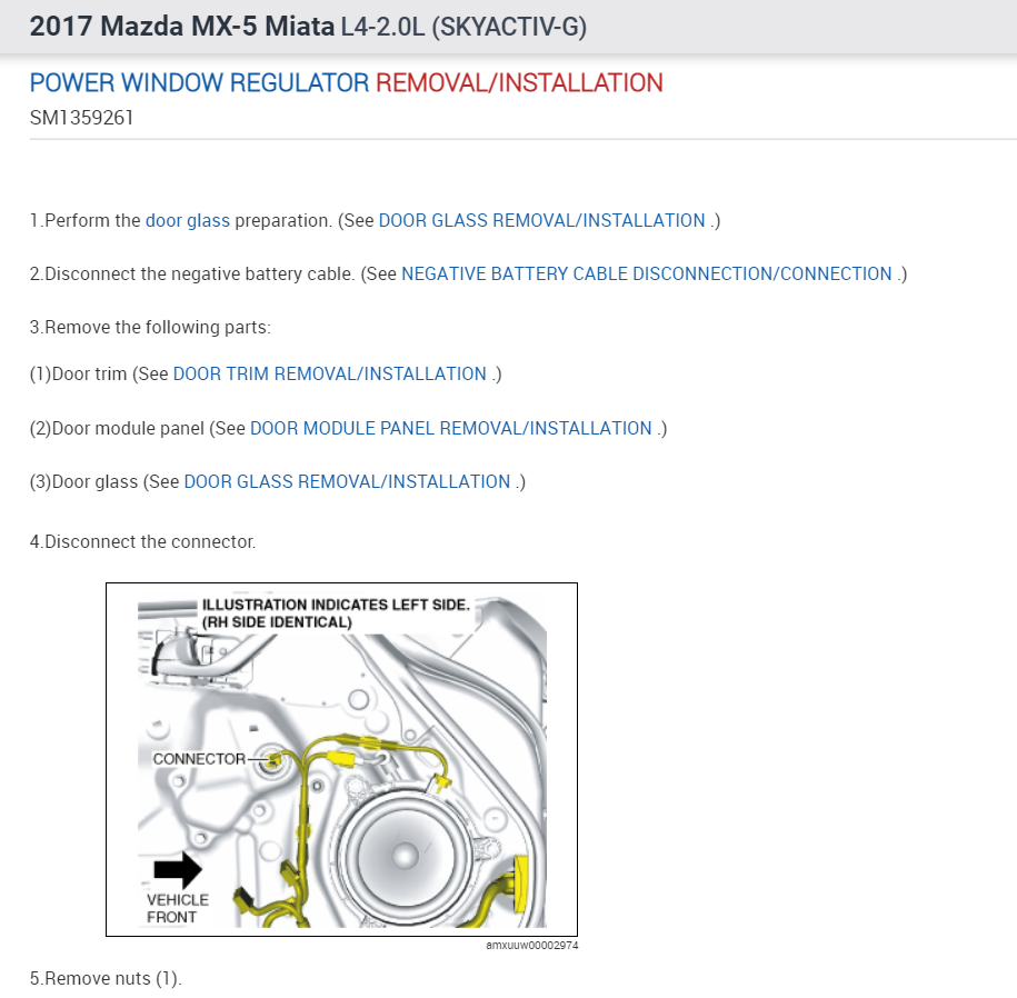

At first the passenger window would only go down but not up! The driver's side was working fine but now this has the same problem, it goes down but not up. I can hear the motor trying to work when pressing down but when I press up, I can’t hear anything, can’t understand why this would happen to both windows! It’s like it needs resetting perhaps.
Jan 27, 2023 at 5:06 PM
  • 55,432 POSTS

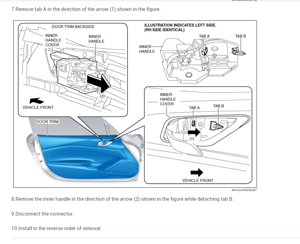

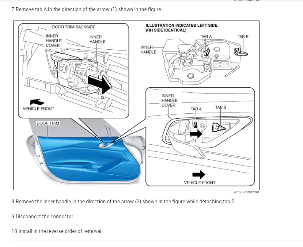

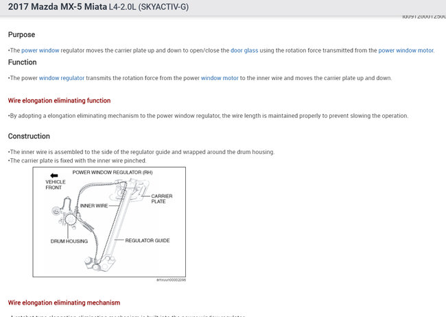

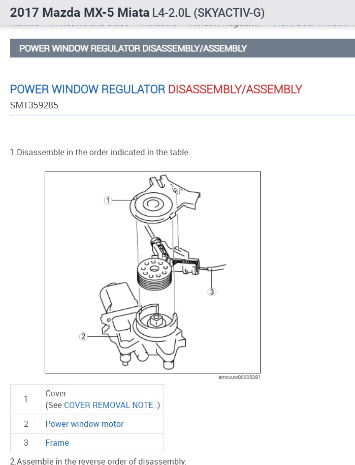

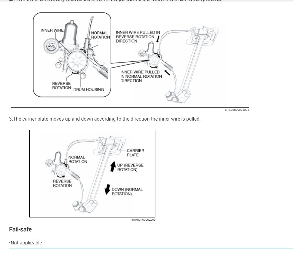

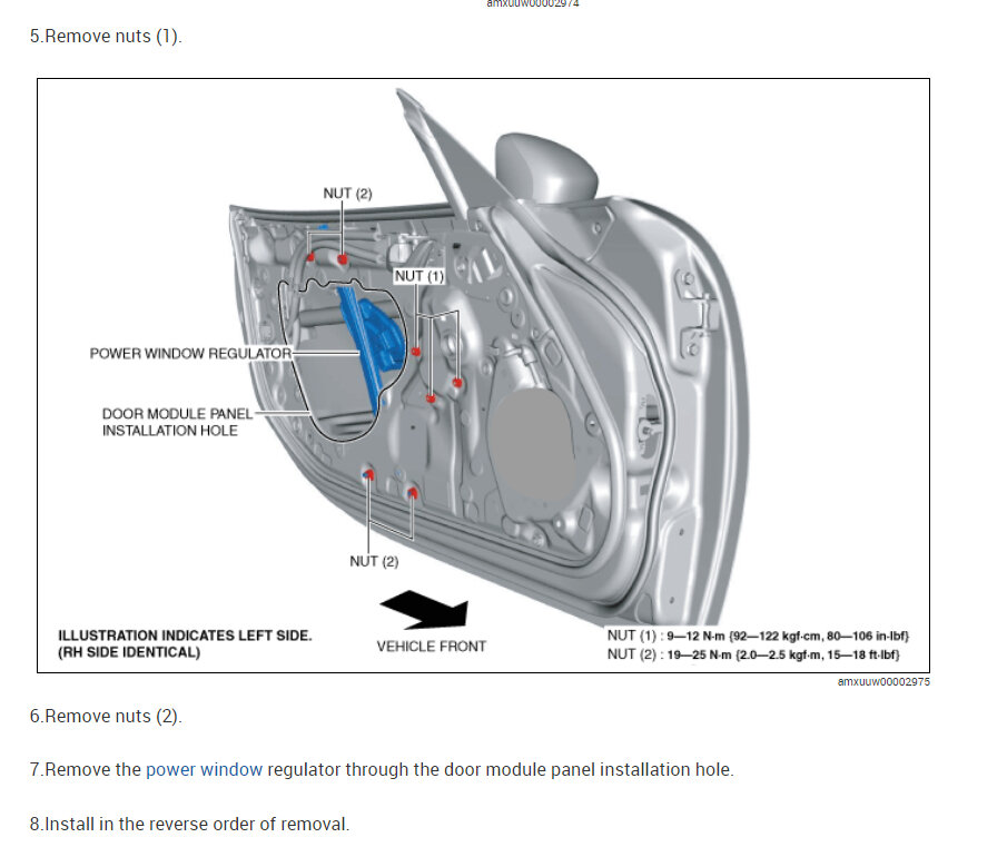

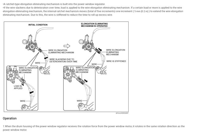

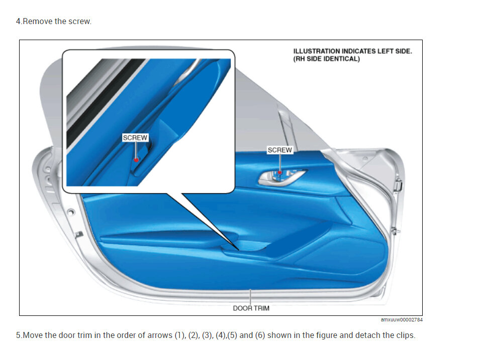

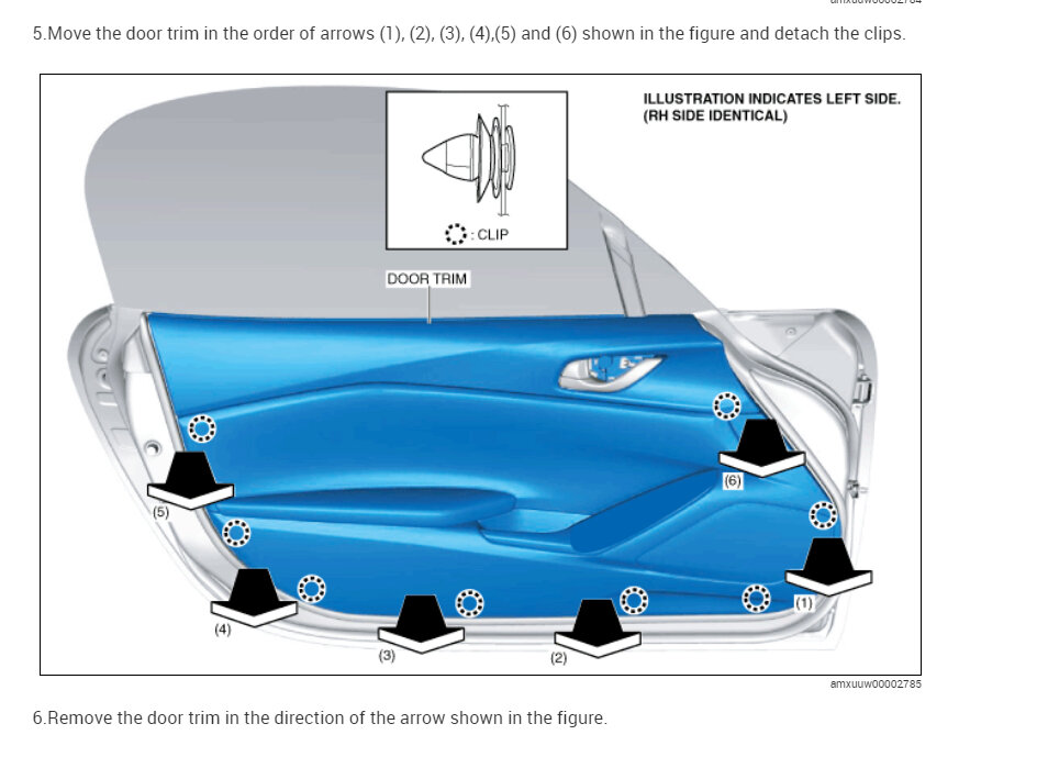

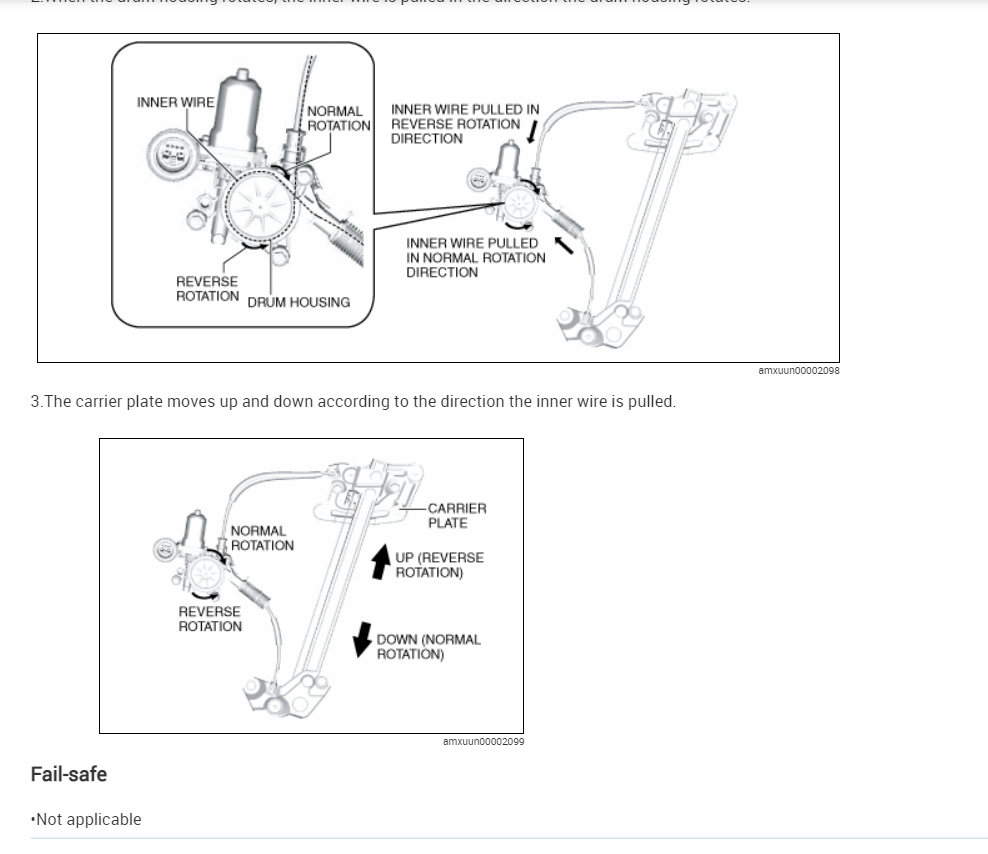

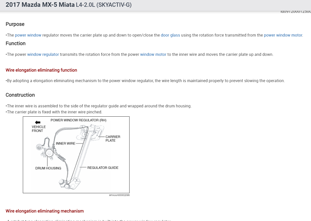

If you can hear the motor trying to work in mean the window regulator is out which is common, here is a video of the job being done on a similar car for example the process is the same on most cars, and I have included the instructions for your car in the images below.
https://youtu.be/Wp7Ak9IGs4o
Check out the images (below). Let us know what happens and please upload pictures or videos of the problem.
