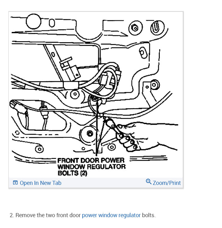

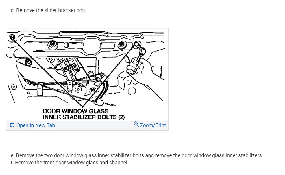

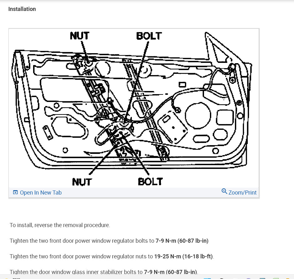

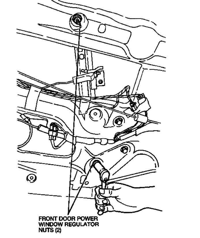

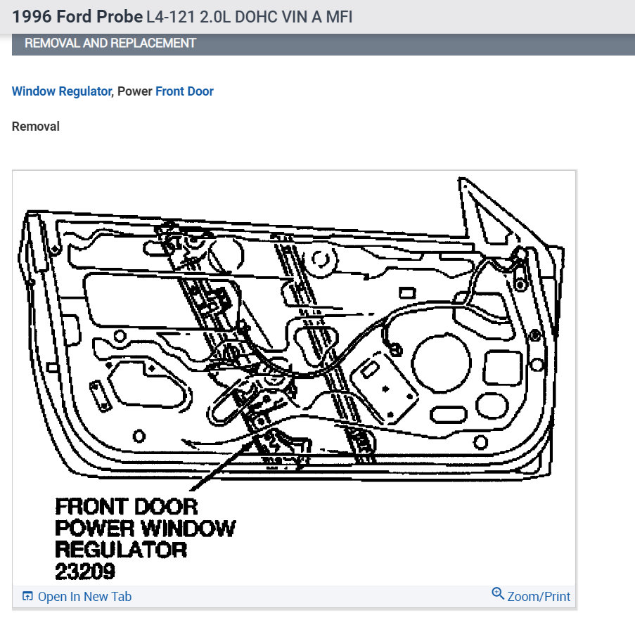

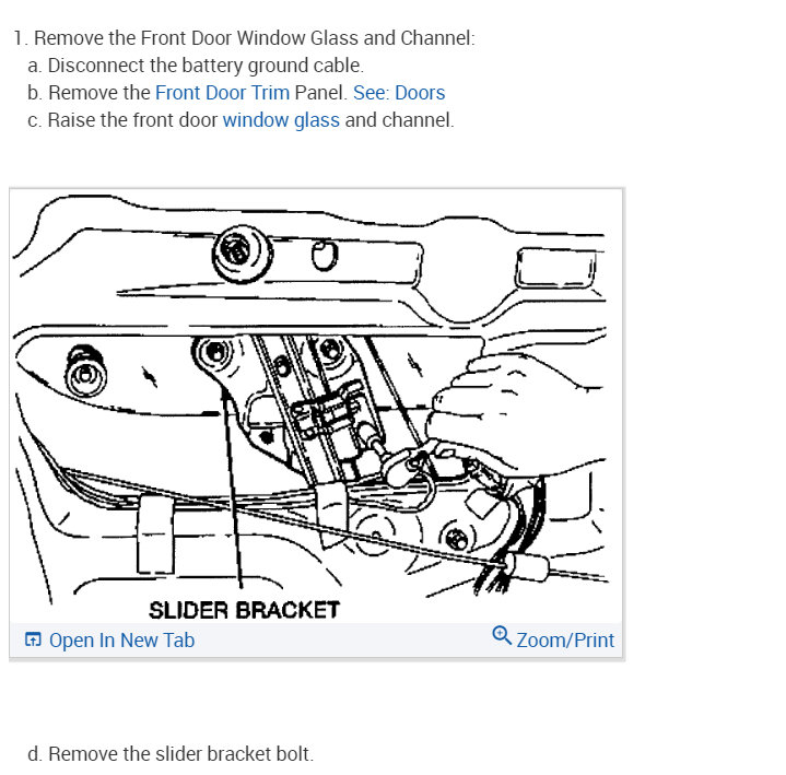

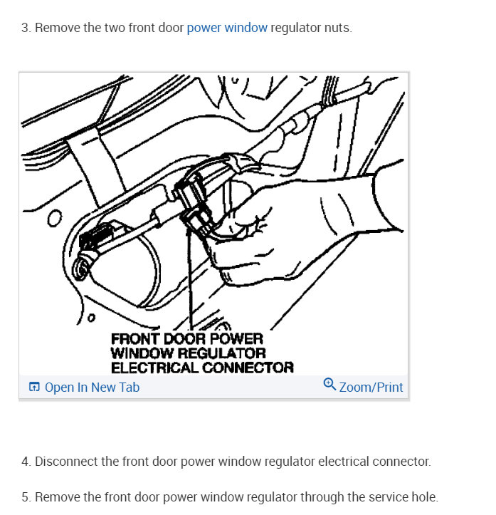

This happens when the window regulator goes out.
Here is a video of the job being done on a similar car with instructions below for your car:
https://youtu.be/oNxstjcA25k

Nope it sure doesn't. The new motor should have fixed it, good job getting the motor and installing it so quickly. Try lubing the rails or see if there is an obstruction, also you can try to remove the motor and regulator and see if it works outside of the car.
