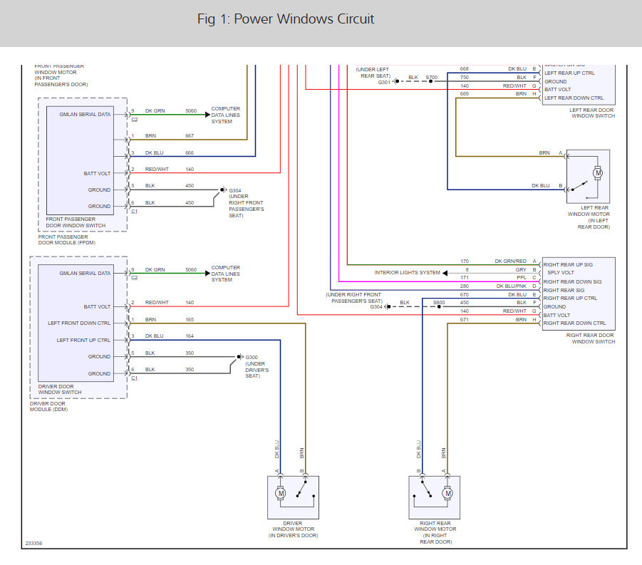

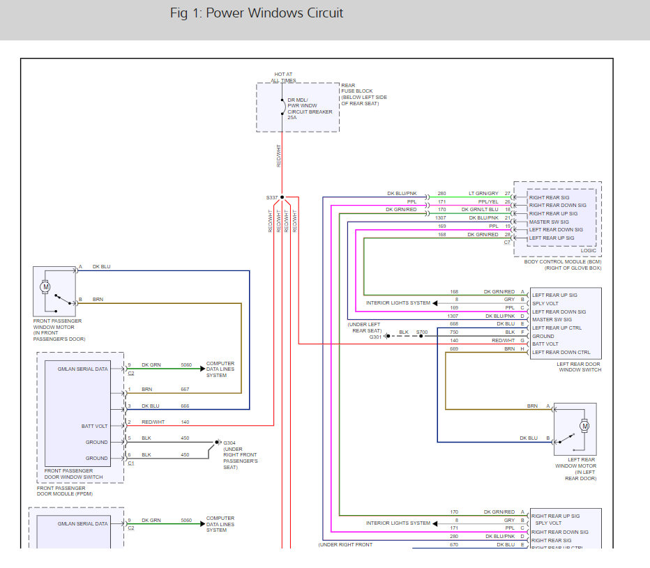

The window on front passenger door will not open or close, can hear the relay click in the switch assembly and all other functions work. Verified the motor/actuator assembly works by manually jumping the power. Is there a way to trouble shoot the switch assembly? it has two circuit boards inside.
Aug 22, 2019 at 12:36 AM
  • 55,797 POSTS

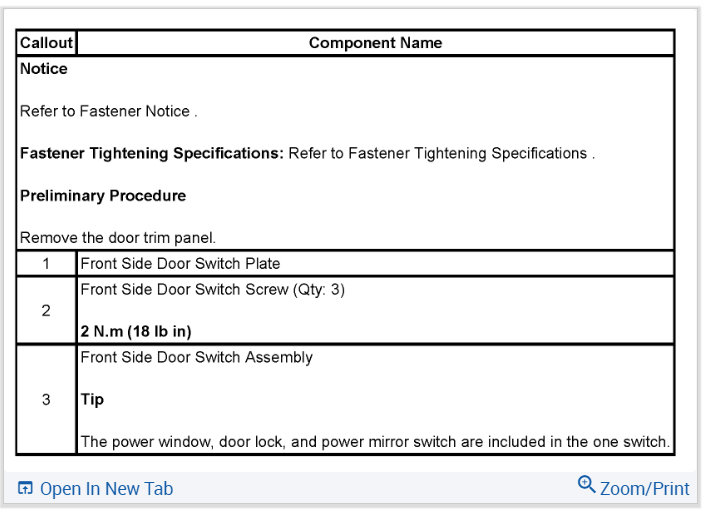

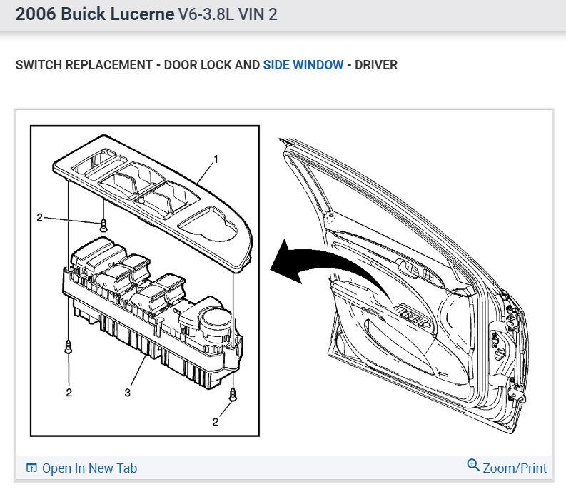

It does sounds like the main switch is out. To be sure here is a guide to help test it with the window switch wiring diagrams below so you can see how the system works and how to replace the switch:
https://www.2carpros.com/articles/electric-window-repair
and
