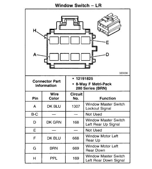

If I am understanding the schematic, I should have continuity between the brown wire from the switch to the motor, and the dark blue wire from the switch to the motor, correct?
I have continuity on the brown, but not the blue. (Used continuity setting on multi-meter) I just was not sure if there was anything else in the path that would cause it to not have a passive signal flow on that wire.

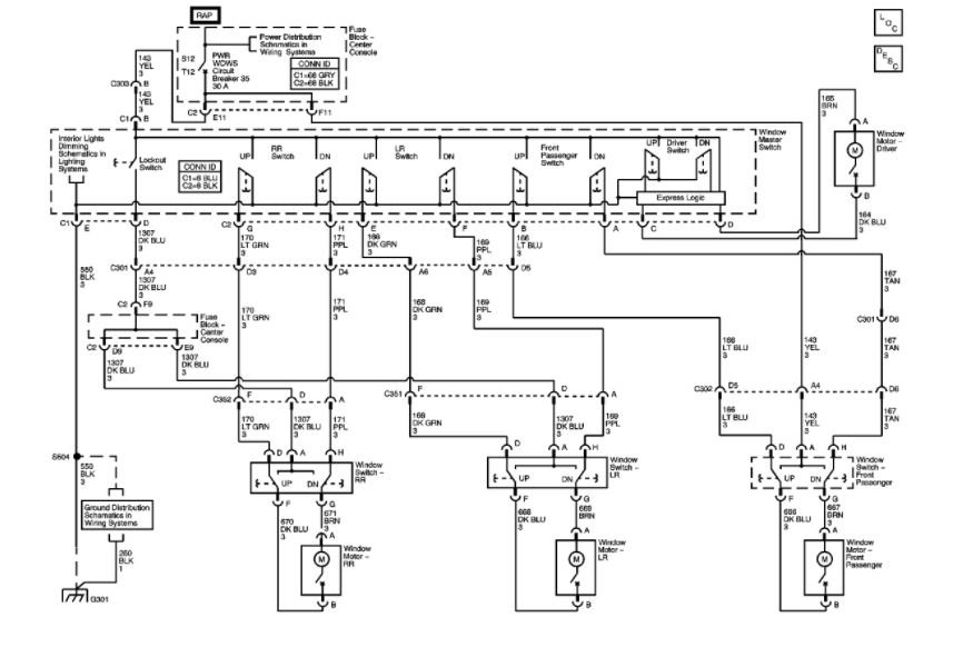

Brown wire is not being grounded. that is the issue. it should read as close to 0 as possible.
Mar 15, 2018 at 6:07 AM
The brown wire goes all the way back to the master switch. do a continuity test on the brown wire from the switch to the master switch.
Mar 15, 2018 at 6:09 AM

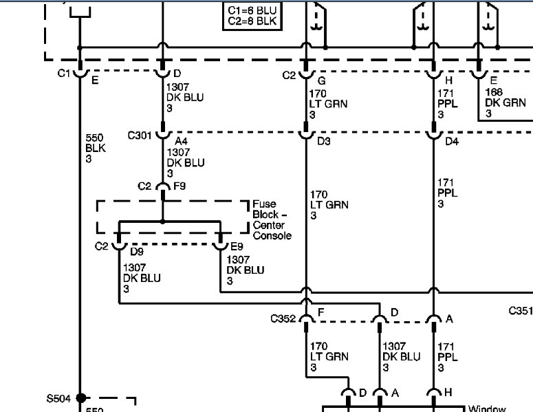

Does the brown wire not just go between the rear door switch and the motor?
Mar 15, 2018 at 6:32 AM
nope, look on the diagram I sent you way back. when it is activated follow the path. it goes back to the master switch.
Mar 15, 2018 at 6:43 AM
DREV0012
  • 36 POSTS
Maybe I am missing something. It looks like the brown wire from the passenger rear window motor connects to the switch on that door, which then switches between dark blue and purple. I only see three wires entering the passenger rear switch (light green, dark blue, purple).
Mar 15, 2018 at 6:55 AM
I am sorry, the brown wire changes to the purple wire which goes back to the master switch.

Here is what I found regarding continuity from the master switch:
Dark green
--Connects to dark blue (to motor).
--Connects to light green.
Purple 1
Light green
Purple 2
Neither purple wire connected to the purple wire at the local switch.
Mar 15, 2018 at 7:14 AM
Pin 11 is the location at the master. check for continuity from there to the switch at the door.
Mar 15, 2018 at 7:26 AM
DREV0012
  • 36 POSTS
Can you tell me which is pin 11? I do not see any labeling other than letters on the master switch?
Mar 15, 2018 at 7:31 AM
Pin H in the master.
Mar 15, 2018 at 7:41 AM
DREV0012
  • 36 POSTS
With both of the switches connected to the harnesses, Pin H tests positive for continuity with the dark blue and the light green. When the switches are removed, it does not have any continuity.
