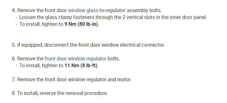

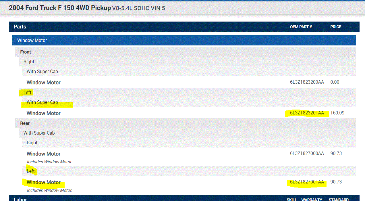

I looked up both front and rear part numbers and they are different. Therefore, chances are you can't switch them. See pic 1 below.

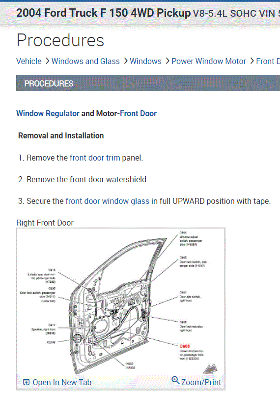

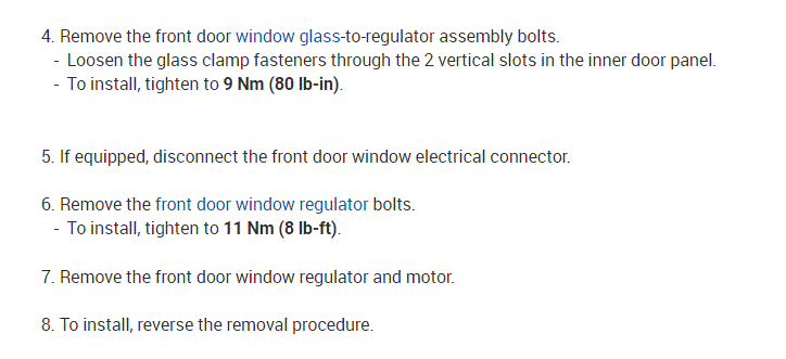

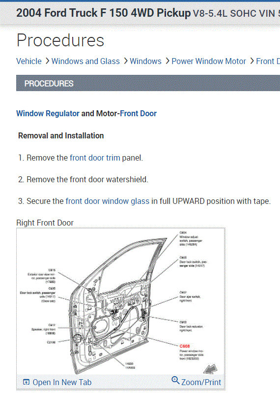

I suspect the driver's front window motor has failed. I don't know if you need them, but pics 2 and 3 are the directions for replacing it.
I hope this helps. Let me know if you have other questions or if there is something I can do to help.
