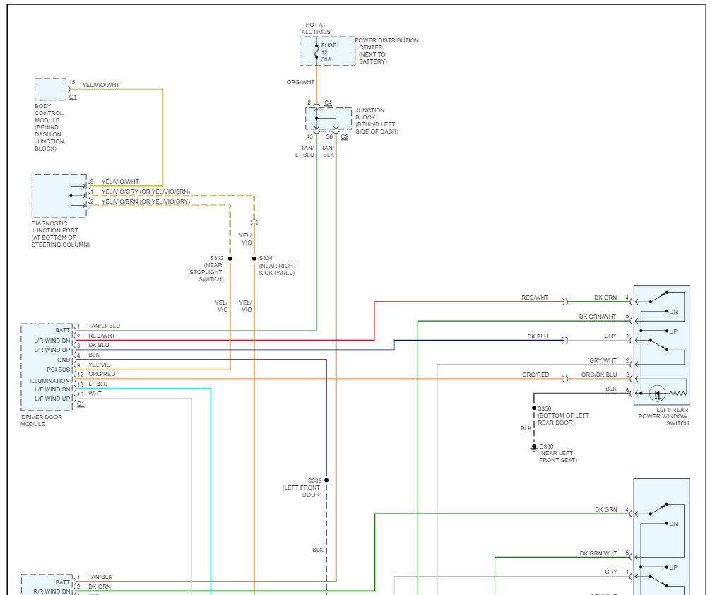

My overhead display I believe called the EVIC module shows the options but next to all of them has a -:-, my dashboards dim switch does nothing and no lights are displayed in the dashboard, and lasty my windows all 4 simultaneously stopped working at the same time. Any idea as to how I can fix this? It's quite unbearable with heat being as high as it is and no a/c to match it.

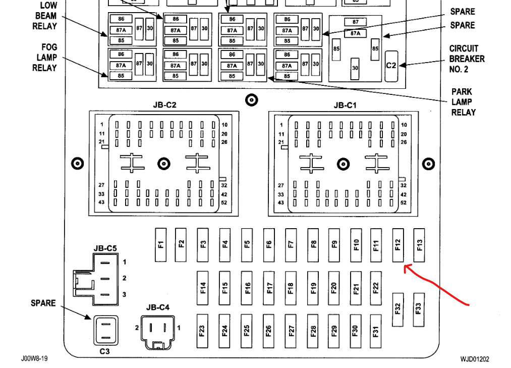

I would start by checking fuse #12 in the PDC under the hood.
Here is a guide to help:

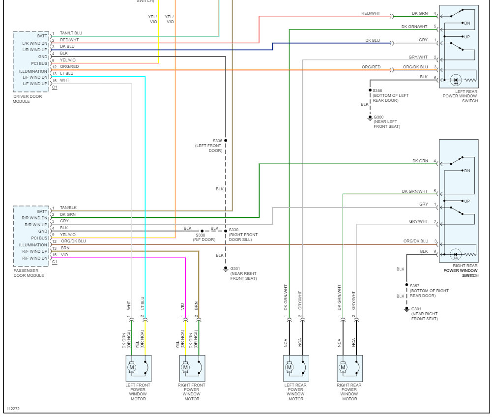

I have included the window wiring diagrams as well so you can see how the system works. Check out the images (below). Please let us know how it goes.
