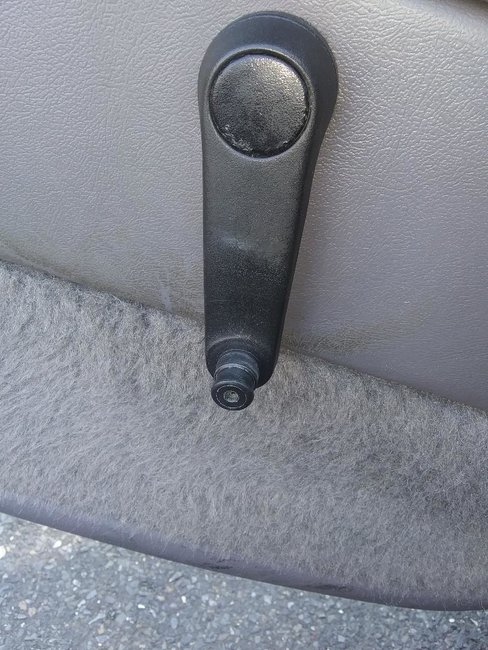

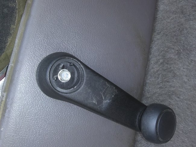

When I roll the window up or down the cap on the window handle keeps coming off and I have to keep snapping it back on. I lubricated the window track but did not help. Please see pictures one with the cap on and the other with the cap off.

Okay, I think I know what I did wrong. here are the two pictures one with the handle cap on and one with it off, it keeps coming off when I roll the window up or down. need to know how I can tighten it. Thanks

That is a plastic handle/knob. Over time, they wear out and are not repairable. In this case, there is nothing you can do to tighten it. The handle needs replaced. Dorman (an aftermarket parts company) makes one. The Dorman part number is 76879 for your vehicle.
I looked quickly and most parts stores can get one for you for around 10 dollars. See pic below. Also, I am in no way affiliated with Auto Zone or Dorman. AZ was the first site that came up and I know and have used Dorman parts for years.
Let me know if this helps.

Instead of wasting $10.00 on a new handle what I will try is too.
switch the whole back door handle with the front door handle, that should hold me over. Ha Ha just when you thought I could not be any cheaper, I fooled ya, !!!LOL!!! Thanks Joe will let you know if it works out.
