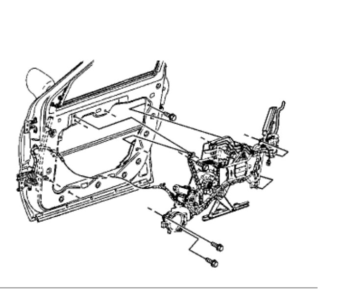

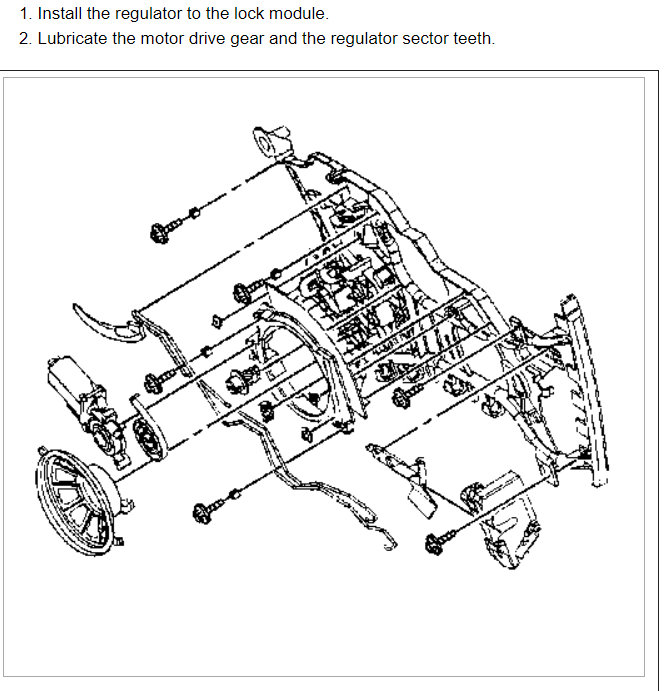

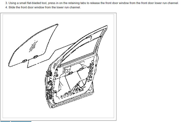

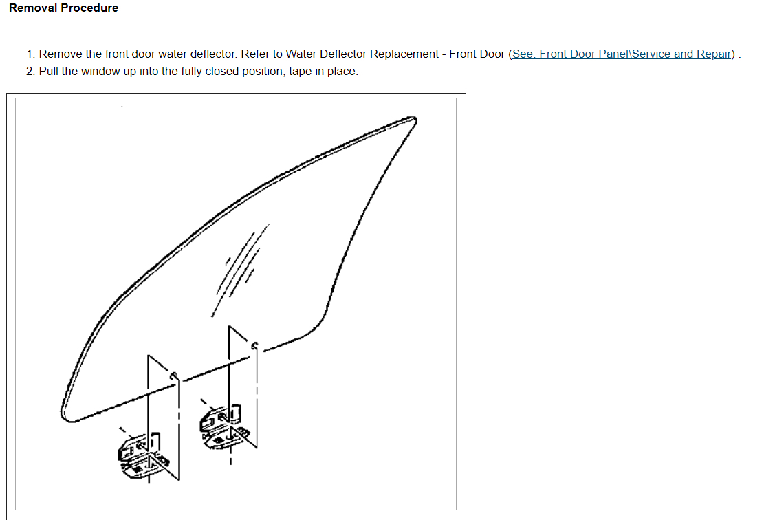

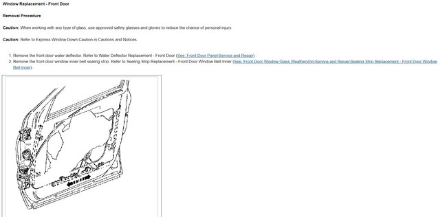

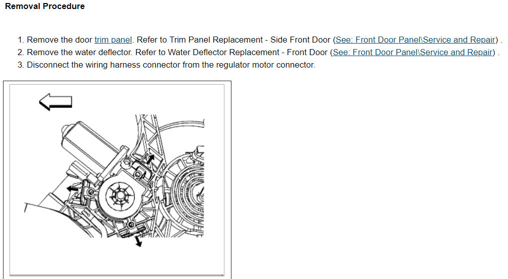

The window was going up lopsided and I removed the door panels. When I looked inside the door I found the guide clips and two black square plastic. I want to know how to replace in the proper sequence.
Apr 27, 2018 at 10:45 AM
  • 55,748 POSTS
I am thinking the regulator might be having a problem allowing the window to dip on one side. Here is a guide and diagrams (below) to help you see what you are in for when doing the job.
https://www.2carpros.com/articles/how-to-check-and-replace-a-electric-power-window-motor
