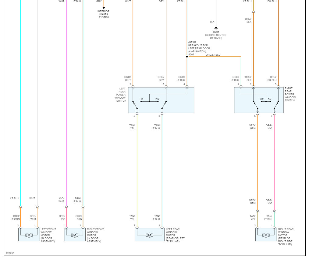

Which fuse (cavity) goes to my power windows? I do not understand the manual, and I need to replace the fuse.
Aug 1, 2019 at 7:35 AM
Good afternoon,

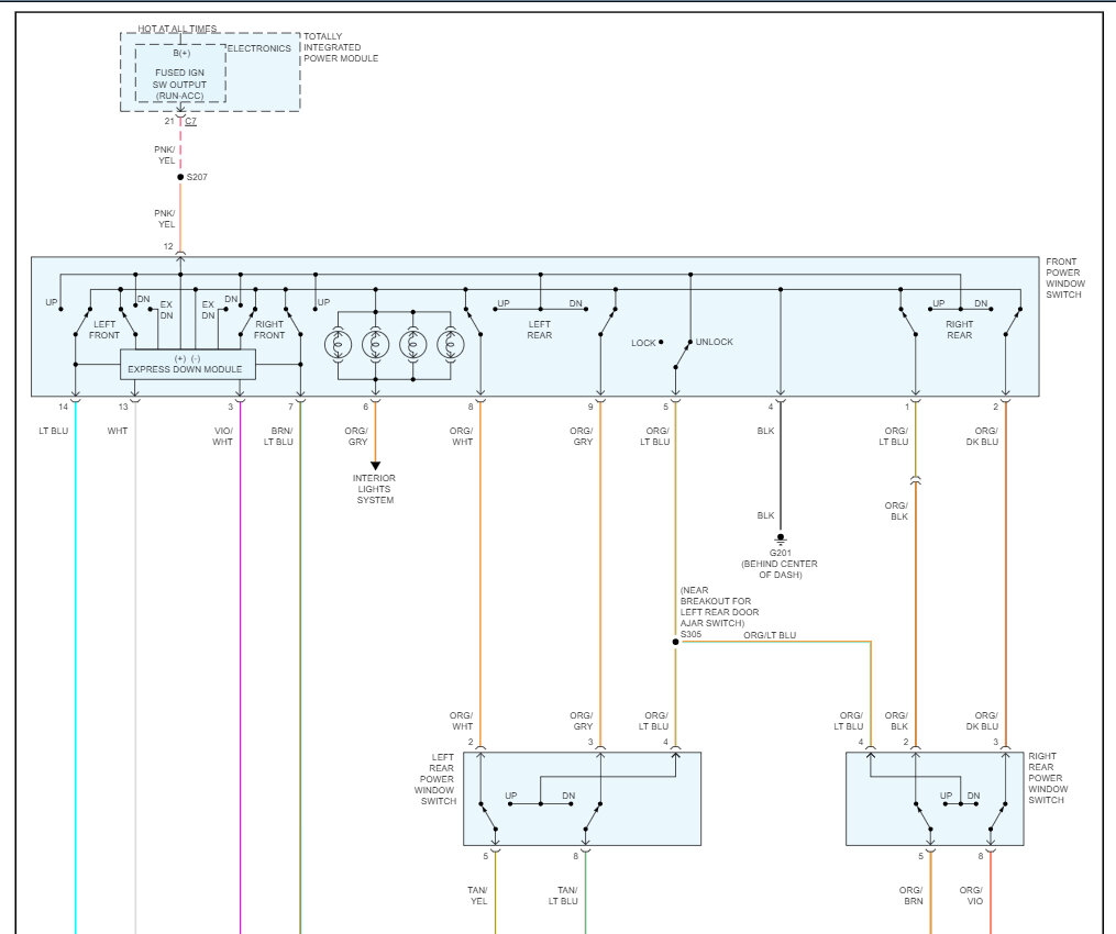

There is no fuse for the power windows. The TIPM or totally integrated power module, which is the fuse box, controls power to the master switch. I attached a diagram for you to view. Check the wire listed at the master switch for power. Check out the images (Below). Please let us know what happens.
Aug 1, 2019 at 8:19 AM
JFO1102

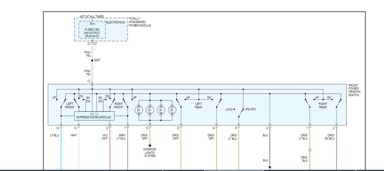

Thank you very much for your quick response! I am having trouble reading the text of the attached diagram as the photo does not enlarge properly on my phone. Are you saying that I cannot fix the problem within the fuse box? How do I fix the problem with all four windows not working? It’s an electrical issue but I’m not sure what to purchase to remedy the issue. Thank you in advance.
Aug 1, 2019 at 9:10 AM
The wire to the master switch on the driver's door needs to be checked for power with the key on. Here is a guide to help and I reloaded the window wiring diagrams so you can see how the system works.
