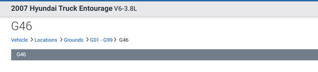

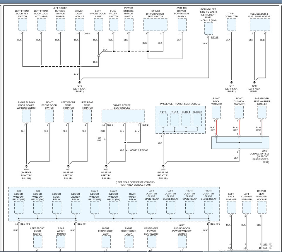

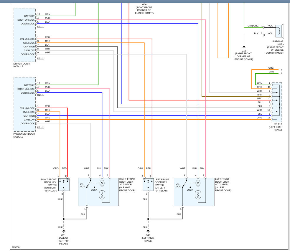

Suddenly all my window and door buttons dont work on driver door except driver window. Also gas tank door button stopped working too. checked fuses and found nothing wrong. But driver side is only window it will control. If I need to remove the button unit I would need some guidance getting it out.
Jan 9, 2020 at 2:55 AM
SCGRANTURISMO
  • 4,897 POSTS

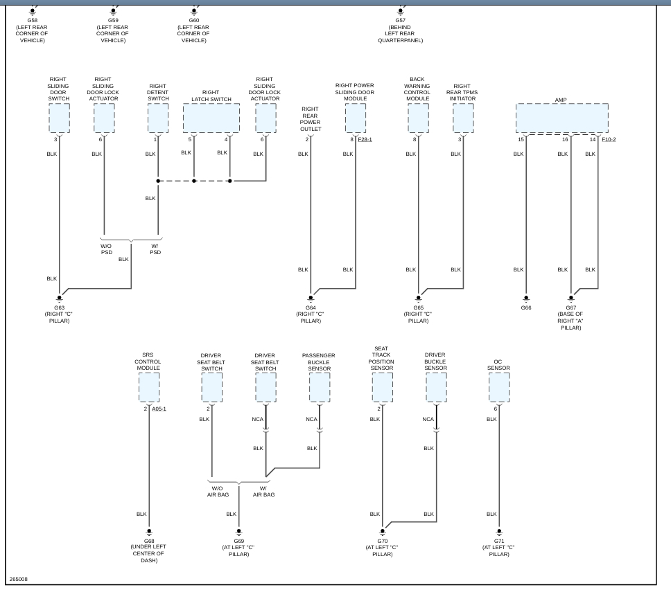

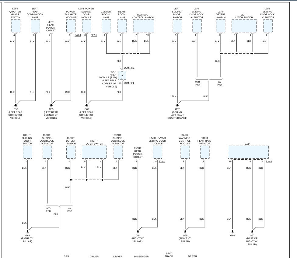

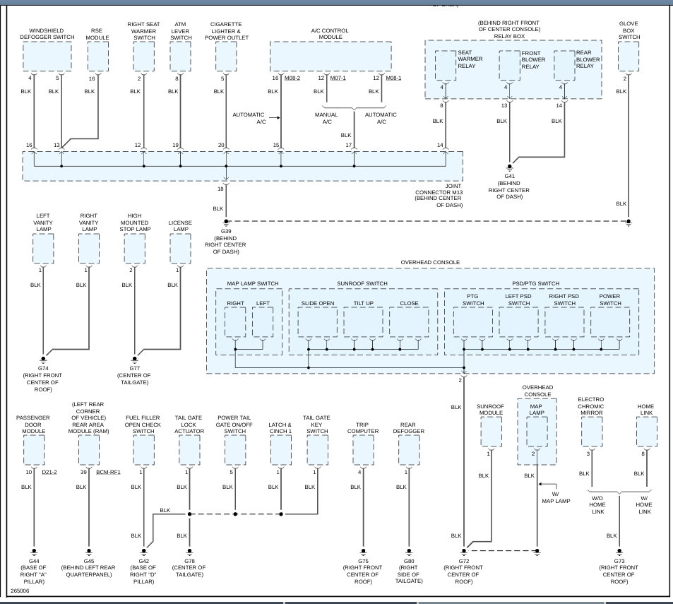

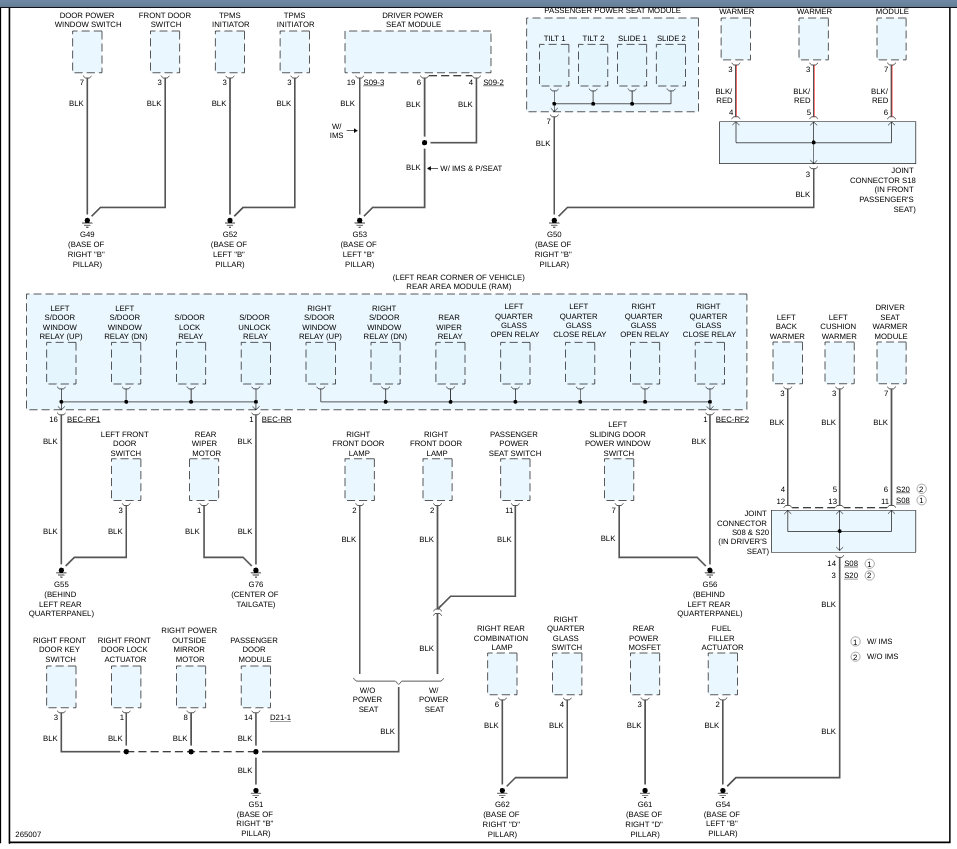

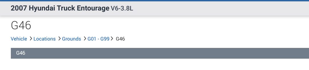

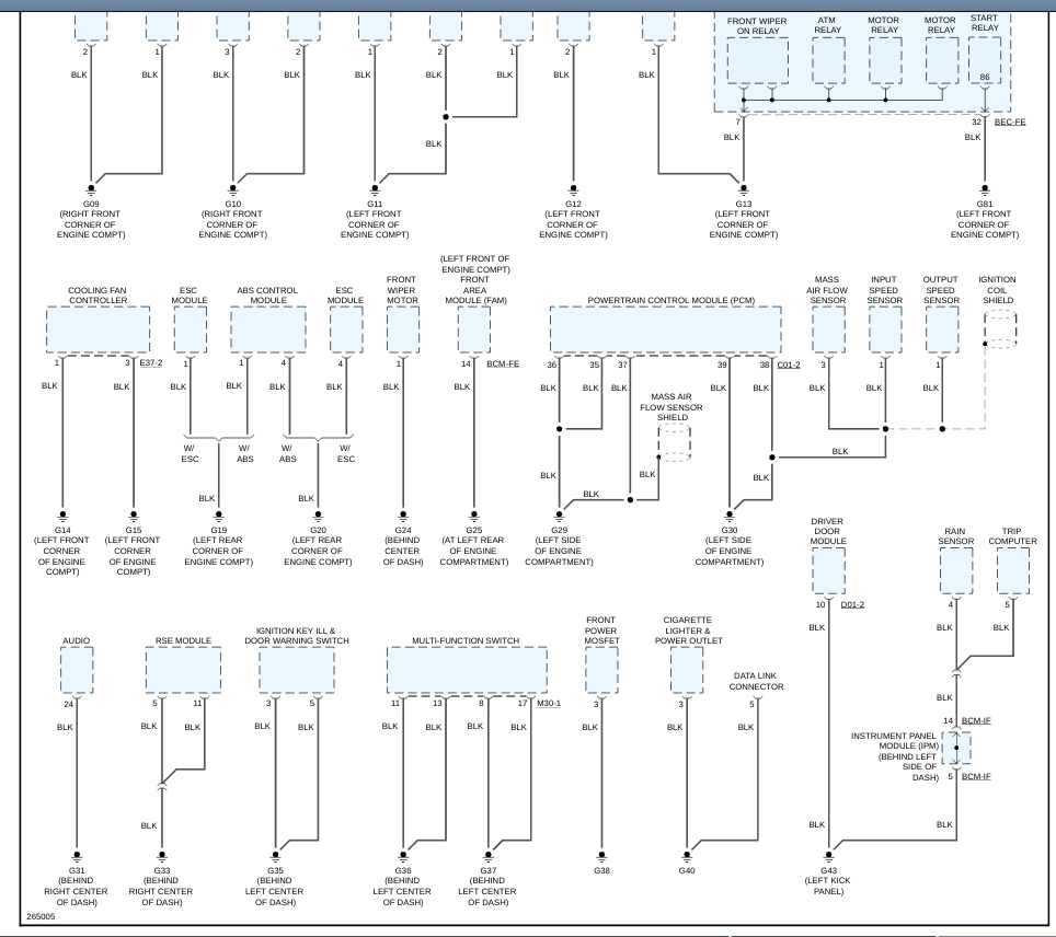

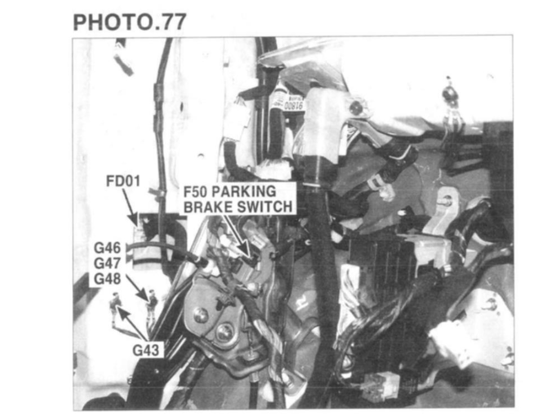

This could be a problem with Ground 46 of your vehicle. In the diagrams down below I have include the ground distribution wiring diagram for your vehicle as well a picture of where ground 46 is located for your vehicle. Please check the ground and make sure that it is clean, tight, corrosion free, and making good metal to metal contact. Please get back to us with how everything turns out.

  • 4,897 POSTS
Hello again,
Yes. 75% of all electrical problems in automotive circuits are going to be ground problems, and all of the symptoms here all point to that ground. Please let us know.

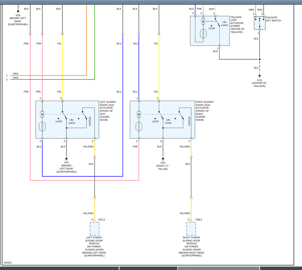

would you know color of ground wire that runs to the main switch on door through the door harness ?
Jan 10, 2020 at 3:28 AM
SCGRANTURISMO
  • 4,897 POSTS
Hello again,

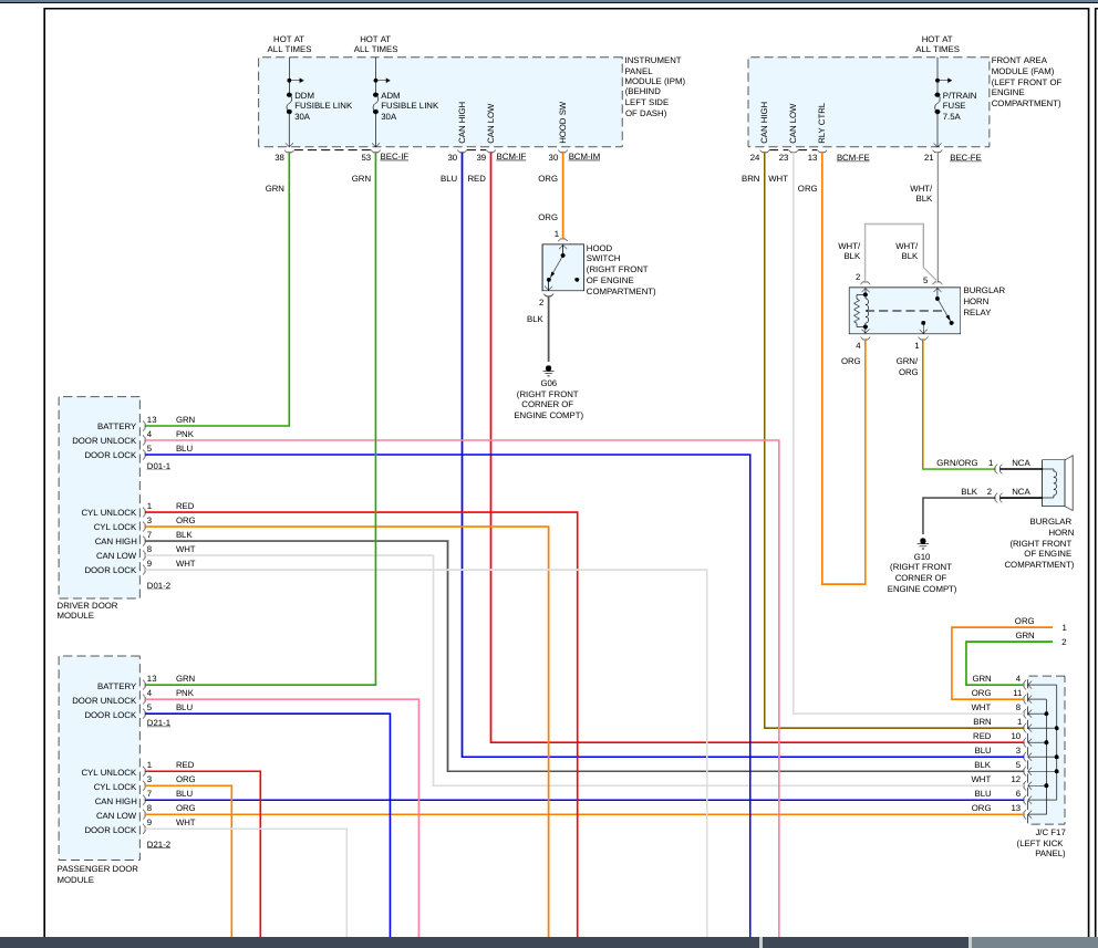

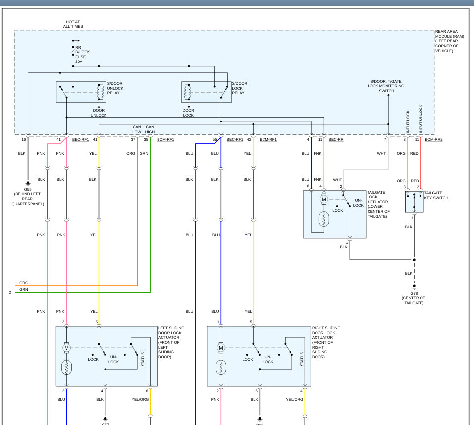

Most ground wires are going to be black, and your vehicle is no exception. In the diagrams down below I have included the power door lock wiring diagrams for you for reference. Pleasego through these guides and report back with what you find out.
Thanks,
Alex
2CarPros
Jan 10, 2020 at 7:26 AM
MWILSING
  • 36 POSTS
Success! Did find ground was a little loose but still didn't work. Decided time to pull door panel and check for power. Found main socket fell out of the unit. Somehow the blue pin that secures it failed. Had to zip tie it into place to keep it in. All is well now. Thank you
