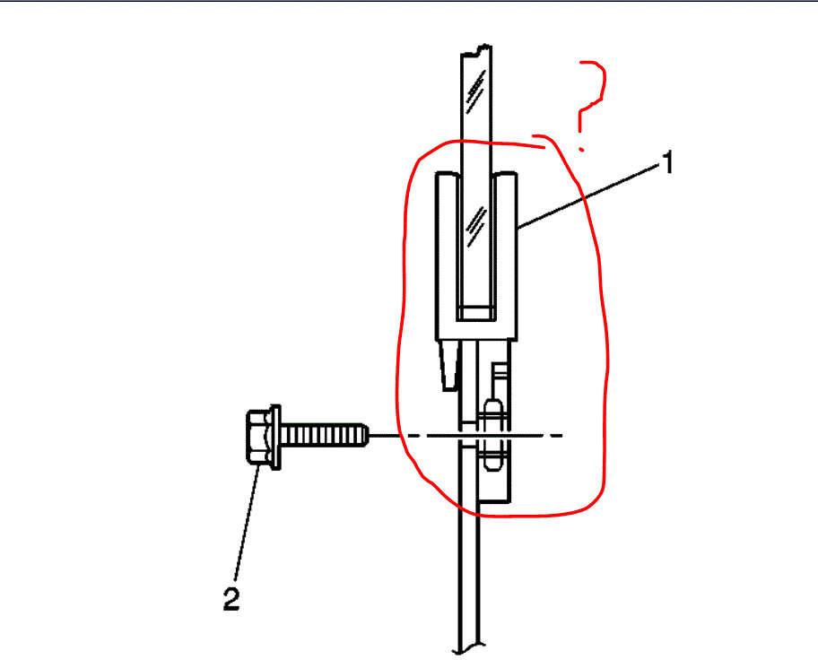

I'm replacing the electric window motor on both windows. The problem I'm having is the window holders that bolt onto the the regulator are plastic and have all broke. I can't seem to locate the part name so I'm unable to order a replacement.
May 23, 2020 at 1:14 PM
  • 110,239 POSTS

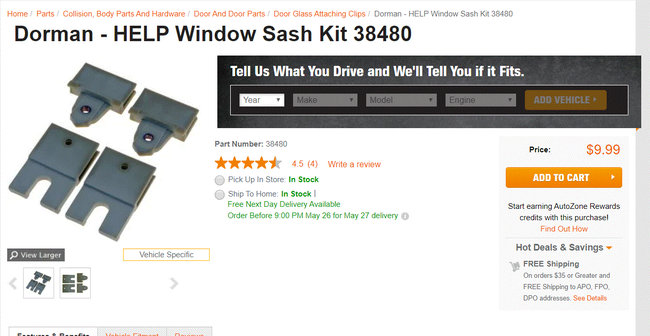

I attached a pic below and circled what I believe you are referring to. If that is correct, they are simply called door glass attaching clips. A company called Dorman makes aftermarket ones. You can get them at any parts store. I attached a pic that shows the part number and price.
Let me know if this is what you needed.
May 23, 2020 at 3:40 PM
TRAVIS RIDDLE
This is exactly what I needed. Thank you very much!
