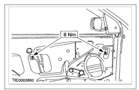

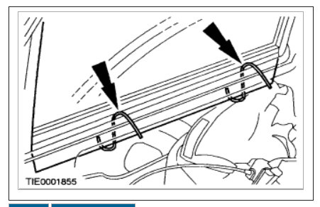

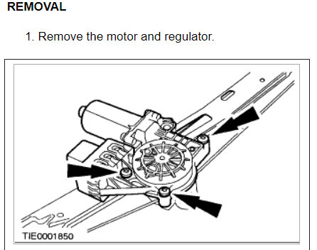

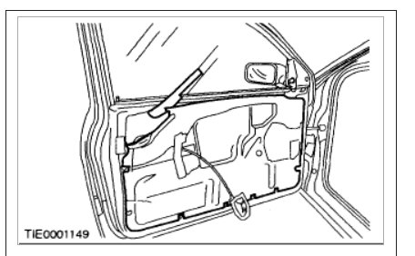

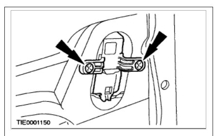

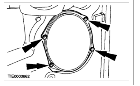

Hi, I have a new window actuator to replace, I have got through most of it but I am having trouble removing the window from the old actuator. The white clips mounted on the window will not unclip/pry-off/slide off from the black clips on the old actuator.
Please help. :)

Here is a guide to help you see what you are in for when doing the job:
https://www.2carpros.com/articles/how-to-check-and-replace-a-electric-power-window-motor

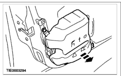

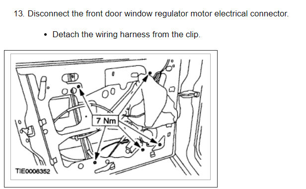

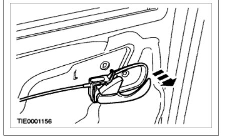

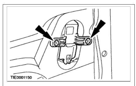

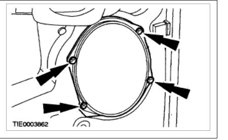

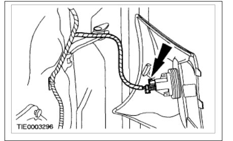

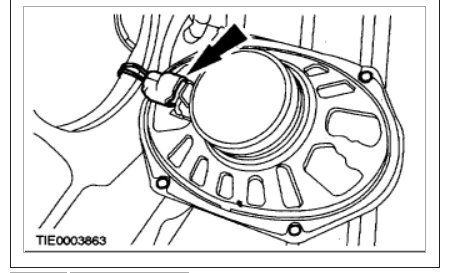

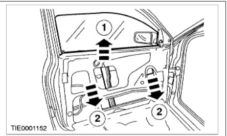

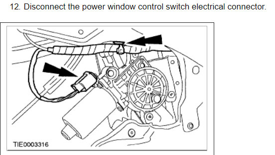

Please send pictures or videos of what problem you are having. Here is how the book says to do the job. Check out the diagrams (below). Please let us know if you need anything else to get the problem fixed.
