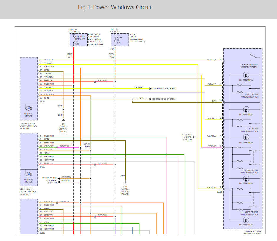

My window is down motor won't work. how do I test my motor when it has ten wires on it?
Mar 4, 2019 at 11:35 PM
  • 55,433 POSTS

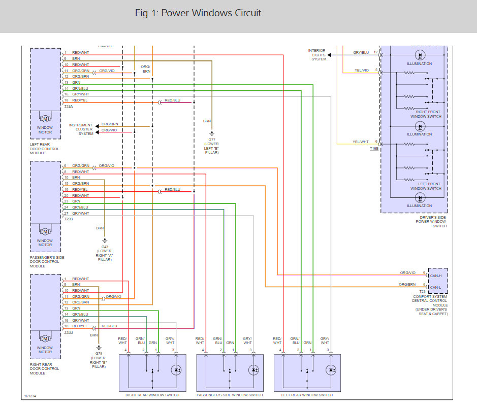

See if you have power at the red and white ring. Here is a guide to help you and the window wiring diagrams so you can see how the system works:
Check out the diagrams (below). Please let us know what you find.

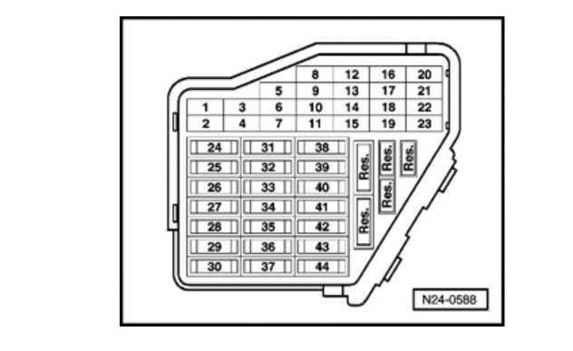

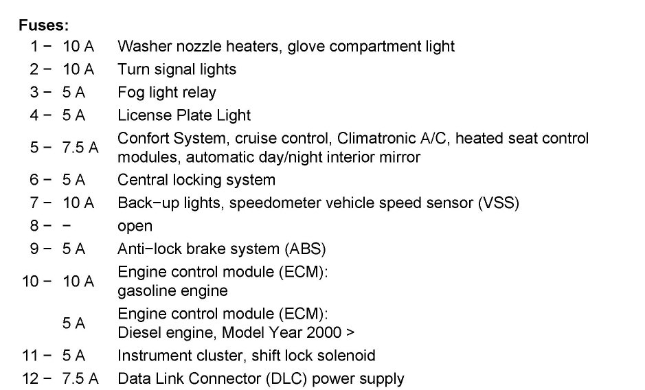

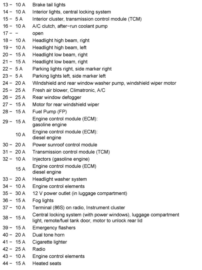

Can you check for power at fuse #38. here is a guide and the fuse location:
