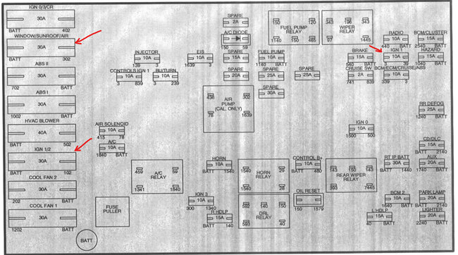

I would start by checking the fuses: IGN 1/2 and window/sunroof which are under the hood.
Here is a guide to help:

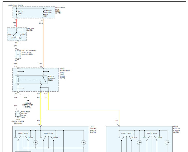

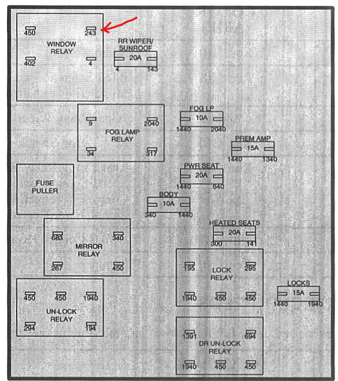

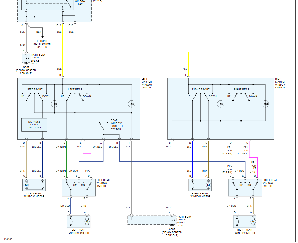

If there are okay the system is run by a power window relay which is in the fuse panel inside the car, here are the locations to help you as well. I have also included the window system wiring diagrams so you can see how the system works. Check out the images (below). Please upload pictures or videos in your response of any problems so we can see what to help you with.
