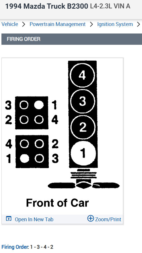

ASHEA7647
What is the order? I need to put the spark plugs back on in the correct spot.
Apr 30, 2025 at 10:58 AM
ASHEA7647
Does anyone have a diagram of the spark plug wiring? I changed the coil pack and it’s still not firing.
Apr 30, 2025 at 12:23 PM
  • 55,421 POSTS
Here is the firing order, you may have a bad ignition module or crankshaft angle sensor. Also, check the fuses with the key on. Please go over the guide above as well. Check out the images (below).
