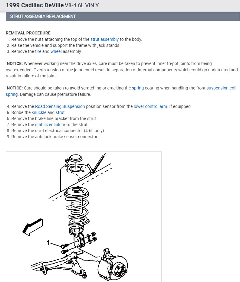

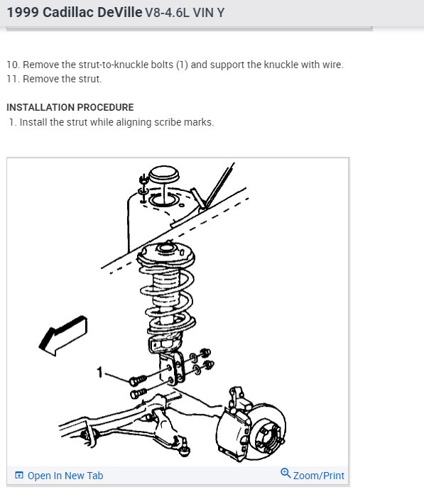

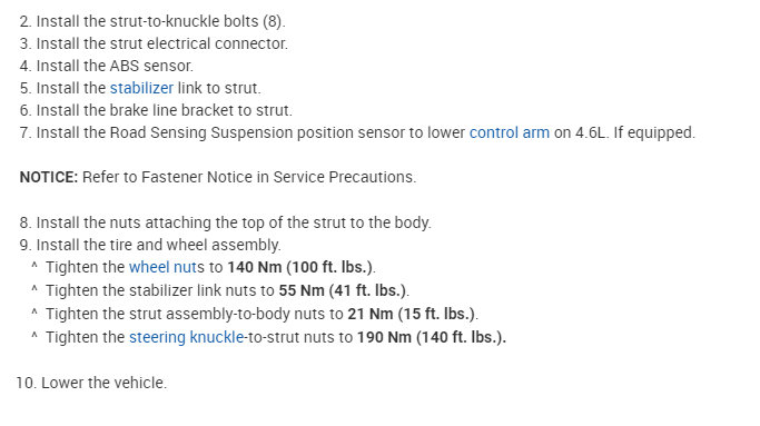

Will the struts off of a 2003 Cadillac interchange with my 1999?
May 8, 2022 at 4:44 PM
SQM
  • 6,383 POSTS
The 2003 and the 1999 struts are not interchangeable.
1997-1999 has the same struts and the 2000 - 2005 uses the same setup, depending on the factory options.
https://www.2carpros.com/articles/how-to-replace-a-suspension-strut-and-spring
I have attached diagrams below for your reference.
Let me know of any questions.
