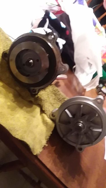

Trying to figure out if the replacement water pump I have will work on my car. Can't seem to find/Locate a part number on the actual GMB water pump I have to replace old pump. So trying to locate the info and see if this new GMB pump is compatible with my car. I have a 2004 crown victoria police interceptor with a 4.6L V8 and a W in the vin#. The pumps look diffrent and only numbers on the new GMB pump are (C19130-24BR L) (F75) and a the number 6 over a 13 in a small stamp on the side.

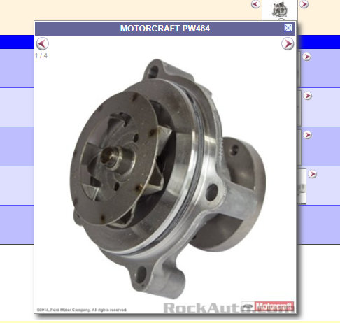

That is a casting number, not a part number.
Go to
https://www.rockauto.com/en/catalog/ford,2004,crown+victoria,4.6l+v8,1424854,cooling+system,water+pump,2208
https://www.rockauto.com/en/moreinfo.php?pk=385030&cc=1424854&jsn=453

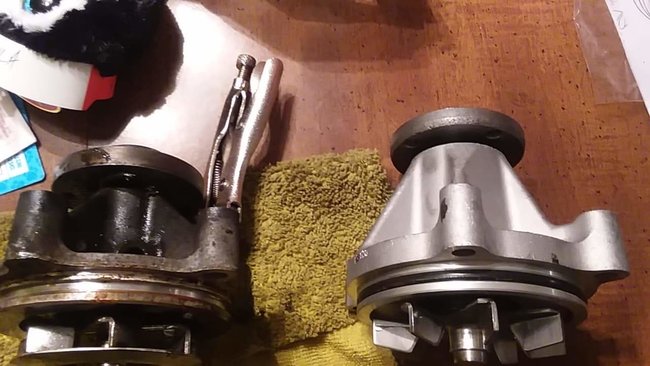

I appritiate that info. I have looked at pumps from diffrent places that will work like that one but im still trying to find out if the GMB water pump I have (will) or (will not) work.
Jan 26, 2019 at 5:02 AM
Thanks for the pictures.
No, it will not. the nose is too long and the serpentine belt will not line up correctly.
