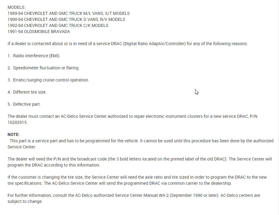

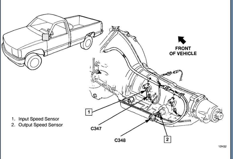

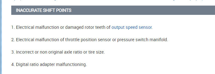

It is possible. I attached some info on this. However, the more likely cause is the output shaft speed sensor not functioning properly. So did the new unit come with new speed sensors?
Let's also check and see if you have any codes and we can go from there.
