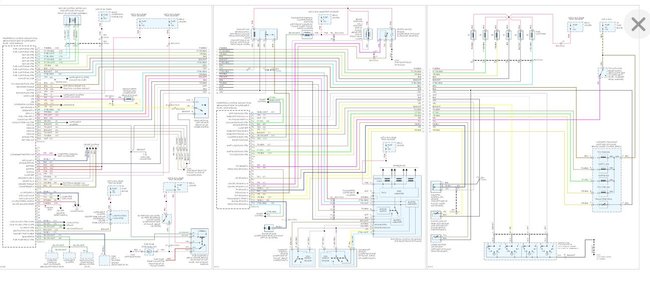

Will start with either, will run won't start without either. Fuel pump works ,getting spark, new battery. Cranks won't start.
Sep 23, 2019 at 6:35 AM
Good afternoon,

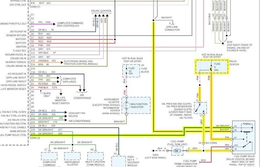

If the car runs with starting fluid, and the fuel pump runs, you either have a bad fuel pump, ECM or wiring issue.
You need a noid light to hook on 1 injector to see if the ECM is commanding the injectors to fire.
Chances are, you may need a fuel pump.
Does the check engine light work with the key on?
I attached a wiring diagram for you to view of the fuel pump.
