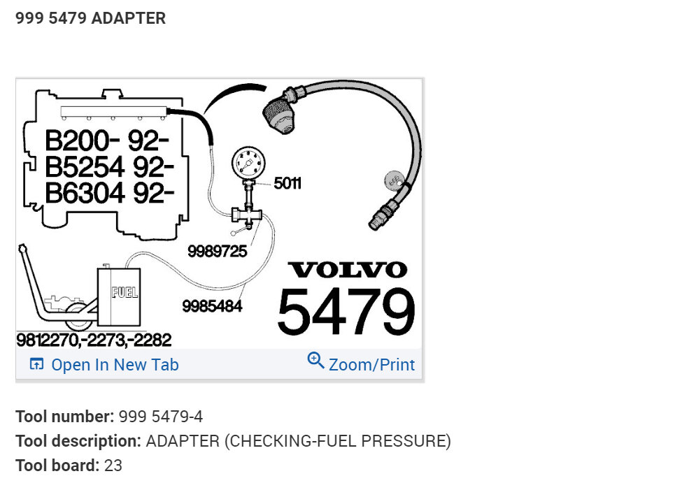

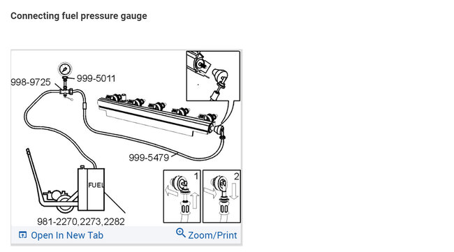

Hello, before replacing any more components, if you are concerned about a fueling issue, and I have personally experienced some issues on Volvo's and the fuel systems. I would do a fuel pressure test to verify that the pressure is staying where it should at all times, meaning under a load when the vehicle is in drive, but you have your foot on the gas, which will put a small load on the engine. With these systems, if I remember correctly, you have to T into the fuel line going to the Fuel Rail where the fuel injectors are. I'll put a diagram showing this.
Another thing is if you want to try to maintain your own vehicles, you will want to buy a scan tool, even a basic one that can read engine computer diagnostic codes and show you live data from the engine while running. This is a huge help to see how the vehicle is reacting. I will post more information here for you in a minute.

If I am unable to get a fuel pressure test reading while under a load, will it prevent a reliable diagnosis?

Yes, you can get some Bluetooth type scan tools, but I recommend something like this one from Harbor Freight (4th pic). It is $99.00, but you can find cheaper ones on amazon, just as long as it says "can read live data". You don't want just a code reader. The live data is where you will be able to give us some numbers from the data and we can help you far more, knowing what the engine computer is actually doing. Sorry for this long post, but I wanted to help explain how a few things work.
With a basic scan tool that can give you live engine data; you really don't even need to take a fuel pressure reading at first. There are ways to see if the engine is running lean or rich just by live data. For example, the computer data will have data Pids (Parameter IDs) such as Long Term and Short-Term fuel trim. Or it will give readings from an Oxygen sensor, coolant temperature sensor, intake air temperature sensor, etc. Picture 3 below is an example of a few data Pids. You can see the Short Term B1S1 reading -3.9% there. That is the fuel trim from Bank 1 Sensor 1 oxygen sensor and its reading -3.9. So, the engine computer is reducing fuel from the air fuel mixture by 3.9 percent on Bank 1. This means Bank 1 is running a little rich and the computer is compensating for it.

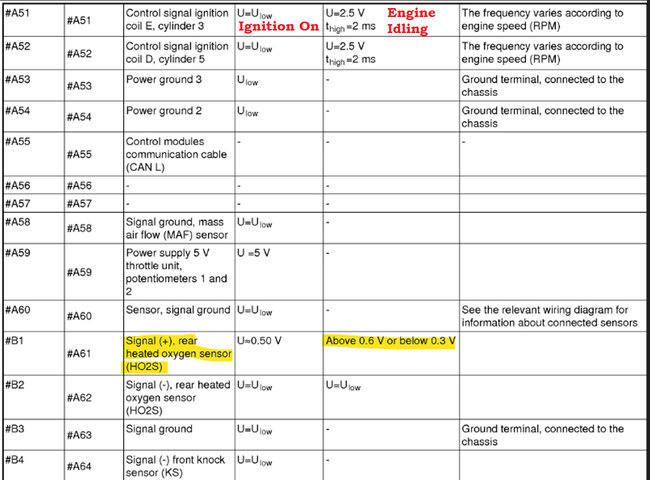

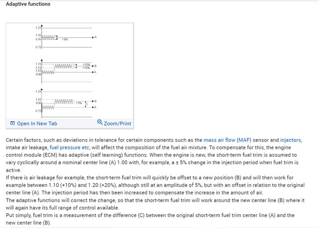

Now from what I have seen Volvos do, they rely heavily on fueling parameters. I had a Volvo that had its rear Oxygen sensor voltage that was stuck reading full rich. The vehicle would not run at all, it would start and stall, maybe run a little bit then stall, huge lack of power. But this was all because the computer was compensating for a condition that did not exist. It was just a faulty reading. So, you can see how a simple obd2 scan tool can help in a huge way instead of changing a ton of parts. Granted the fuel filter and pump may have been on its way out. A restricted filter will ruin a fuel pump.
Having said all that. I do believe you have a fueling issue. Because of your comment about filling the tank. This has to do with the Evap system, but that is a whole other system to explain.

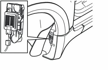

Hello, I just wanted to jump in. Is this a turbo or none turbo engine? If it is turbo, I would inspect the charge air pipe. The black plastic hose that goes over the cam cover. If it popped out at the turbo side or at the charge cooler end, it would cause your symptoms of no start and give it gas to try and keep the engine running. This will also most likely set an engine light.
Another issue I saw at Volvo was the fuel pump modules getting corroded. We hardly saw them here in California, but in areas with snow and lots of rain it was an issue. The fuel pump module, if it has not been updated, is located behind the wheel well on the rear right (passenger) side of the vehicle. If it is still there inspect the connector pins and module pins for corrosion. The updated repair at the time was a new fuel pump control module and splicing in a new harness. The new location to place the module was under the rear seat.

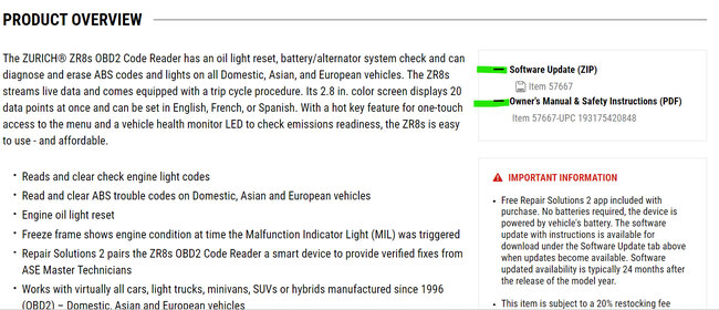

I noticed this, on their Harbor Freight site, they have a manual you can download which will help you a lot understanding the tool. And there is also a software update for it, but i haven't checked into it yet, but I will. Looks pretty decent. Make sure the key is off before hooking it up and then key on engine off and it will start communicating with your vehicle but do still check the fuel pump module. Jorge worked for a Volvo dealership, so he will know what issues were seen the most.

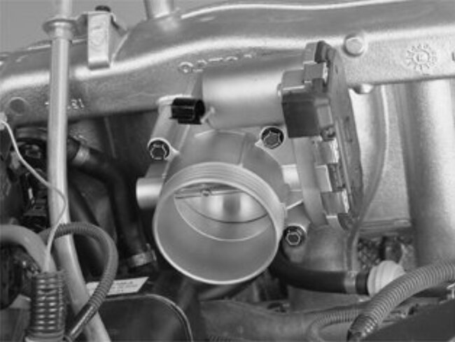

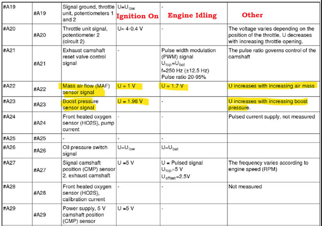

Okay, that gives us some direction, since it's a circuit code we can do some testing with a multimeter, and also in live data there should be a data Pid about the mass air flow sensor, such as its grams per second (g/s), its voltage reading at idle and off idle as well as see what the other sensors are doing because of a faulty mass air flow reading. I'm not saying the sensor is bad since you mentioned already replacing it. This is a circuit code, meaning the engine computer (ECM) is seeing either a voltage or frequency discrepancy depending on how this MAF signals the ECM. The first thing to do, when you get time, is to inspect the MAF connector. Make sure there's no corrosion in the connector or loose pins. We can go over this tomorrow when you have time, I'll pull up the wiring diagrams for the MAF and see what it should be getting for a voltage supply and ground. You mentioned a solenoid you replaced; do you remember which one it was?
Also check the throttle body, make sure the throttle plates look clean around the edges where they touch the throttle body, you don't have to move the throttle plates. You should be able see if there is carbon build up by just taking the air intake tube off.

The throttle body is at the opposite end of the MAF, correct? That would put it fairly low behind the center of the engine. If I'm going to inspect that, is it easier to put the vehicle on some jack stands and go from the bottom or disconnect/dismantle things until I'm able to get to it?

Yes, the throttle will need to be accessed from the bottom. Warm up the engine to soften the plastic pipe over the throttle. Will make it much easier to remove and install. If you try to install it when cold, the plastic gets very hard and very difficult to install back.
If there is oil/carbon build up the PCV system could be plugged up. Now I wouldn't think that would cause your original concern with the hard start and running rough. A defective Mass Air Flow sensor could do that. Are there any other codes that posted besides the P0101? Maybe fuel trims codes like a P0171 or P0172? Vacuum leaks will also cause that issue with P0101.

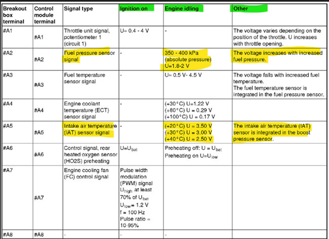

I'm still here too, we're working together on this to help you get it resolved. When you go to look at live data, write down the long term and short-term fuel trims when the engine is cold and when it gets up to temperature. Also monitor what the rear (or sensor number 2) Oxygen sensor is doing. It will be a 0.100 to 0.900mv reading. If it is stuck at either end such as 0.900mv which is almost 1volt or closer to 0.100mv write that down. Also, with the fuel trims since you are most likely just going to be looking at it in the global obd2 side it should just give you a percentage. A positive number or negative, but in case it reads a different fuel strategy, here is the service info on your vehicles Adaptive Functions (page 1).
And pages 2 to 4 are some data PIDs to look at.

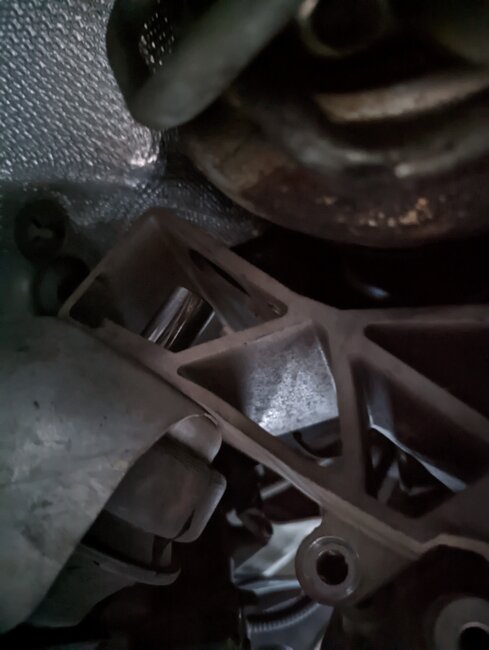

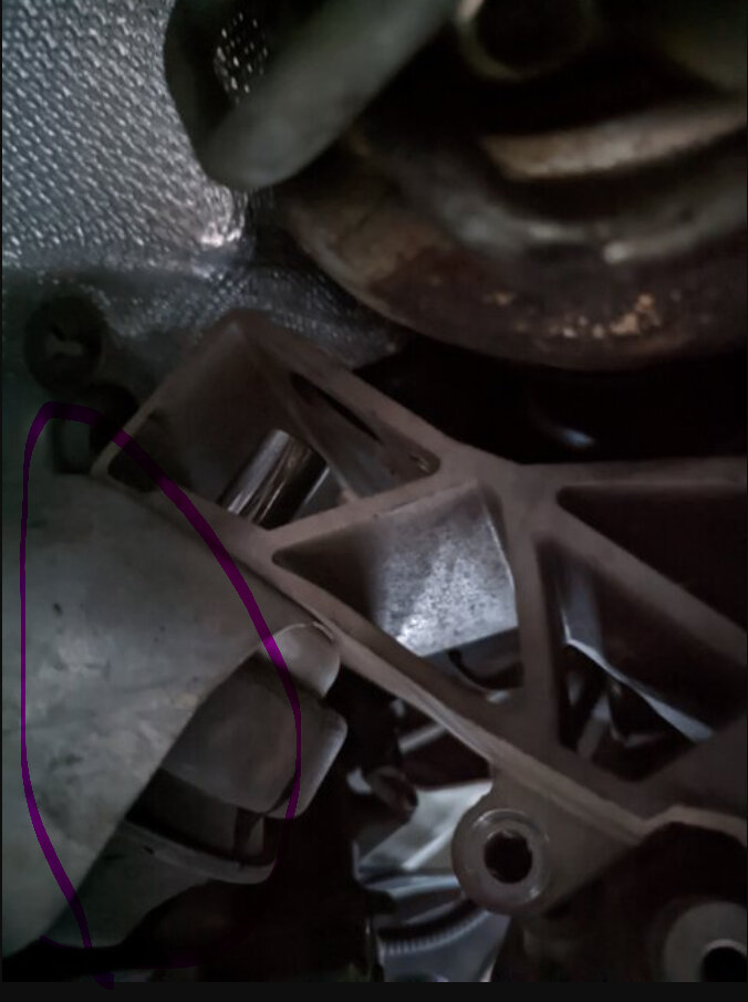

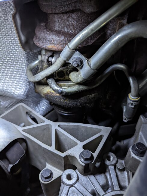

In order to get to the throttle body, I thought I should remove the bracket in front of it. I removed 2 of the 4 bolts when something (heavy and over my chest) shifted. I'll probably need to use a jack to get it back into position to put the bolts back. I didn't feel comfortable proceeding with out checking with you two. Also, since I haven't been able to start it I was going to use a heat gun to loosen some of the rubber. Is that cool?

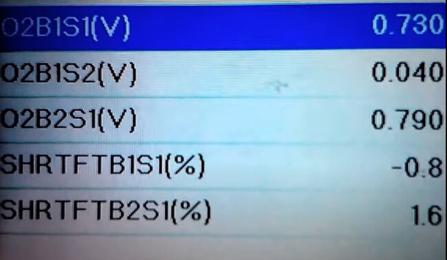

I have been unable to get my vehicle started since I bought the OBD2 scanner. Therefore, I can't give you warm numbers. I was only able to get the following readings that y'all requested.
STFT B1 0.0%
LTFT B1 0.0%
STFT B1 S2 99.2%
MAF 0 (lb/min)
Would the fuel status and rear oxygen be under a different abbreviation?

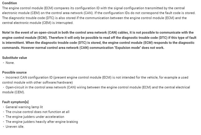

Lastly, I'm getting an additional code of
U0073 Control module communication Bus "A" off.

I believe that the "heavy thing" that shifted was the transaxle. If I can't inspect and clean the throttle body, I may be in over my head.

The picture you posted was the turbo? And yes, you may have moved the transaxle mount bolt. I think maybe you should tow it to a shop. If it is not starting, I would recommend that you look at the fuel pump control module as previously recommended.

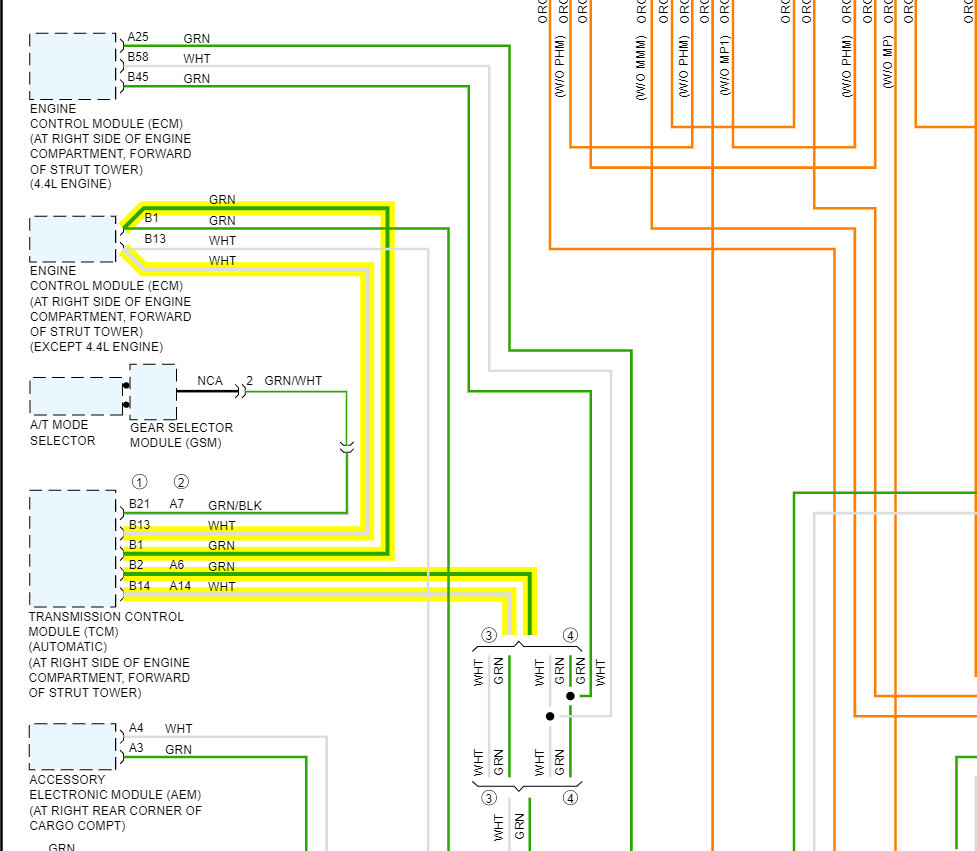

In the second picture, are those the two bolt holes that you removed? If so, to the left there looks like an engine mount to me. Here's a picture of the throttle body, if it was part of the transmission/transaxle that moved, I think you may have pulled the wiring harness apart, the code you're getting (U0073) is a network no communications code, it's probably why your scan won't communicate either. If the CANbus network, which is a 2-wire network, either shorted out together or both shorted to ground it would take the whole network down. Try to get things back together first, you may have to put a jack under the transaxle to lift it into position to get the bolts back in. Also check for any wiring harnesses that either got pulled apart or if any connectors were pulled apart. I'm pretty sure you're going to find a damaged harness due to the new issues you're having.
The third diagram is the info on the CANbus A network, and the fourth diagram are the two wires for the network (green and white).

I believe that I can get the bolts back in. The photo was taken while I was on my back looking up.
