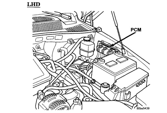

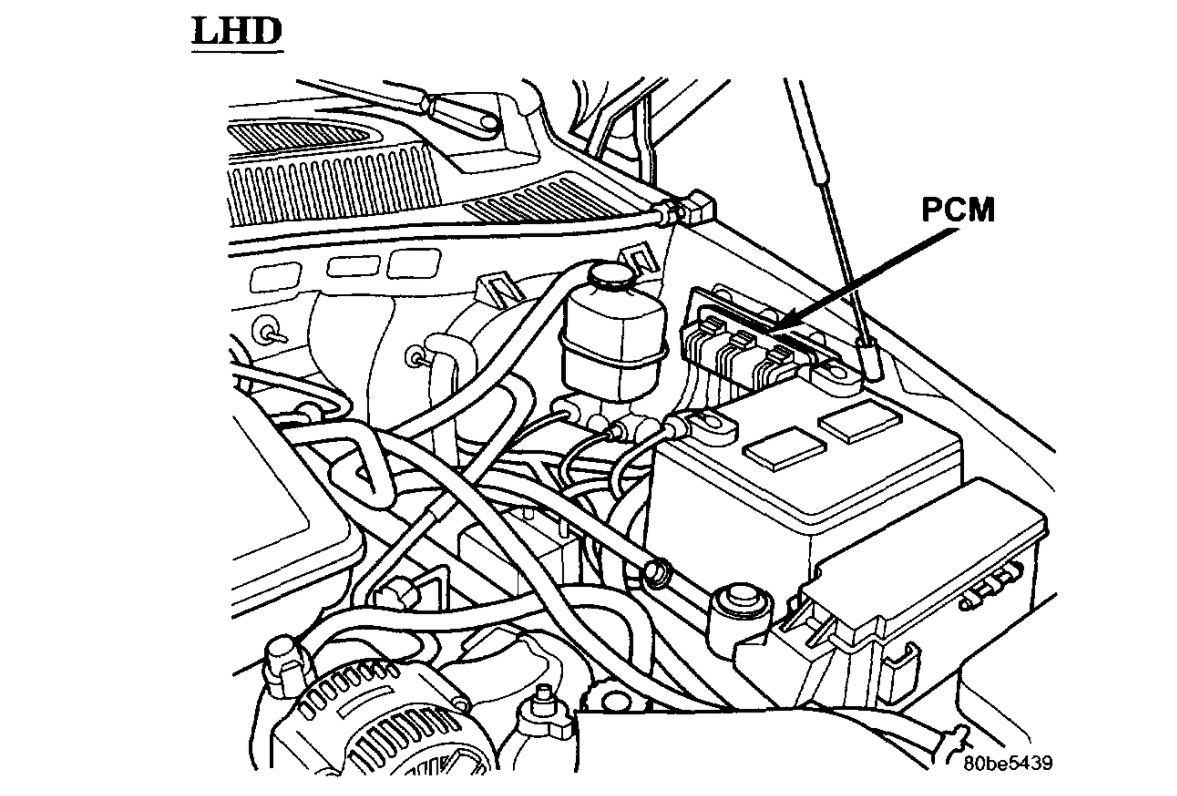

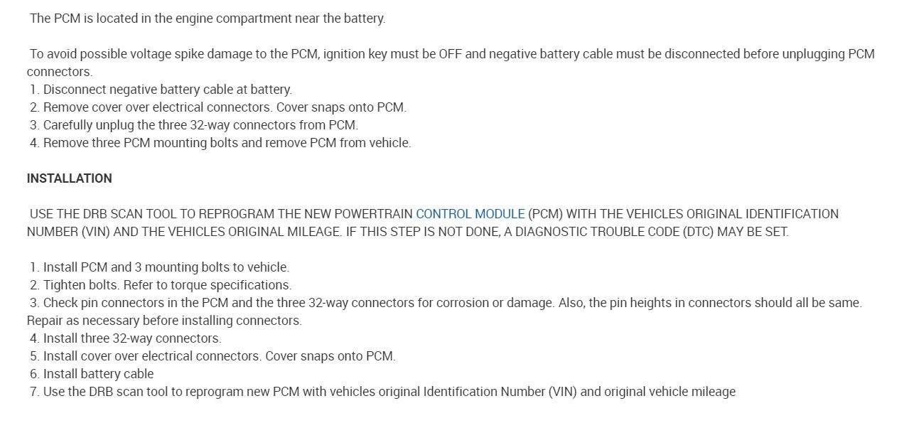

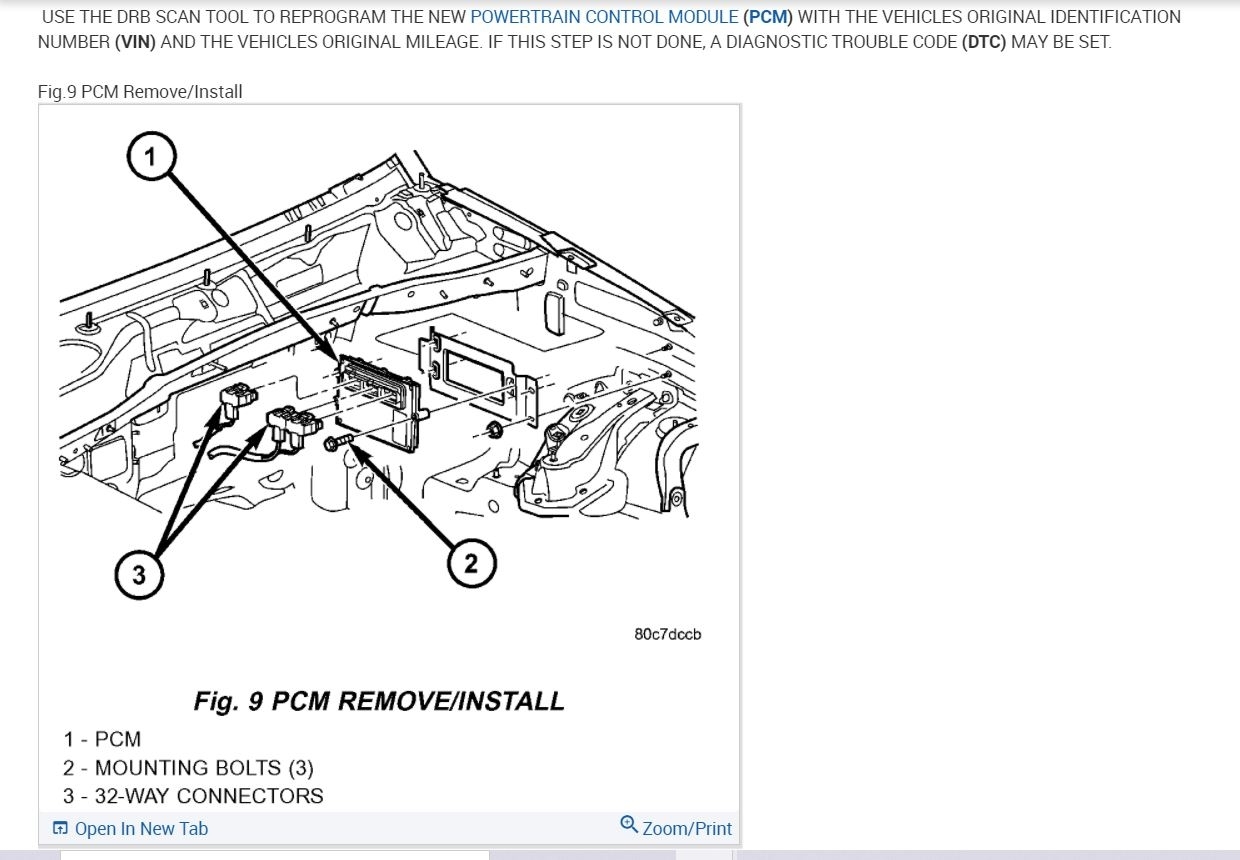

This is a failed ECM. The keep alive memory inside is not working so when you turn off the key, it forgets all the monitors being set.
You need a new ECM, and it is programmed to your car.
