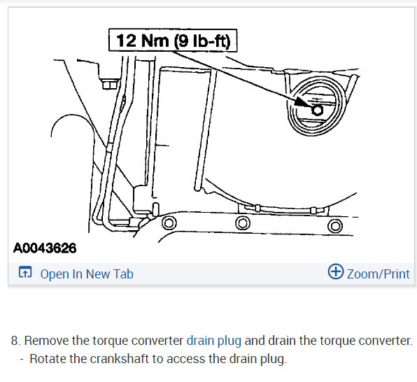

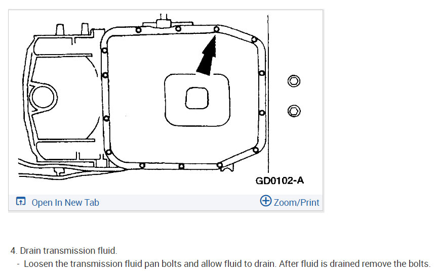

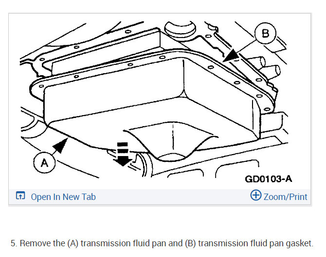

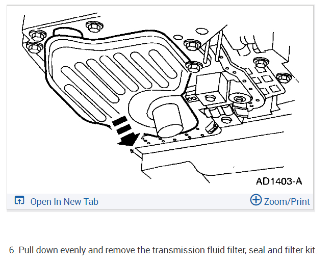

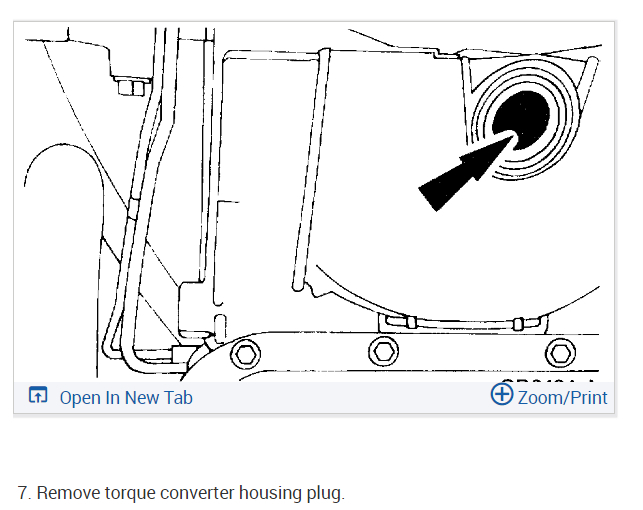

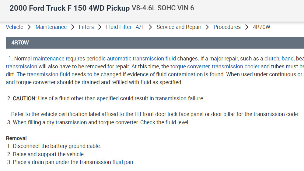

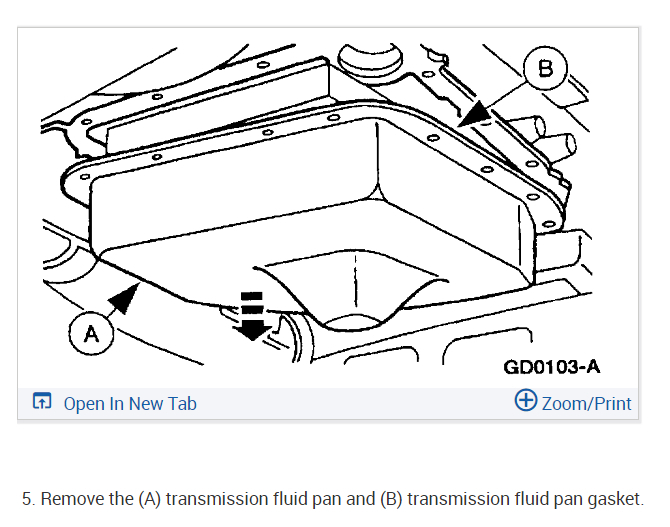

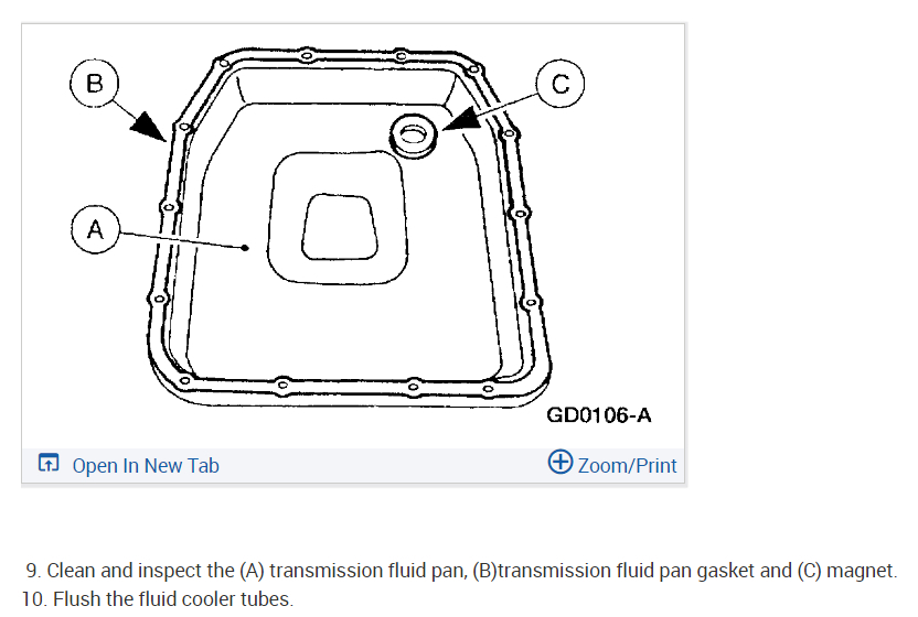

Did you check the transmission fluid? And if so, please give it a smell to see if it has a burnt smell to it. If it does smell burnt a transmission service may help it, we should run the codes as well. These guides will help, and I have included the instructions for your truck in the images below.
and
Fluid Types
Transmission Fluid Type
4R100 .................... MERCON V
4R70W .................... MERCON V
MERCON ATF is being replaced by MERCON V ATF as a service fluid, per TSB 06-14-4.
Capacities
Transmission Fluid
4R100 .................... 15.5L
4R70W .................... 13.1L
Note: Approximately Dry Fill Capacity
