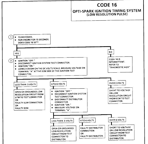

It will run really rough for maybe a minute (if I give it gas, it won't stall), then start to stall out. I've replaced the opti,icm,coil,wires,plugs,injectors,fuel pump, fuel filter,fuel pressure regulator, and water pump. This was a project car that wasn't running until I replaced the injectors. So it sat awhile, and now it's stalling..
I do have 40 PSI at the fuel rail. I have also removed the TB and cleaned it, as well as the IAC, which didn't help. I checked for codes and I’m getting h16, and following the fsm, I went through the code 16 flowchart and measured the voltage on terminal A at the ecm side of the ignition test connection, which is on the passenger side near the fuel rail. I got only 0.04 volts, indicating a faulty ecm, ecm connection, or an open or grounded low resolution from the ecm to the test connector.
Did I do this correctly? Would the car still run with a faulty ecm? Also could fouled spark plugs cause this?

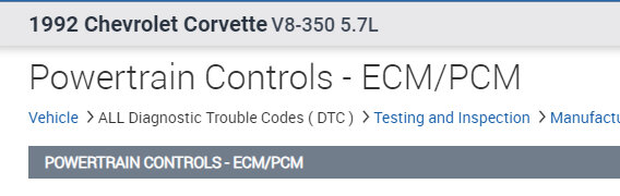

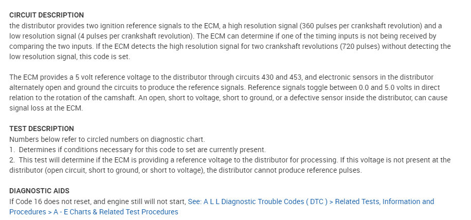

I watched the video, but for some reason, there was no sound. As far as the issue, yes a faulty ECM can still run an engine. The ECM is responsible for multiple things. It really would matter what has failed internally.
As far as the diagnostics, take a look below and let me know if that is what you did. Keep in mind, if it sat, there could be corrosion at the connectors.
Sep 28, 2023 at 2:24 PM
R6VETTE
  • 11 POSTS
Yes, the 2nd picture is correct. I’ll do another video of the car and follow the flowchart again.

flowchart.
Sep 28, 2023 at 11:36 PM
R6VETTE
  • 11 POSTS
2nd part.
R6VETTE
  • 11 POSTS
I can rule out a defective connector. When I installed the new opti, I purchased a new one, however using the OEM connector to replace it still causes problems. Are you still interested in seeing it run and stall?
