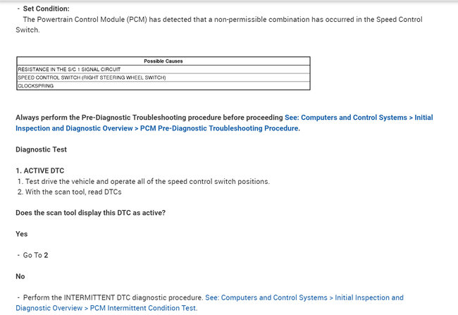

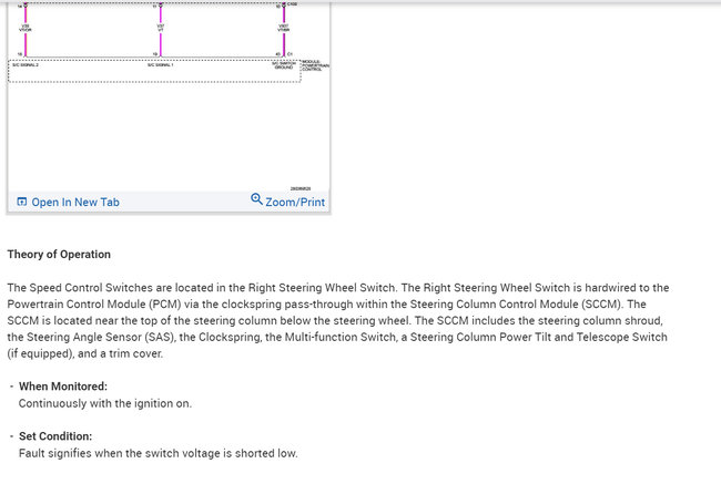

Driving down interstate in cruise control vehicle shuts pff. Will start if pedal is pushed halfway down but will not idle. Check codes p0306, p0579,p0592.
I have fuel pressure of 58lbs.
Not sure why it won't stay running unless I have it at 1500 rpm's.
Mar 21, 2019 at 5:33 AM
SCGRANTURISMO
  • 4,897 POSTS

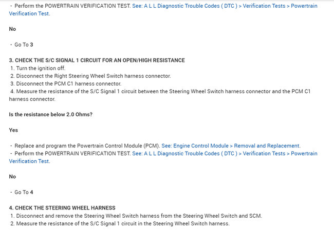

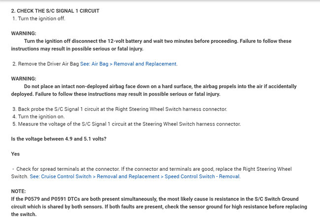

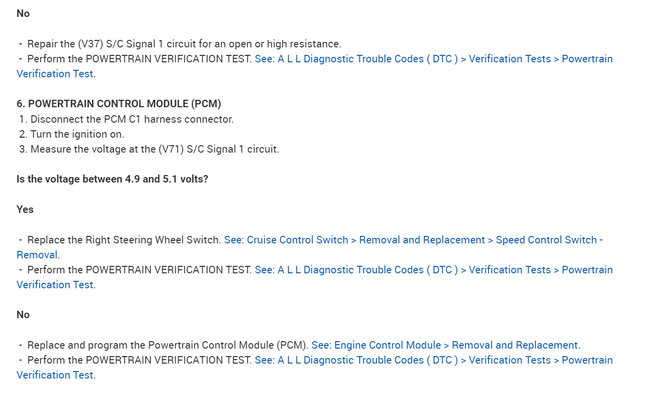

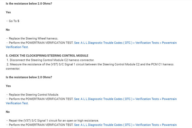

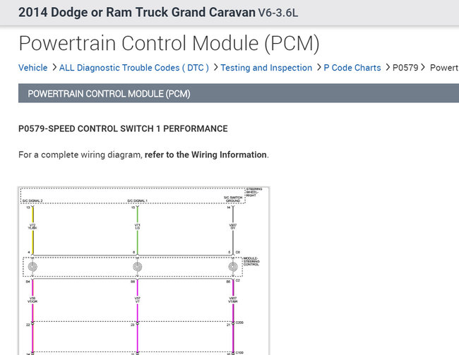

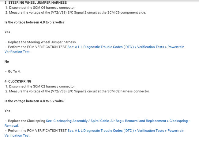

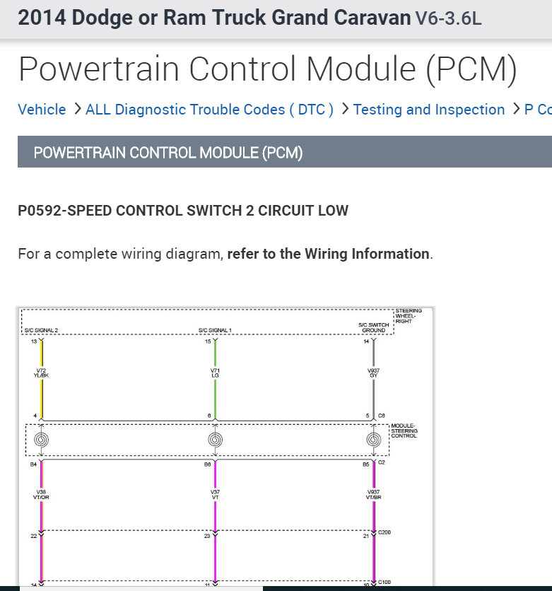

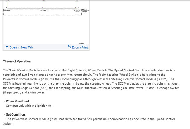

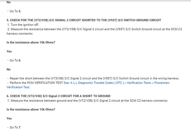

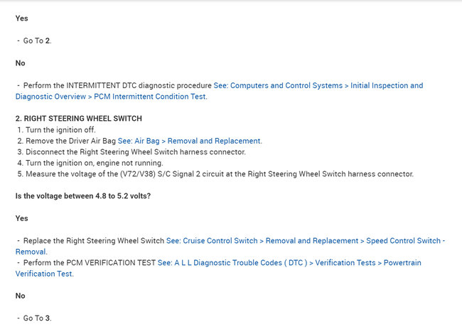

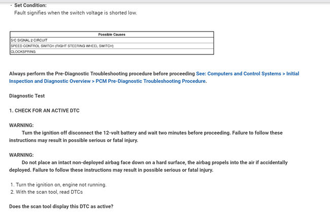

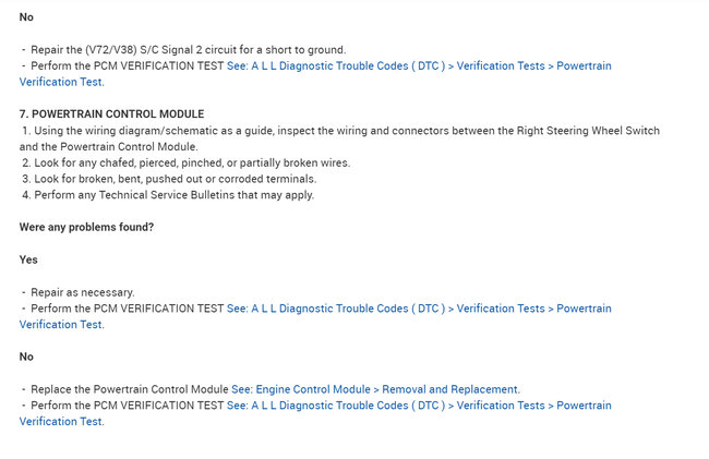

This is a problem with the speed control switch in the right side of the steering wheel. The Speed Control Switch is used to set the vehicle'speed during cruise control. Without this switch working, your vehicle will not have cruise control. In the diagrams down below I have included the troubleshooting flowchart for both DTC P0579 and P0592. DTC P0306 is for a misfire in cylinder #6. Check the coil on plug and spark plug. That should fix the problem. Go through the flowcharts for the first two DTCs and get back to us with what you find out.
This guide can help as well
https://www.2carpros.com/articles/engine-stalls
Check out the diagrams (Below). Please let us know what you find. We are interested to see what it is.
Thanks,
Alex
2CarPros
Mar 21, 2019 at 6:22 AM

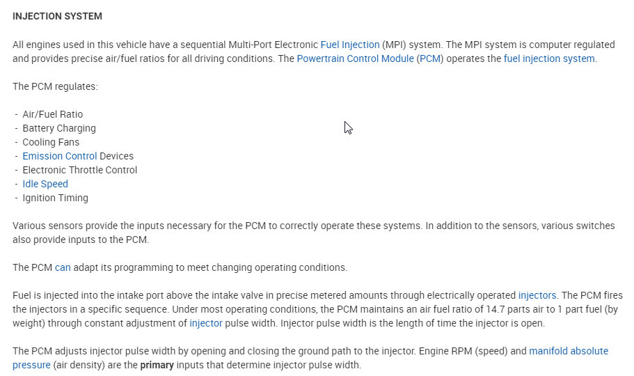

I'm sorry. I didn't realize you had a no start condition too. Okay there are a few different ways that we can attack this problem but this is usually the best way to start out with. I have included a link down below for you to go to.
There are three things that an engine needs to start, spark, fuel, and compression. So what we will do is test each one until we find the problem. Usually we will test in that order, also. So go through the guide listed above and get back to us with what you find out.

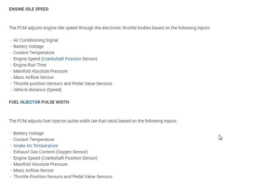

This sounds like the throttle bore is dirty causing the PCM to lose correlation. lets confirm the issue by following this guide:
Sep 21, 2020 at 4:21 AM (Merged)
MIKENBRANDI
When placed in reverse, the engine power is pulled down to the extent of stalling. When put in neutral or park, restarts immediately. Once in a while, the engine will pull down to almost a stall, then idle back up and be fine. Additionally it periodically stalls when rolling to a stop in drive. I've been throwing it in neutral before a stop to avoid the possibility of stalling. Might it be the throttle sensor? Van runs fine otherwise.
This could be a number of things. When you put the vehicle in gear the transmission is adding a load to the engine and if the air/fuel mixture is off then it will not get enough fuel and will stall.
This is usually one of three things. A dirty/faulty idle control valve, faulty o2 sensors, or even restricted injectors.
You engine uses an electronic throttle body to control idle so I would suggest with cleaning that first.
If that doesn't solve the issue then I we need to look at the PCM data with a scan tool and see what the o2 sensors are doing when this happens. I imagine they will tell us that the exhaust is lean which means the injectors are not delivering enough fuel.
Let's start with that and go from there.

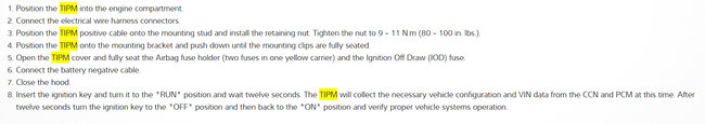

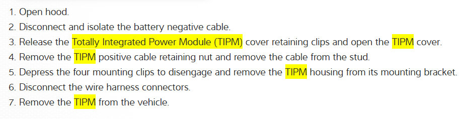

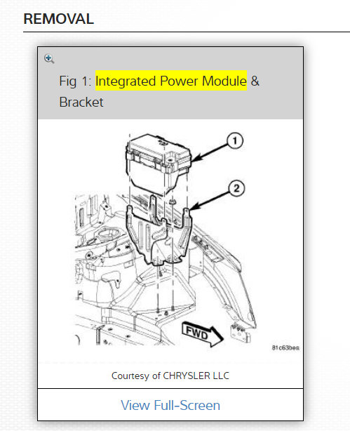

  • 55,694 POSTS
This is a common problem when the TIPM goes out which is easy to replace because it self initializes. Here are the instructions in the diagrams below to help fix the problem. Check out the diagrams (below). Please let us know if you need anything else to get the problem fixed.
