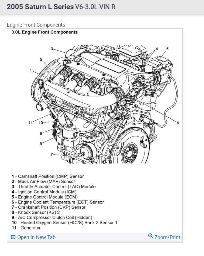

You can do this multiple times but get the same results. Saturn Forum members suggest bad CPS, fault in one of the Sensers at Peddle-or- at Throttle plate. Bad ECM, power train control Module fuse. I do not have a diagram that shows the location of any of these parts. I want to follow a step-by-step process eliminating possible causes one at a time. In what order would you start? The car is on lift, with gas tank dropped to check fuel pump operation but I do not think it's the fuel pump. Something is not keeping the circuit going.

Right off the bat the fuel pressure is low, here are the specs:
Fuel Pressure (Key ON, Engine OFF) .................... 269-338 kPa (39-49 psi)
I would continue with the pump and use an AC Delco unit. Next, I would run the codes and then I would service the throttle bore. Here are two guides to help us fix the problem or at least get closer:

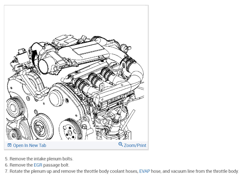

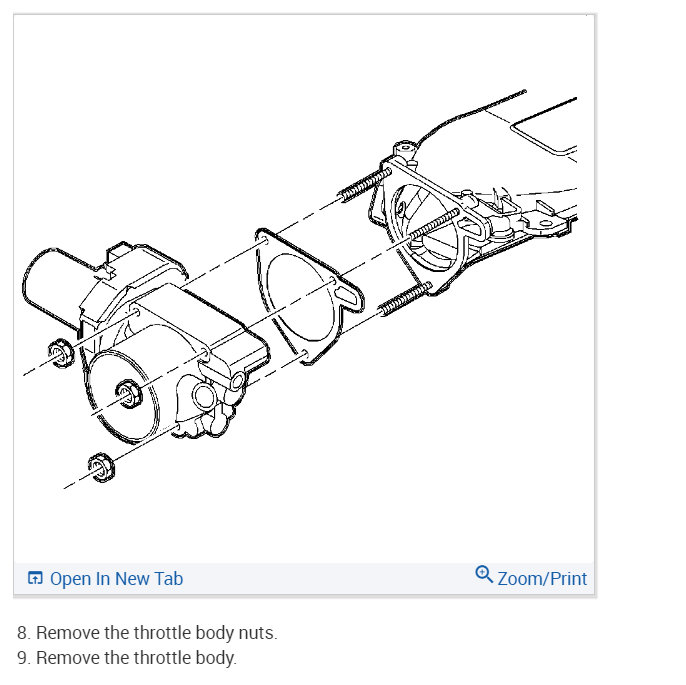

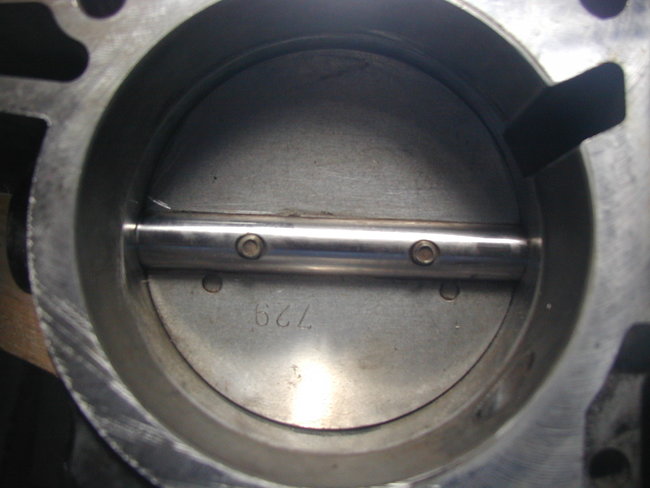

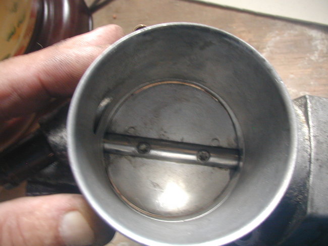

The throttle position sensor codes are the clue, I would replace the throttle bore or see if there are bad connections at the bore, this should solve your problem here are images below to help. Let me know what happens, we are interested in seeing what it is.
Aug 18, 2022 at 7:08 AM
VISTA03WESTY85
  • 17 POSTS
I will replace the Throttle Bore with new as I have no way to test one at a pick and pull. I would guess the next part that can cause this is the Power Control Module.

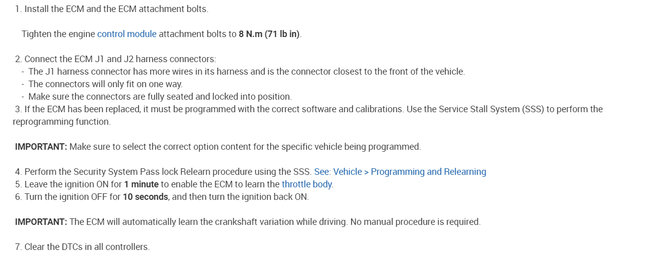

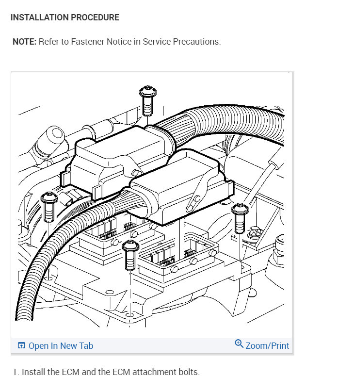

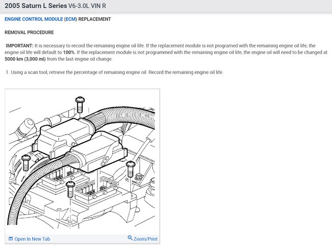

You need to have a CAN scanner; did you check the link above? It is only $30.00 but they have better units. Also, you can get a rebuilt PCM per-programmed if you search google or eBay. Here is the location of the PCM and how to replace it in case you need it.

I am ordering the CAN sensor tool from All-Data recommended by Ryan. I am still towing the car to Chevy. Buying a used PCM on eBay sounds risky. If Chevrolet finds the PCM is shot. I will do this. I went over all the car's faults and history with the Service manager at Chevrolet, and he is going to try to reflash the PCM. As you both agree this may be the issue. If not, I will tow it back to my shop and read the CAN with my new All-Data senser. Either way I will get back to you. I watched Ryan's YouTube Wednesday night live and saw a reference to www.instigram.com/ryans garage. but it would not load? On the air, real time help like this is a great help when you're stuck with a problem. Again, I will let you know what develops after a re-programing and diagnostic by Chevrolet on Thursday. I will look into buying a re-programed PCM on eBay, but I saw used Throttle bodies on eBay yet bought a new one. Because I did not want to take the risk. Bill

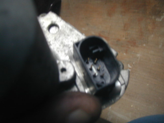

I do not know if you received this. The car came back from Chevrolet running/but with the MAF disconnected. As a novice, I can't see how the car can run without the MAF. Doesn't the MAF tell the PCM the amount of air so that the throttle body can adjust the gas to air ratio accordingly? I will replace the MAF and plug it back in to see if the car still runs. My situation is. Do I buy a middle of the road brand new MAF off Amazon? that is recommended for a Saturn L 300 3.0 for $64-$89.00, or should I get an original Bosh, PBT-GF30 from a salvage yard or Ebay seller for $50.00 if I can find one, chevy price for this part is $293.00 Genuine Bosh for this car of the internet is $149.00. Again, I am awaiting your reply. how best to precede. Glad the car is running, but I'm stumped as to what to do next.
Oct 27, 2022 at 1:14 AM
  • 55,399 POSTS
So, without the sensor plugged in the PCM substitutes a default valve for the sensor input, but if the sensor is plugged in and is telling the PCM there is no air entering the engine the PCM will shut down fuel. I would get the Bosch unit. Let me know how it goes.
